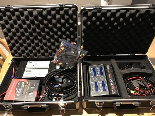

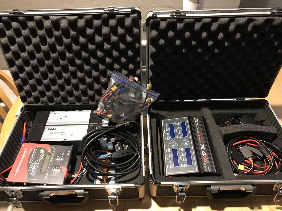

                I use a Hitec and a powerlab 8.
                The Hitec was my first charger and now I just use it for my ednano a123.
                Powerlab 8 is my main charger and it serves me well.
