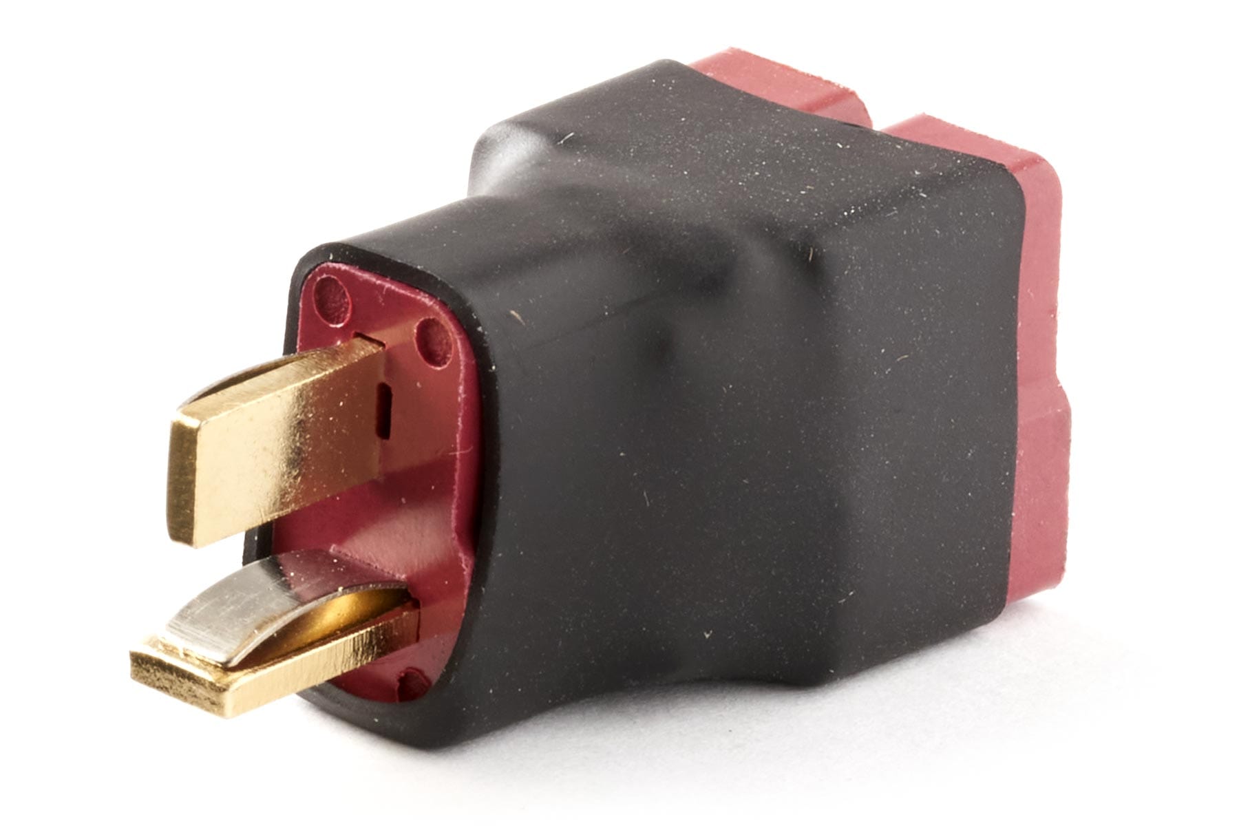

            When paralleling, match the voltage. Note that the capacities can be different and it will work. The wires used for paralleling will balance the pack voltages with each other. (just like parallel charging)
            When putting in series, match the capacity. You can put 2S + 3S + 4S in series and its fine if the capacities match.
            Best to match the C rating in all cases.
            Note that MotionRC sells series adapters for EC5 and parallel for T connector. They DO NOT DO THE SAME THING!
