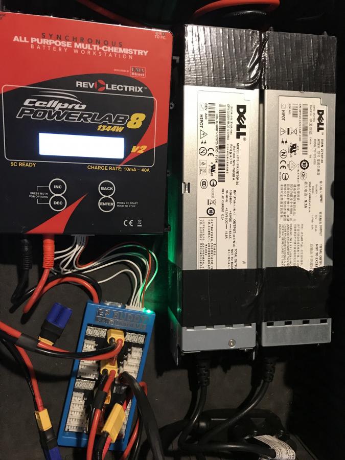

Does anyone have this charger and if so, what does Warning! Supply 50% of DOD. Thanks.
Powerlab 8
I don't have this charger, but i found this on page 45 of the online manual. Took me all of 2 minutes to find it online.
Show Warning at 50% DOD: If checked, PowerLab 8 measures battery voltage when first connected. If the battery is below 50% depth of discharge (below that point, most flooded Lead Acid batteries are damaged), PowerLab 8 beeps and issues a warning. Press the BACK button to cancel the operation on the PowerLab 8, then correct the situation. (You could press the ENTER button to proceed, but this is not recommended.)

Thanks for finding this but all 12 of my 6s batteries can’t be bad lol I just hit enter and charge with no issues.
