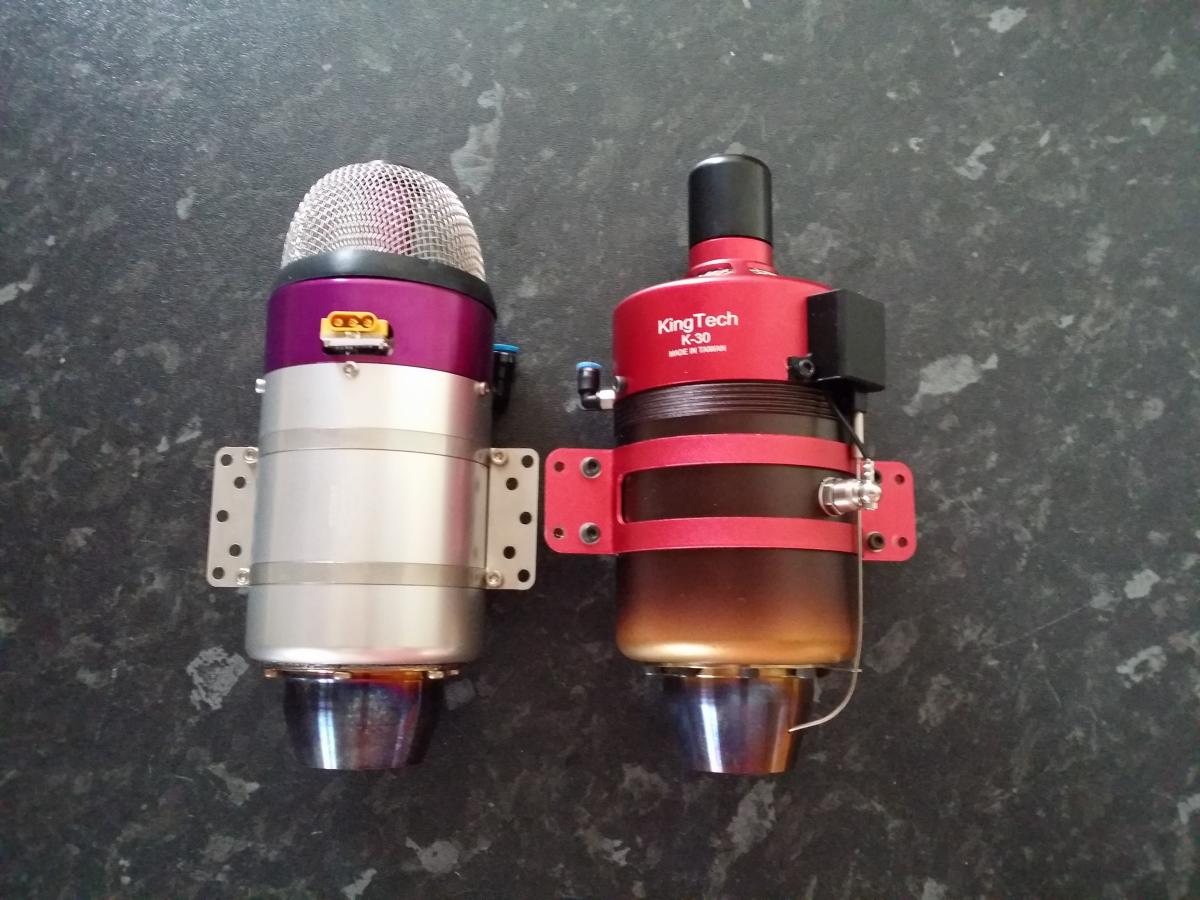

                      I have three Grummania pipes and totally agree with you on your comment! I also make my own pipes using thin SS sheet and a McDonalds Coke cup cut down to a appropriate size. 50mm is the ideal size for a 30-50 Newton size engine and the X45 is now the X48, so now almost 11lbs from this amazing engine!! Some comparison pictures with a K30 and a P20. The X45 is the smallest in the group.

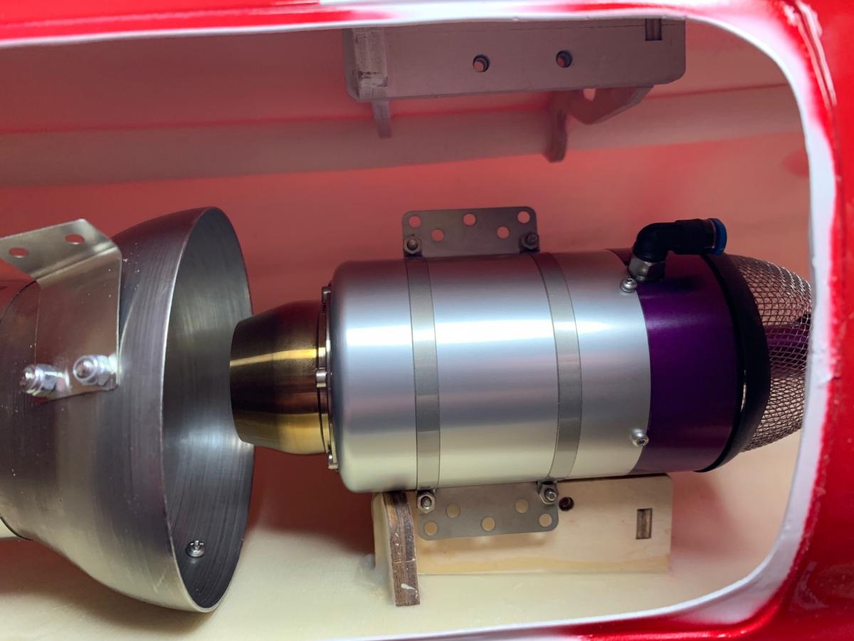

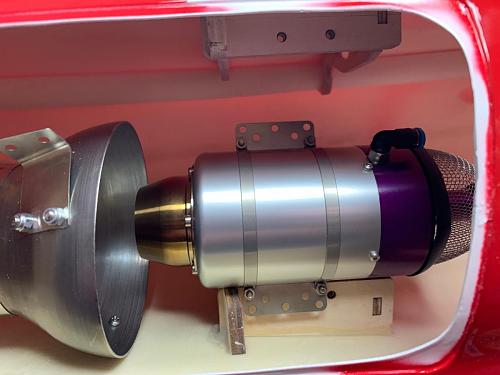

                                        I have a 800 cc tank ( Dubro like ) in my Avanti which took just a little foam being removed.
                                        The L39 is a little trickier - it has a molded 24 oz tank.
                                        Both fly awesome powered by the X45 turbine.
