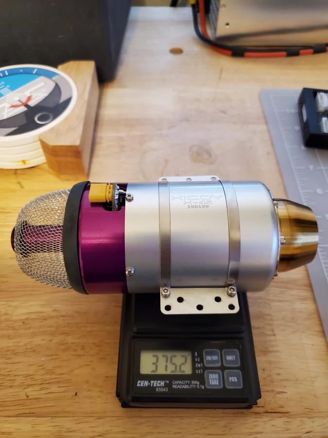

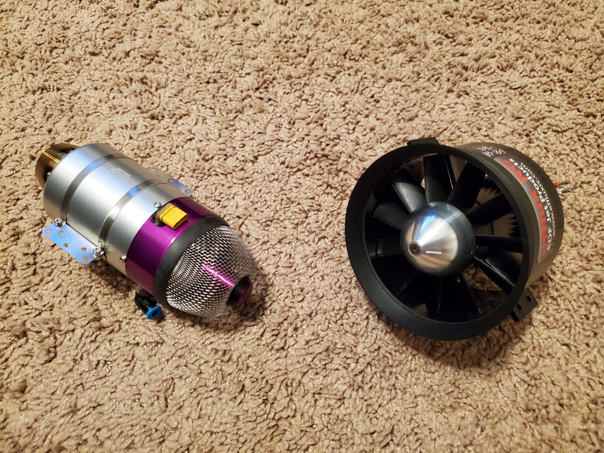

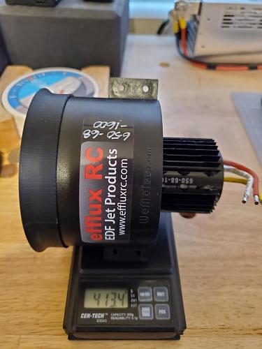

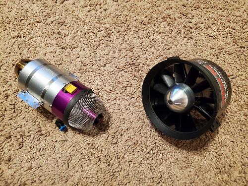

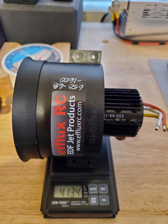

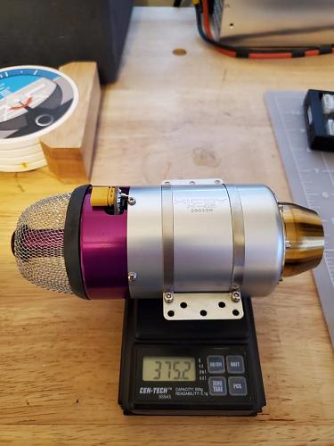

I'm very impressed with the size and weight (and of course, the power) of this Xicoy X45 Turbine. For weight reference, the Wemotec Midifan Evo 90mm EDF power system is considered to be relatively light, yet the X45 turbine still weighs less. If using a heavier metal EDF shroud, larger motor, etc, a 90mm EDF could easily surpass 460+g. The X45 is an amazing piece of engineering by Gaspar at Xicoy. Very well done.

Knowing very little about Turbines, is the overall weight still less when you include the battery and esc with the electric motor vs the fuel and everything else needed for the turbine?Originally posted by T-CAT View PostI'm very impressed with the size and weight (and of course, the power) of this Xicoy X45 Turbine. For weight reference, the Wemotec Midifan Evo 90mm EDF power system is considered to be relatively light, yet the X45 turbine still weighs less. If using a heavier metal EDF shroud, larger motor, etc, a 90mm EDF could easily surpass 460+g. The X45 is an amazing piece of engineering by Gaspar at Xicoy. Very well done.
In most of the Freewing conversions I have done the dry weight is slightly less than the flying weight ( battery included ) of the EDF. The weight of the fuel takes it over on take off and burns off during the flight.
On landing I am back to about the same weight as an EDF. The take off thrust and overall performance is vastly superior to any EDF - in my experience. I have done the T33, L39, F22 and Avanti 80 mm.

It really is mind blowing with it's brushless starter, brushless pump, small telemetry unit, quick start and restart, ability to run various fuel types, good fuel consumption, thrust and acceleration, relatively low residual thrust, and it's small and compact nature. I'd say the primary downside would be sending it overseas for maintenance when the time comes.Originally posted by Alpha View PostThe Xicoy X45 is an impressive bit of kit. I had the opportunity to put one through its paces last summer and it impressed me. Even though I'm primarily a JetCat guy, it's impossible to not find lots to like in the Xicoy. We intend to make good homes for these.

Hi James. Helijet summed it up well.Originally posted by James View Post
It does depend on the airframe your converting from electric to turbine as some don't lend as well to turbine use. For example, some aircraft have a location of the power system too far aft, where it may necessitate weight to be added to the nose of the aircraft to get it to achieve the proper CG when the turbine is installed in the same location the EDF was in (or create a custom mount to shift the turbine forward). Adding nose weight to account for an aft power plant position wouldn't be an ideal scenario and conversion. You will tend to see quite a bit of turbine aircraft have its engine located further forward than its EDF counterpart, although it does depend on the aircraft. You will also notice the turbine sit relatively close to the fuel tank, and it often does not require as large of intake area as electric, so some chose to close off the cheater hole if the aircraft had one for electric use.
The fuel tank essentially sits on the CG, and the aircraft is often balanced with the Air Trap full of fuel, all necessary operational equipment on board, and an empty main fuel tank. With a careful selection of the conversion aircraft, the turbine and parts choice, etc., a turbine aircraft can either match or potentially weigh less than its electric counterpart when weighed without fuel in the main tank. At takeoff, you may find the turbine at a heavier weight than the electric jet, but as the fuel is being consumed you're losing weight, which may have you land the aircraft at a weight that either matches or is less than the electric jet.
An interesting aspect about turbines is the consistent performance across the board, whereas electric can experience slowly degrading performance over the flight as the flight battery voltage drops. With the turbine, the aircrafts performance improves as the weight drops during fuel burn. There are times where turbine powered flight duration is improved over electric, all while improving performance.
I used to think thrust was thrust, regardless of how it were achieved, such as EDF vs. turbine. However, seeing a turbine and EDF with the same potential thrust output, the turbine seems to edge out electric in performance. For that matter, oddly enough, even some lower thrust output turbines installed in an aircraft that usually flies on an EDF at a bit higher thrust may sometimes still perform superior or match it. One recent video posted by Henke, who converts many electric to turbine aircraft, flew the Freewing T-33 on a very small and light Kolibri 1.5kg thrust turbine. The performance is spectacular for such low thrust, and it is hard to imagine 1.5kg thrust pushing the T-33 around like it does. I don't believe putting in a 1.5kg thrust EDF would have been nearly as impressive.
Thanks Elbee. There is additional equipment required when using turbines. It also depends on whether it is a PNP aircraft like these Freewing jets vs. an aircraft you're putting all your own equipment in (such as HV servos, etc.). It is usually not a drop-in fit when doing a conversion, and requires additional modifications. This X45 will be going into a Fiberglass/Balsa Sebart Mini Avanti, so I haven't converted any foam aircraft with the turbine yet. Many friends at the field have with great success. Hopefully Helijet and others (Henke) can chime in on the conversions and what they specifically chose.
Some additional equipment needed, but not limited to, includes a fuel tank, appropriate turbine pipe, fuel line (my turbine didn't come with any), air trap, wheel brakes (an AMA turbine use rule), turbine battery, receiver battery and potentially a BEC if needed, telemetry unit if preferred, appropriate fire extinguisher, fueling canister/station, taxi fuel tank if preferred, approved turbine oil for your specific turbine, and additional support equipment and accessories.
Thankfully, once the initial purchase of the support equipment and some accessories has been done, then it is a little more smooth sailing from there since you have it. There is also the turbine waiver process done prior to operating a RC turbine aircraft, which can be researched on their website.
