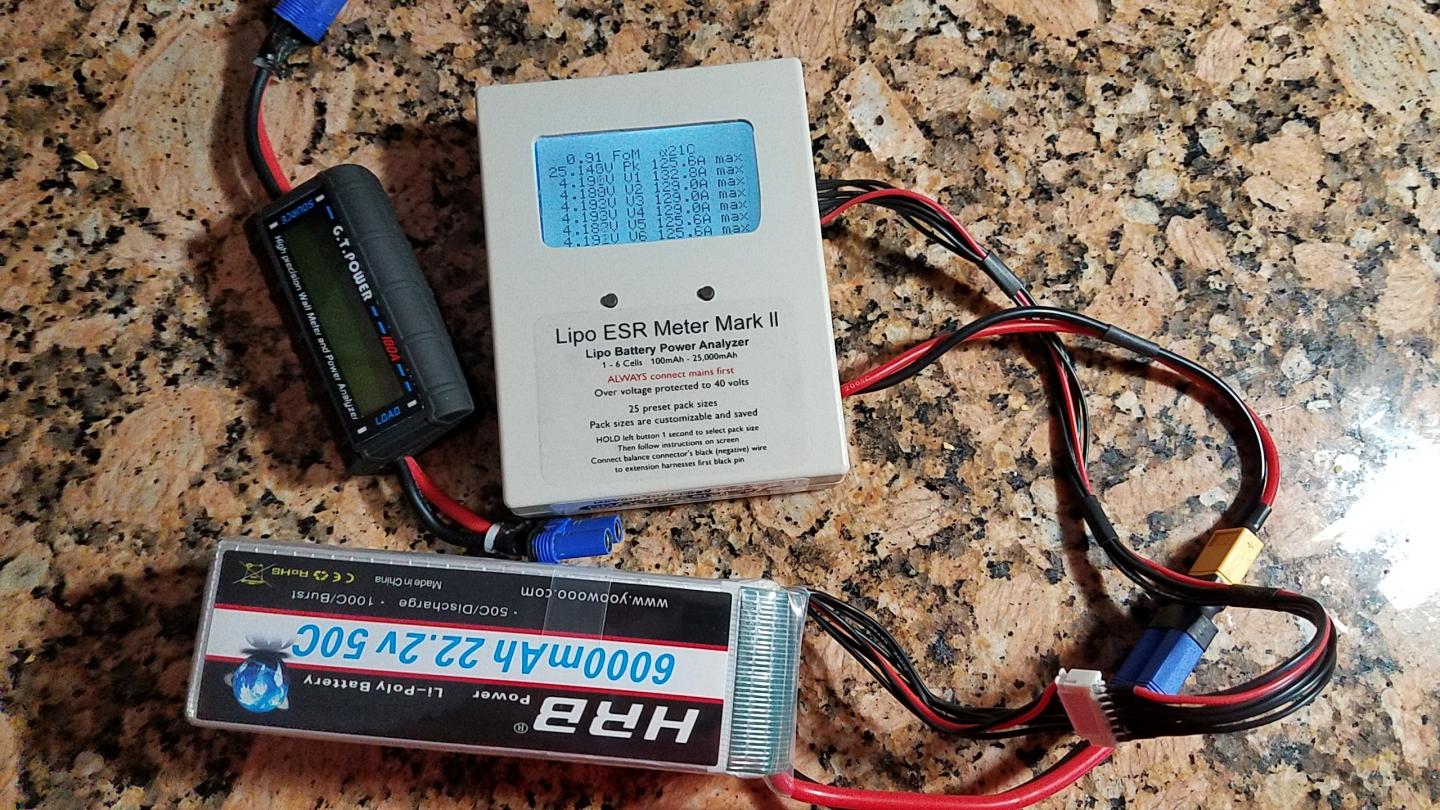

    The JUDGES:
    1) For actual C results, the Progressive IR meter. Please note that the resulting C from the meter, according to the maker, is VERY conservative and he even adds a factor of 1.5 to get the most "likely" C. All batteries tested were fully charged (makes a difference), had been recycled enough times to reach optimum performance and tested at 72 degrees (actually the most important factor in consistently calculating IR and actual C). 2) The GT Power meter to register Ah and Watts drawn under load, hooked up to a fully charged battery (actually used several of the "best" C tested ones from each group) and bench tested on each fan by evenly increasing the throttle from 0 to full, holding it for 8 seconds, then dropping it back to 0 and reading the results. The power draws on a free flying jet will actually be lower than on held on the bench due to air being forced into the fan from flight, vs having to suck "dead" air on the bench.

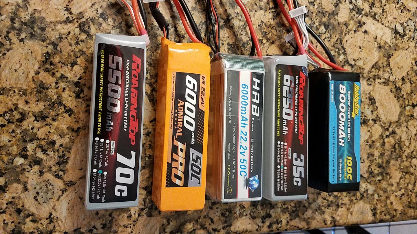

    The CONTENSTANTS:
    1) 8-Roaring Top 5500 70C: cost $120, weight 825 g, Actual C 22C, likely C: 33
    2) 12-Admiral 6000 50C Pro: cost $124, weight 827 g, Actual C 17C, likely C: 25
    3) 4-HRB 6000 50C-100C burst: cost $84, weight 830 g, Actual C 22C, likely C: 33
    4) 14-Roaring Top 6250 35C: cost $93, weight 790 g, Actual C 18C, likely C: 27
    5) 6-HobbyStar 8000 100C, cost $179, weight 908 g, Actual C: 18C, likely C: 27 (man I'm seriously broke now after these)
    Apparently, calculating actual C is a tricky business and even with this meter based on 3 guys extensive research, it can't determine the exact C, however, it can tell which batteries have a lower IR (and higher C) versus others, the actual mAh in each cell and the IR in each cell is shown, alerting me to a potential "bad" battery or one that may be ready to "kick the bucket".
    On to actually testing each with EDF's in next post. TBC

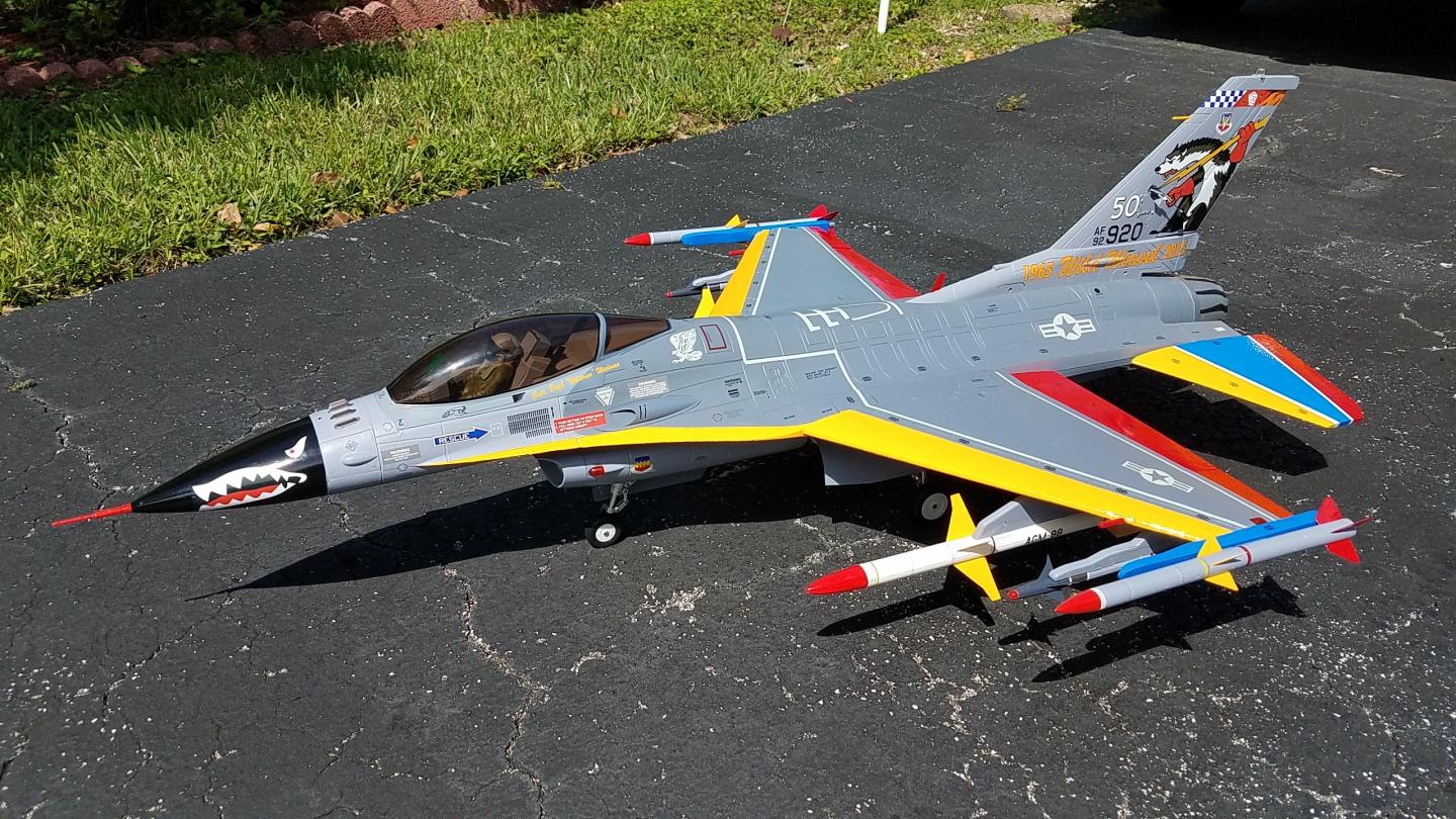

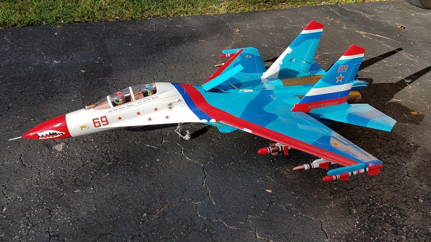

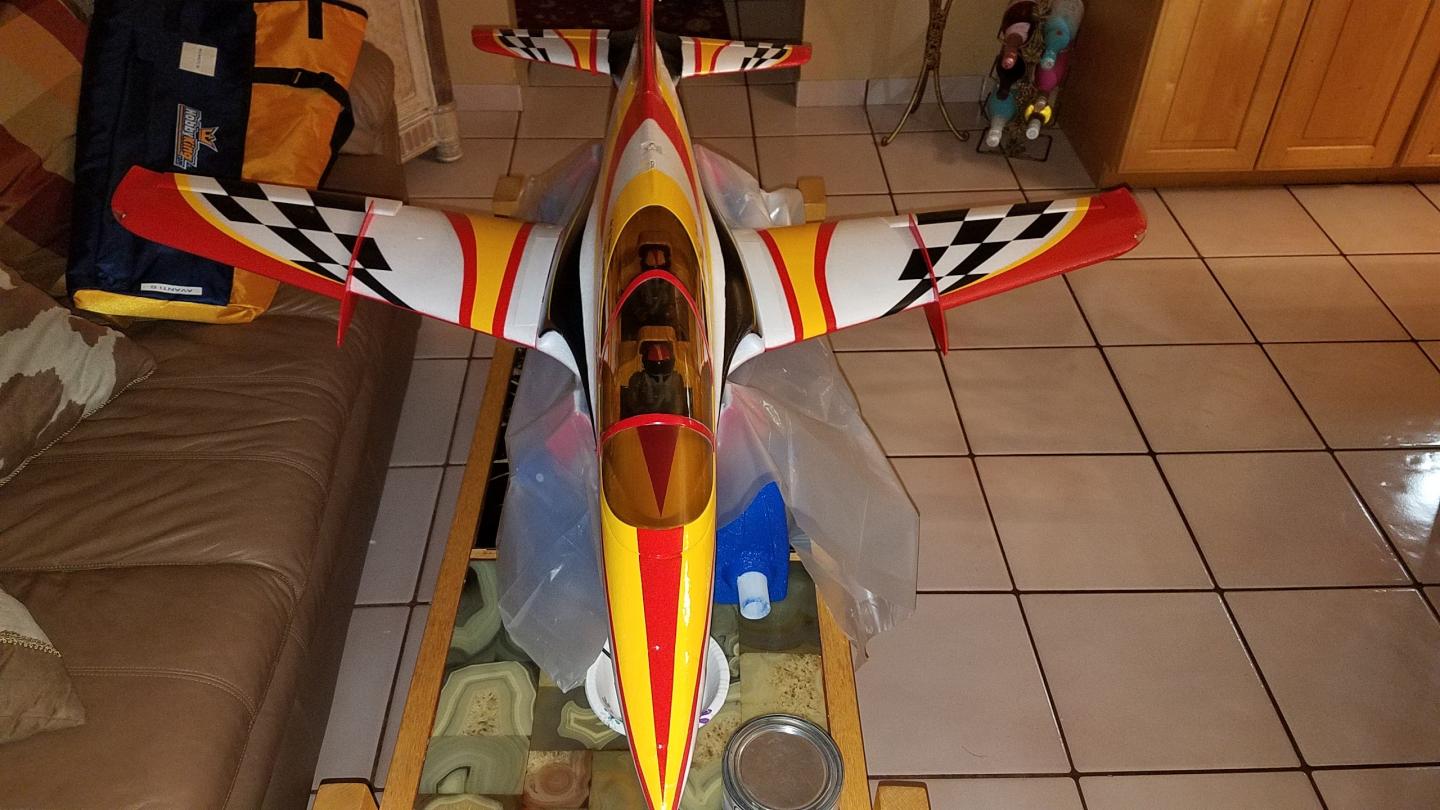

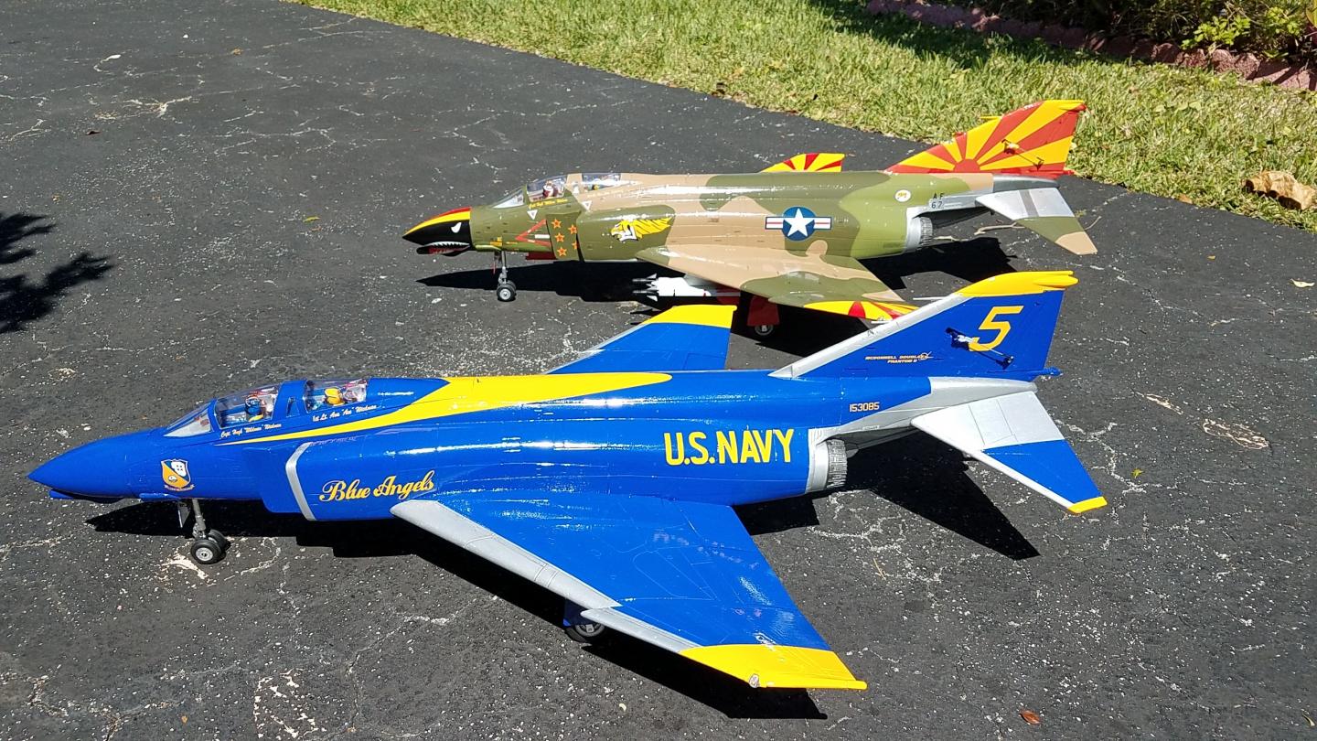

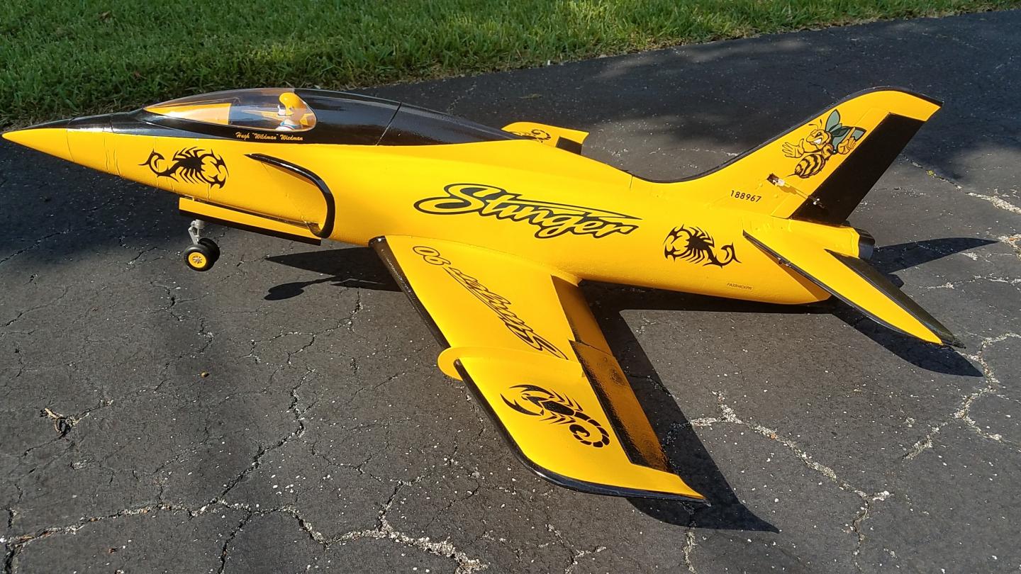

      So the true test is in the real world on an EDF. I'm certainly no EDF master and have a long way to go to even be proficient, but here are the results on several outrunners (4) and inrunners (3). The somewhat odd result as that with the outrunners I have, a higher C battery only gave marginally better performance (2-3%), but in my inrunners, the difference was more noticeable (by 7-9%), so I rightly or wrongly concluded that a higher C battery needs to be in my inrunners for optimum performance. If anyone out there can explain that, I'd appreciate it or maybe it's just a coincidence.
      1) 9 Blade 80mm 3658-1856 Kv inrunner (stock in the red Avanti-but now a different fan comes with both)
      -AD 6000: 96.6 Ah 2135 Watts
      -RT 6250: 100.6 Ah 2424 Watts
      -RT 5500: 103.0 Ah 2450 Watts
      -HRB 6000: 103.0 Ah 2440 Watts
      2) 12 Blade 90mm 3748-1650 Kv outrunner (Stinger 90)
      -AD 6000: 102.6 Ah 2266 Watts
      -RT 6250: 108.5 Ah 2473 Watts
      -RT 5500: 109.6 Ah 2520 Watts
      -HRB 6000: 108.5 Ah 2490 Watts

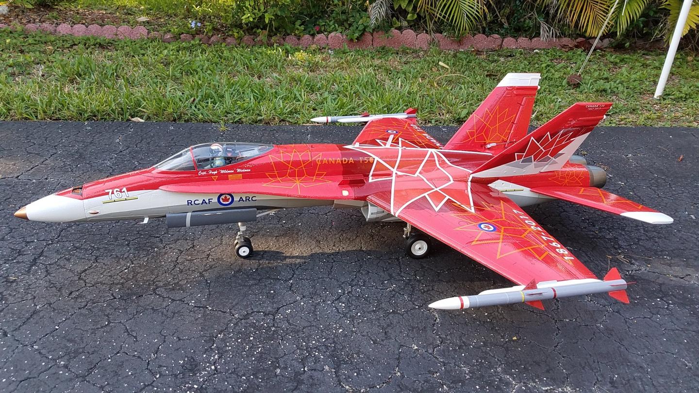

      3) 9 Blade 90mm 3748-1750 Kv outrunner (in 2 F-4's and F-18 Each was slightly different, but very close so only listing 1 result)
      -AD 6000: 113.5 Ah 2552 Watts
      -RT 6250: 120.0 Ah 2835 Watts
      -RT 5500: 121.9 Ah 2877 Watts
      -HRB 6000: 119.8 Ah 2860 Watts
      4) 12 Blade 90mm 4068-1835 Kv inrunner (upgraded fan in the F-16)
      -AD 6000: 110.2 Ah 2446 Watts
      -RT 6250: 113.7 Ah 2594 Watts
      -RT 5500: 117.1 Ah 2810 Watts
      -HRB 6000: 115.6 Ah 2750 Watts
      -HS 8000: 115.7 Ah 2740 Watts
      5) Twin 12 Blade 70mm 1850 Kv inrunners (SU-30)
      -AD 6000: 117.2 Ah 2600 Watts
      -RT 6250: 118.8 Ah 2650 Watts
      -RT 5500: 120.7 Ah 2825 Watts
      -HRB 6000: 121.4 Ah 2870 Watts
      -HS 8000: 119.3 Ah 2800 Watts
      There are some minor anomalies in the exact numbers of the test results, but overall, this has given me a better "feel" for the battery to use in each jet/fan (of the ones I have only).
      CONCLUSIONS:
      Although this may look like a "scientific" study, there is plenty of room for error, however, I could actually feel and hear the difference in each jet when comparing different brands. In actual use, that difference was mainly in how quickly it got off of grass and with flight time, but not so much in the actual "once in the air" flying. For all my outrunners and the Avanti inrunner (you can put a brick in that thing and it will fly great) I now exclusively use the RT 6250 35C. It has a decent price of $92 and good capacity with it being the lightest of the 5, although the HRB 6000 will do just as well. For the inrunners in my F-16 and SU-30 (where take-off thrust is the most important for me of the jets I have), I am no longer using the RT 5500 70C (it's a great battery, but not enough flight time so they're being mothballed) and instead I am using either the HRB 6000 (with virtually the same punch) at a cost of $84 each, or when I crave more flight time, the HS 8000, but at $179 a shot it sure puts a premium on the extra minute or more and sure put a huge dent in the wallet. Phantom suggested this battery since it fit without modifying the battery compartment and I thank him for that, cause it just barely fits in the F-16 (but if it puffs by 1mm it's back to the drawing board) and it fits nicely in the SU-30, but the extra 80 g in weight is another issue for take-off. And I think Warthog just bought 8 of these, in exchange for his loving wife (I may be in the same boat soon), and is putting 2 of them in his A-10 for something like 3 hours of flying.
      The Admirals IMO need to catch up a bit with cost, weight and power. Don't get me wrong, I love Admiral batteries, they are war horses, with over 60 of them in my possession, none have ever failed of puffed (can't say that for E-Flight, Thrust, Venom and some others) and I use them exclusively in all my prop planes (4S-6S 4000 mah to 5000 mah) and they all perform great. I'm just not using the twelve 6000's (for sale cheap along with the RT 5500's) I have in my EDF's anymore.
      One last thought (if this wasn't long and boring enough), of the 4 HRB's I purchased, 3 were very good but 1 (even after recycling several times) was down 30% in C and mAh in each cell (although all 6 cells were consistent) and the IR in each cell (again, all 6 consistent) was 30% higher. I immediately notified Amazon, they sent me a new 1 next day air and I sent back the "bad one". Don't know if that's a regularly occurring problem or if I just got the lucky one, but I can say that the IR meter saved me from having to turn it into an anchor.
      Please, anyone going through this let me know what experiences you have and don't be afraid to tell me that I'm full of , which is the normal response from anyone when I open my big mouth!

                  Got the meter at Progressive RC.com, cost $149. I'm not all that convinced it's worth it though. It definitely tells me which individual batteries and brands have the lowest IR per cell and the best FoM (Figure of Merit-the calculation of internal resistance times gate charge, the lower, the higher discharge C- but don't ask me to explain it any further cause my pea size brain just couldn't-I'd have an easier time explaining how anti-matter works on the starship Enterprise). It can also tell me if an individual cell is bad and in the case of one of the new HRB's, I could see it was 30% below in everything from all the other HRB's so I got it replaced for free. The best "meter" is still what Evan D does, use it in flight and see how you like it.
                  I did test the HS 8000 on flight times and although it is no where near a 100C, it still has comparable power to the HRB 6000 50C and the RT 5500 70C, yet added a minimum of 1-1 1/2 minutes of flight time on the SU-30 and F-16. That in itself was worth it for me (even at the cost of having my wife cancel my credit card).
                  The most useful tool for me was the GT Power meter I bought from Motion and tested each battery with a specific fan. Those results IMO are well worth the cost of the meter at something like $25.
                  So don't waste your money on test equipment or a ton of batteries like I did, allocate it towards another FW/FL model (man, I wish I had done that instead of buying all these batteries and meters, I'd be in RC heaven right now).
