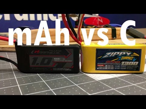

                  Here's an interesting recent video that relates to what we've been posting about.

                    #29
                    I know Nic personally and that field he flies at in the video is where I fly all the time. We have discussed this very subject and he is only doing one part of the argument. If the Graphene weighs 29g more than the other pack in question then you add in more capacity to equal the weight of the heavier pack but still keeping the lower C. Things changes when you do that. You get more discharge rate when you increase capacity without increasing the C rating.

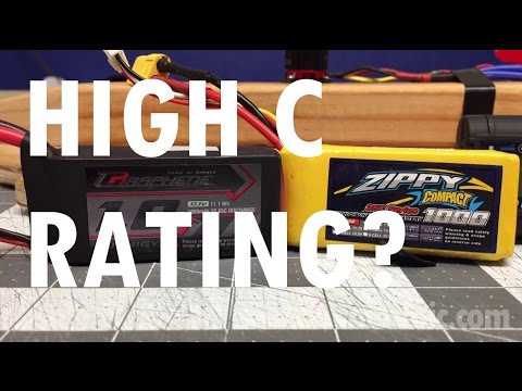

                      #30

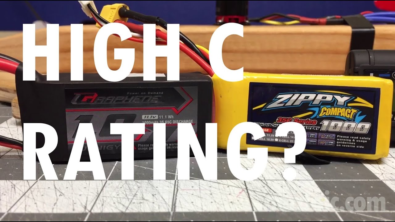

                      This is the video that fits with what I am saying.

                        That is, in theory, correct, since discharge rate (Amperes) is supposed to be equal to the Ah rating times the C rating. If C ratings were trustworthy, that is. Because it is now more an advertising gimmick than a useful measurement, it's up to users to find out what a battery can actually provide. As a general guide, though, within the same brand a higher capacity will usually sag less or provide a higher discharge current, if the C rating is the same.

                          #32
                          This video and the one before it, only re-affirms to me that I will continue to buy the highest C rated battery I can justifiably afford. I will even go so far to say that after this second video, I will concentrate my future purchases on 65C Graphenes (and Admirals and Turnigy Blue Heavy Duty when the other is not available). The only variable that has yet to be tested is longevity and these things have not been out long enough for people to see just how many duty cycles they will be good for.

                                  Logic should also tell you that a 1000mah pack with that high of a C will exhaust itself sooner too. So you can look at it from one angle or see the big picture. I look at it as a whole and will stick to capacity instead of C since one is easier to gauge than the other.
                                  Graphene packs are very promising and the Gens Ace packs that came before them were as well. But if you can get good performance and not spend the money why would you?

                                    #37
                                    Oh and that video also proves that the Higher C pack of the same capacity will draw more amps as I said before.

                                        #39
                                        And the reason that happens is because there is not as much of a voltage sag(drop) with the higher C. You can not get the desired amperage with reduced voltage which is controlled by the IR and other factors of the battery chemistry that play into the math/science of Ohm's Law. The bottom line to all this great discourse over these 4 pages is the answer to the OP's questions and that is still a NO. As Wintrsol said in an earlier post(I'll paraphrase), you can't force amperage down the motors gullet.
                                        Being the science guy, I actually learned two things throughout these writings. The biggest surprise was the amount of voltage drop that a lower C rated battery had under load and the not so big surprise is the untruthful marketing by the manufactures of the battery C rating. Until that marketing misinformation changes and based upon the two new revelations I gleened from this most excellent thread is that 25-35 C will get the job done for the majority of my prop warbirds but a 40C is a slim low end margin for getting what I want from my two EDF's.
