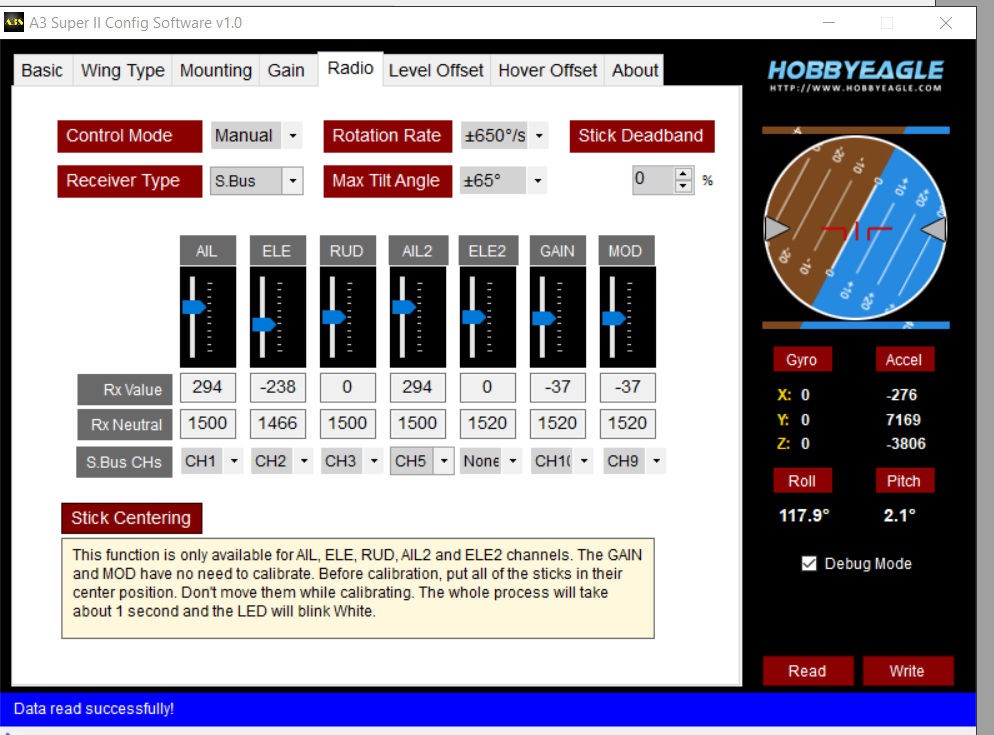

    I changed the receiver for a 6 channels, and I had to use SBus to connect to the A3, for which I used channels 9 and 10.
    Initially, I had a wrong setting with the SBus channels and the Aileron was actually changing the mode. However after I reconfigured receiver and A3 to correct channels, the Mode (Don't know about the Gain) does not work.

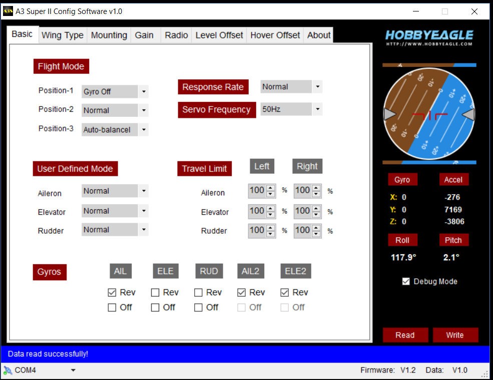

    Here is what I cannot understand, and where I think I am missing some config setting. When I connect the A3 to the PC, I can see, in the Radio Tab, that Gain and Mode change as expected, however, the A3 blue LED stays on at all times. Therefore, I am sure the A3 is getting the Mode signal, given that it shows changes in the PC, but is not acting upon it. What is wrong in my config? I restarted radio and A3, I disconnected the A3 from the PC, restarted the radio, but still nothing changes.
