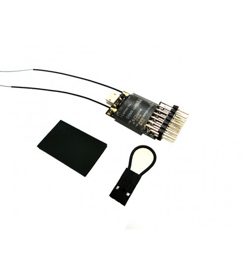

                      These RXs with only the diversity antenna "should" work as is, but ............................... I don't know if this is a valid observation that can be applied to all such RXs with the diversity wires. On one of Lemon RXs with only the diversity antennas where the plane crashed due to loss of signal, I took apart the RX casing and found that the solder at the end of each wire was very minimal and one of then had let go. I wasn't skilled enough to solder it back so I threw it away. For sure, it doesn't work well with only one wire soldered.
                      • davecee
                        • 179
                        • Nashville, NC
                        I took apart the RX casing and found that the solder at the end of each wire was very minimal and one of then had let go..
                        AFAIK

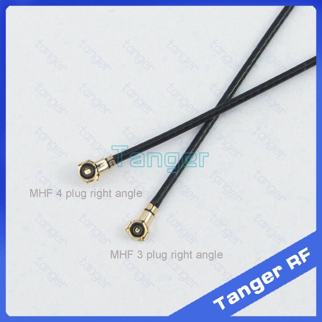

                        If your Lemon receiver had two antennae soldered to the board it was not a "diversity antenna" receiver. The Lemon "diversity antenna" receivers use an IPX-3 connector at the board.Click image for larger version  Name:	diversity YES.jpg Views:	1 Size:	21.0 KB ID:	124181
                          • 8835
                          Mine looked like that but instead of those little caps, mine were soldered.

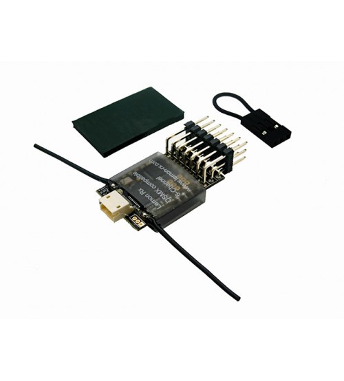

                            I've only seen the two soldered antennae on this one, which is not a diversity antenna model.Click image for larger version
                              • 8835
                              You may be right. They all look the same to me. That one had a sat antenna but when one of those small wires came unsoldered, the range was very poor - like the range test was sketchy.
