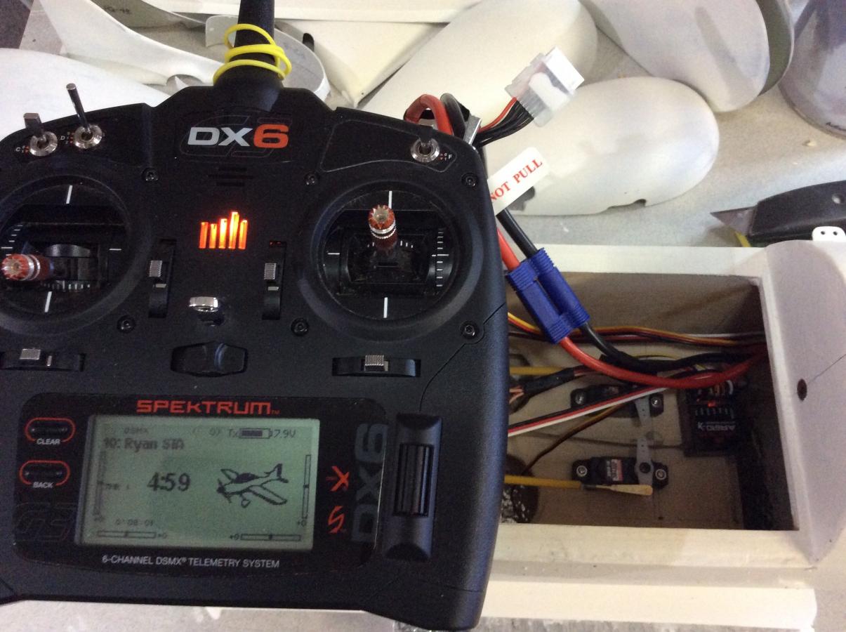

ID:	182212 Hmmm, I put the RX 610 in the Ryan that I have nearly ready to maiden...
                          may have to elect a production change order prior to the flight.
