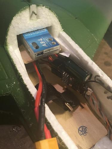

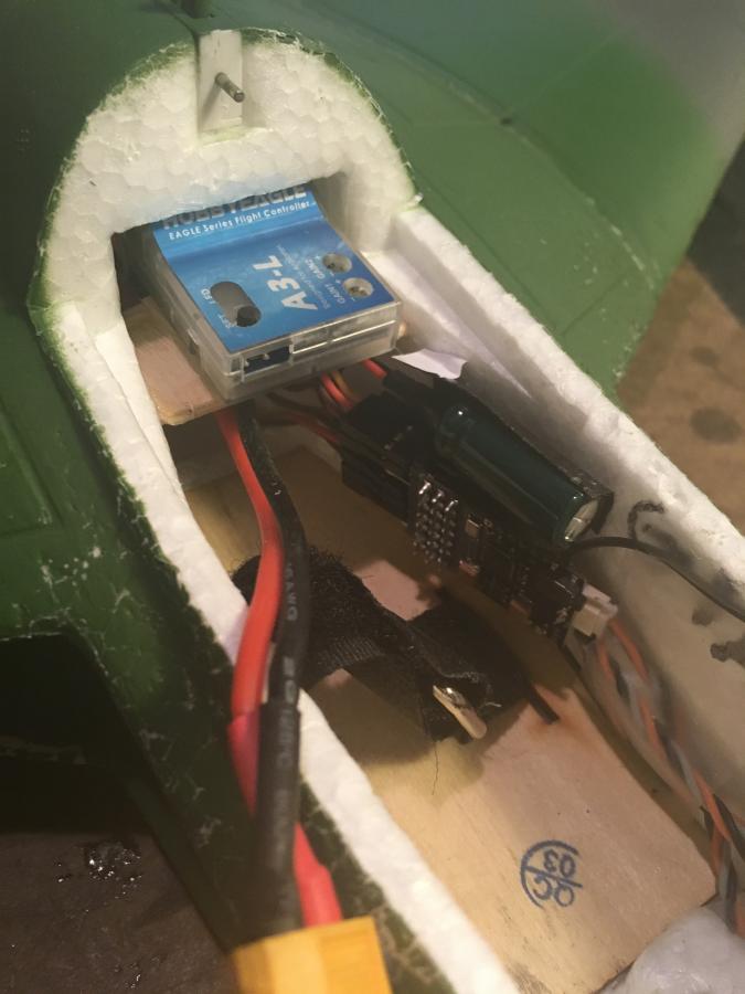

              No, you cannot link the servos on an elevon plane. Each servo MUST go into their own separate ports. With the P15, that's going to be the AIL and ELE port, with the TX set to "elevon". Here's my RX in my Lippy. My RX is a Lemon 6-ch and I built a wooden shelf to mount my HobbyEagle gyro. For you, your RX (with gyro) can be mounted on a shelf like mine. The battery slides all the way back under that shelf. I would suggest (but it's up to you) that you program in about 3 degrees of "reflex" on the gear switch so that launching it will be easier. Even at full power, this plane can drop a bit after the toss. A bit of "UP" elevator will reduce that tendency. Once it's up and climbing well, switch off the reflex and throttle down.

                I've thought about doing the shelf like yours, or velcroing it the battery.
                  • 8835
                  The back end of that shelf is a "V" shape. Just cut the wood to a relative shape and hotglue it in there.
