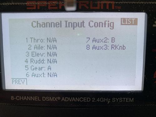

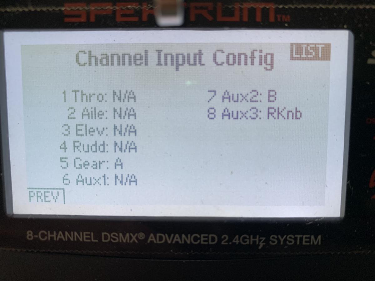

          Here is a picture of the second page of my Channel Assign. Note that AUX2 is assigned to switch B. That's where the retracts are plugged into my Lemon Rx on my Yak 130.

            Yes, mine just looks like that however every channel is N/A , cannot assign a switch.

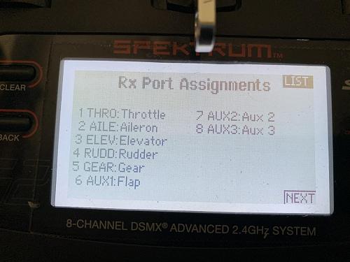

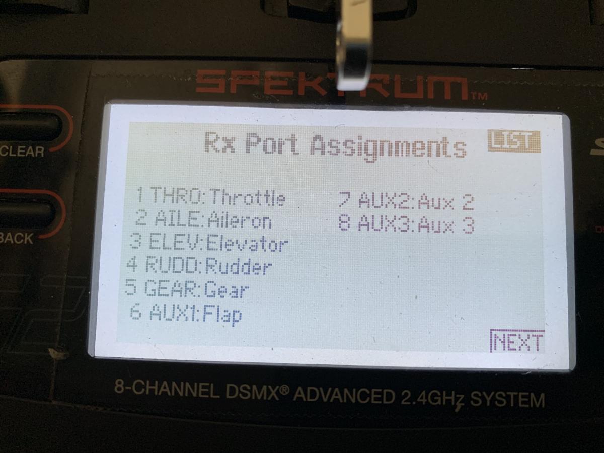

                Well, that's weird. Maybe it depends on what you've chosen for "aircraft type". Mine is wing - "1 AIL, 1 flap"; tail - normal. Here's a picture of the first page of "channel Assing", port assignment:

                  That's it. You used up all your ports. Ailerons and flaps should be "Y'd".
