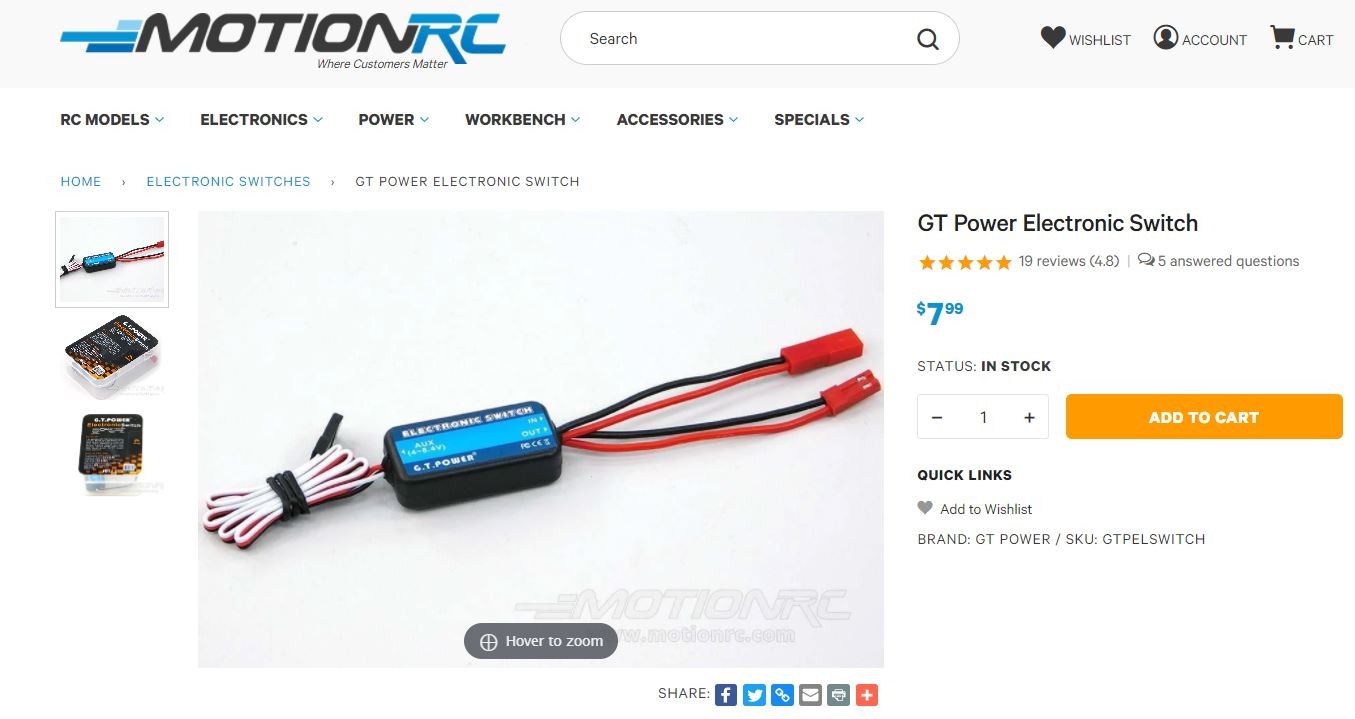

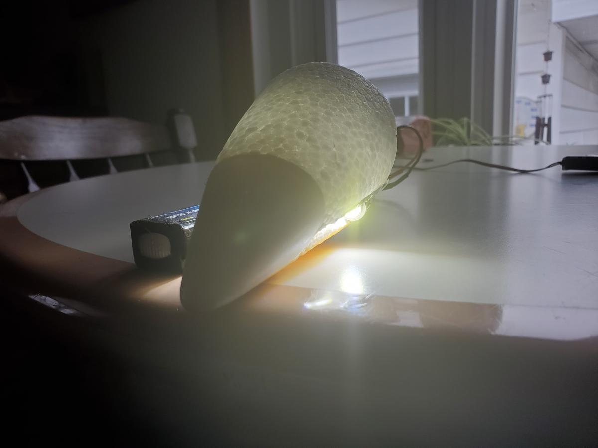

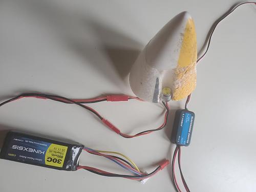

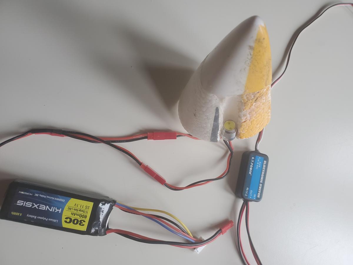

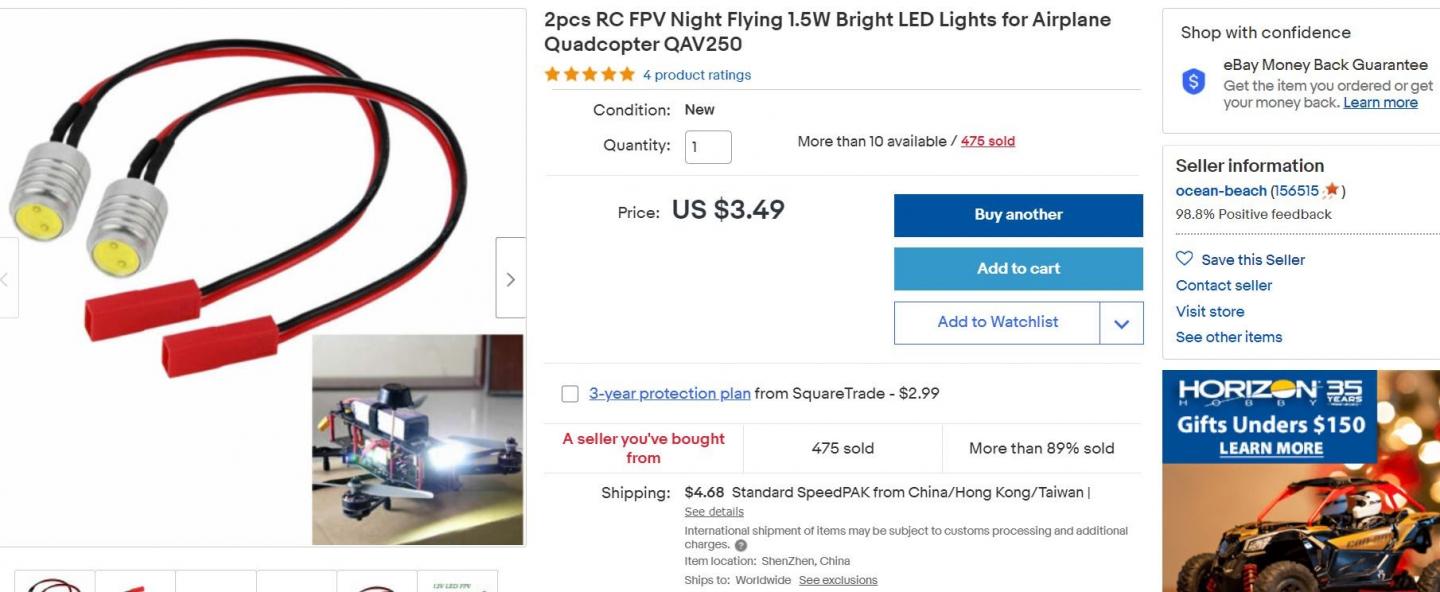

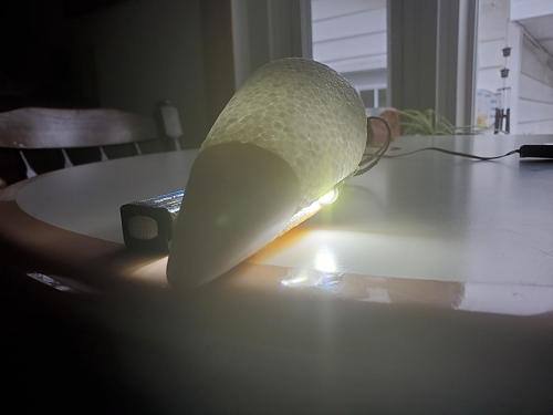

            Yes, I did install a set of landing lights in the nosecone of my Avanti. It turned out pretty good, I cut a groove on both sides of the nosecone and then glued in some plastic tubing that I cut at an angle lengthwise. I then glued the lights into the tube. I mixed in a relay with the landing gear channel so they were turned on and off depending on the landing gear being up or down. Below are all of the components I used. The lights from Ebay actually came from China and are still available but the time to get here is a unknown these days but they only took about 3 weeks when I ordered them. Unfortunately that Avanti is no more and haven't reinstalled it in the new Avanti yet so I don't have any pics of it in flight.
