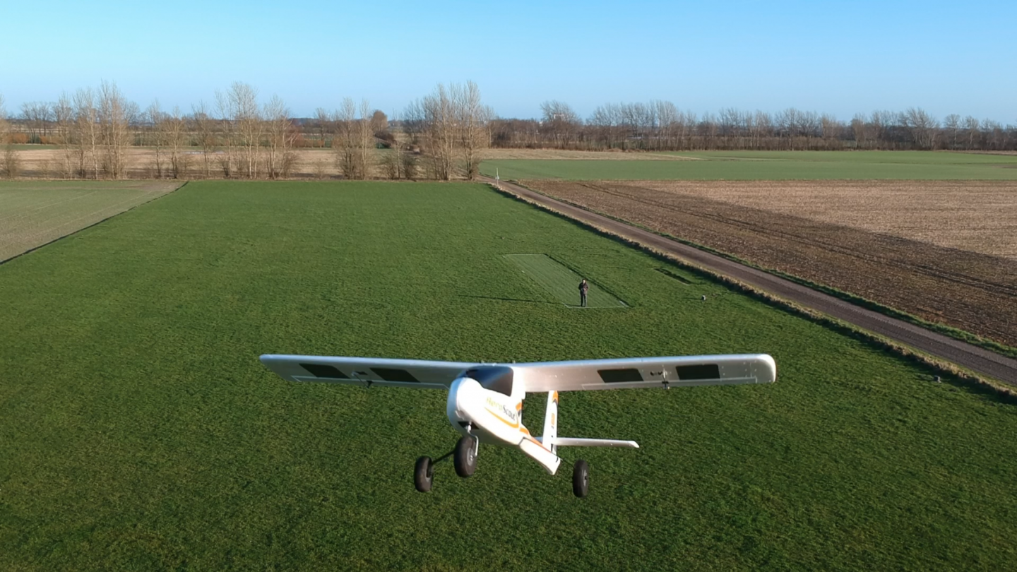

                  Hi. Maiden today and it went fine:)
Name:	Aeroscout maiden.png
                    • 8814
                    How did you get that picture?
                    • Nikom
                      • Nov 2019
                      • 163
                      • Denmark Odense
                      Dji Spark hovering:)
                        • 8814
                        Just curious. It looked like you were all alone out there. The shot looked so perfect, it almost looked photo-shopped.
                        • Nikom
                          • Nov 2019
                          • 163
                          • Denmark Odense
                          Yea, was lucky i guess:) Your right, it looks like some editing in PS. The secret behind the "lucky" shot is i was in video mode with the drone and then later at home i took a screenshot of the video
                          right where the plane passes the drone:)
                          And yes, was alone out there today:)
