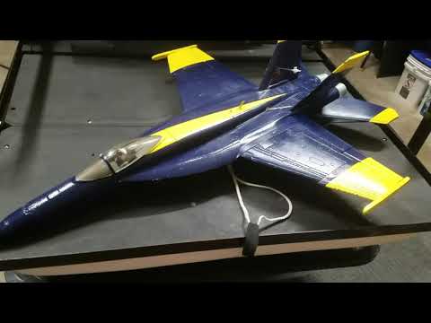

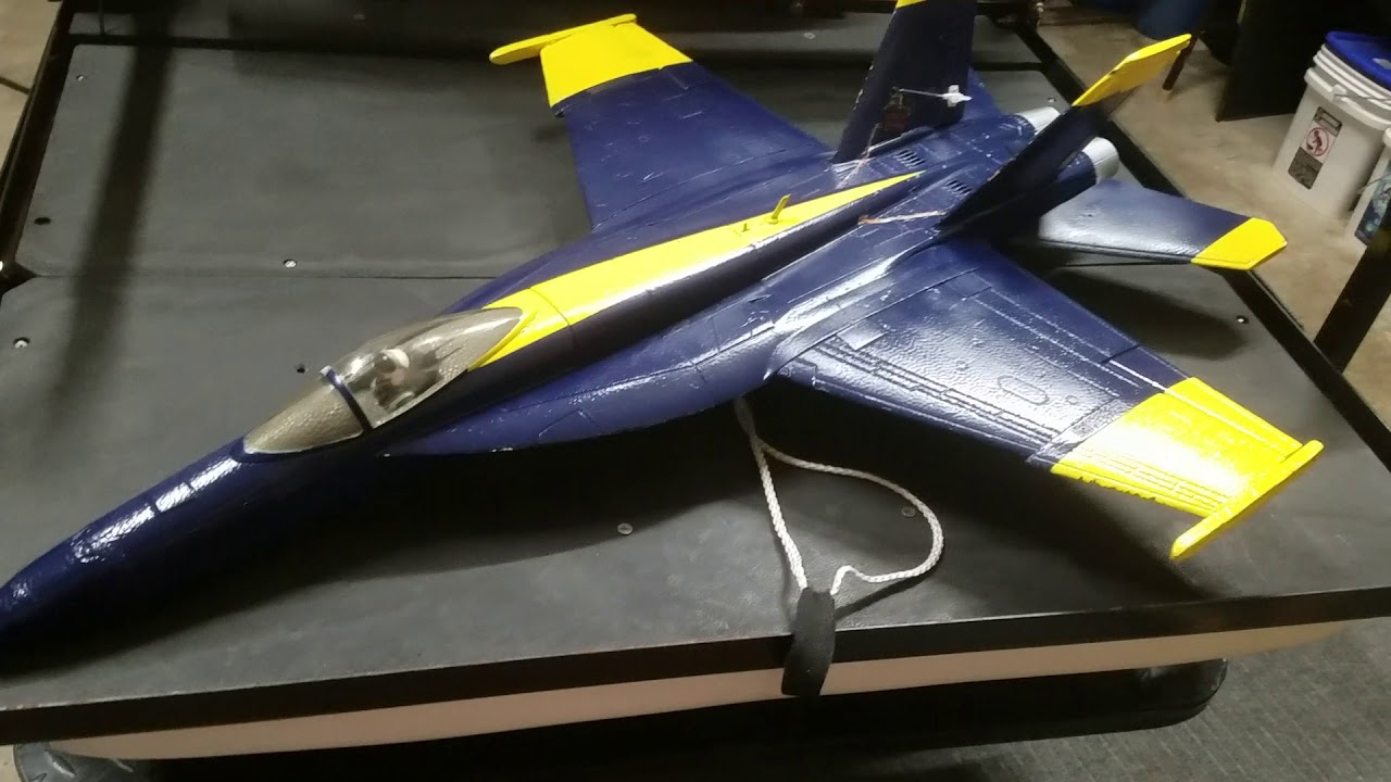

      I have a dx6i and ar636,636b,6600t. It works with them just fine. Here is the 636b in action with dx6i

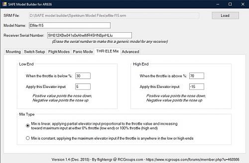

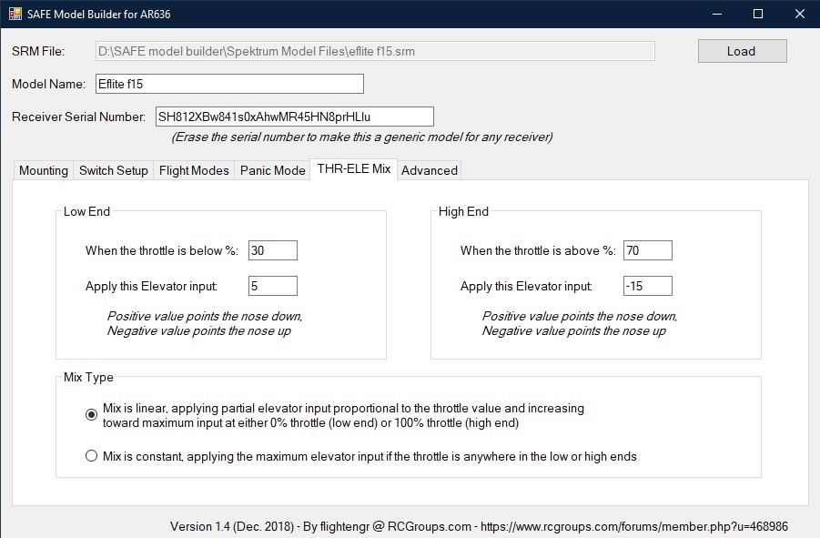

        Originally posted by mshagg
        The horizon/spektrum software doesnt expose the settings you need to eliminate that awful throttle/elevator mix (seriously i dont know why they insist on this, down elevator at low throttle on a jet? But anyway). AR636 has something similar to 'forward programming' but only for adjusting AS3X gains and only if they are set up as relative gains (by default they are set to absolute in their BNF models).
        You'll need the SPMA3065 USB cable, the spektrum programmer software (from horizon) aka SPS and a third party application called SAFE Model Builder (should be able to find via google, it's hosted on a *different* forum) aka SMB
        The workflow is to export the .srm configuration file using SPS, open that .srm file in SMB, eliminate the THR/ELE mix, save, then reimport the modified .srm back into SPS, which will then write it to the receiver.
        Screenshot shows the relevant setting in SMB.
