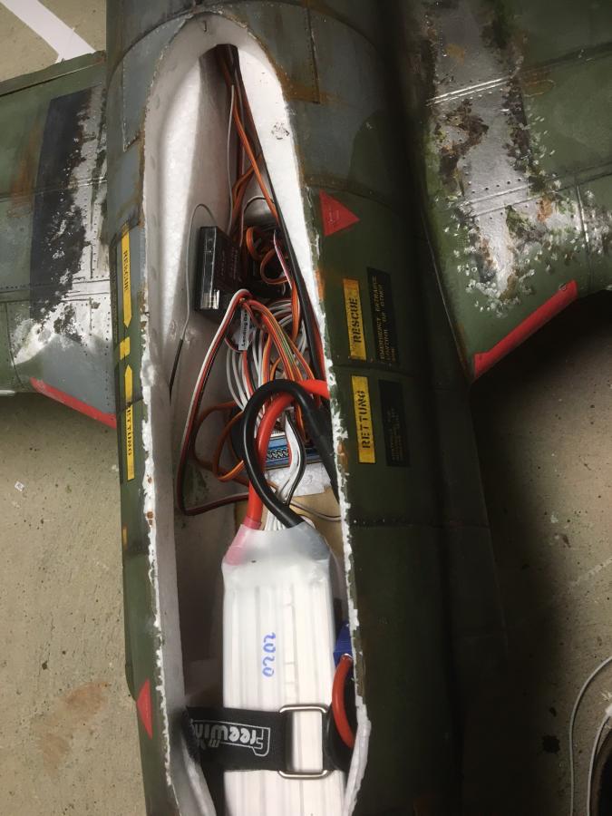

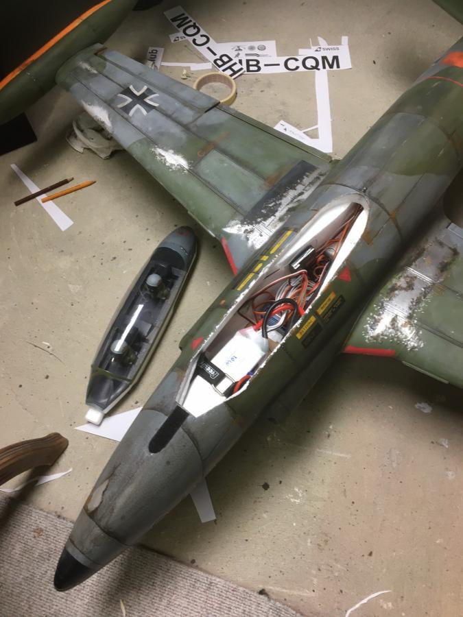

      Hi James, thx for your thoughts, it seems rather unlikely that both antennas were shielded by the Lipo, one antenna was backward ligned, the other foreward and with the plane rolling away from me, the lipo was positioned at the front not at the back.

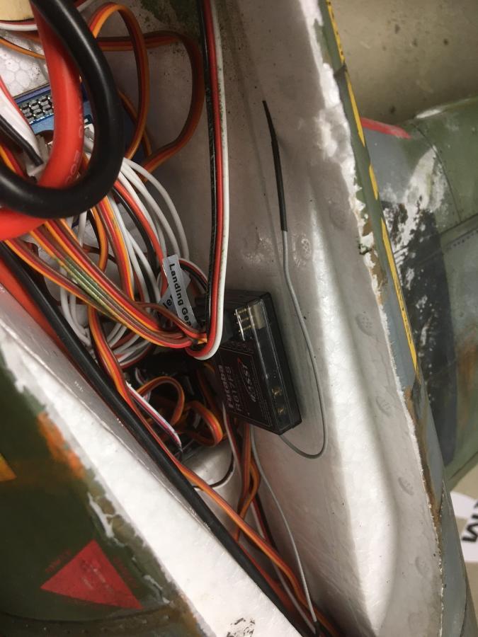

      BTW, I was flying with my Freewing T-33, sorry for any confusion about the runway pic where i posted the Venom. Find enclosed some pics how the receiver is mounted in the T-33:
      thank you and best regards from Switzerland
      JP (the one with the Swiss Hawk U-1271 featured against its original in the Air Force Museum you posted last Friday in your live show... 😉 )

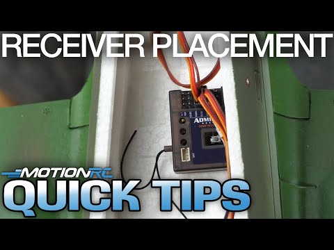

        Well, I will say, that having one aerial forward and one backward is NOT the proper way to mount them. You want your aerials to be 90 degrees from each other so that they are offering the full diversity possible acting in 2 planes of existence.
        The way you have them is 180, so they are only half as useful. I would keep the one going toward the back as you have it, but then the 2nd one I would aim that down or out toward a wing (sometimes I accomplish this by using a small Phillips and plunging it through a thick part of foam and slipping the aerial in that tunnel created)
        We made a video recently about it, but basically make an L with your thumb and index finger, that's how the tips of your aerials should be placed in an aircraft. (just the tips, you can maneuver the wires (without creasing it) as much as you want) but as long as the very tips are as far away and 90 degrees will offer the most success

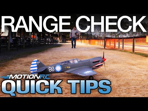

            No problem man, glad I could help and happy that your not posting this with a smashed airplane already. After you replace the RX aerial placement, next time you head to the field, taxi your plane around the runway at all angle in the low power, range check mode. Keep moving all the surfaces and see if you can mimic what had happened the first time. if you notice any glitches or delayed responses then something else might be going on, but my money is on the just distance and angle you were at with your aerials as they were was your culprit this time.
