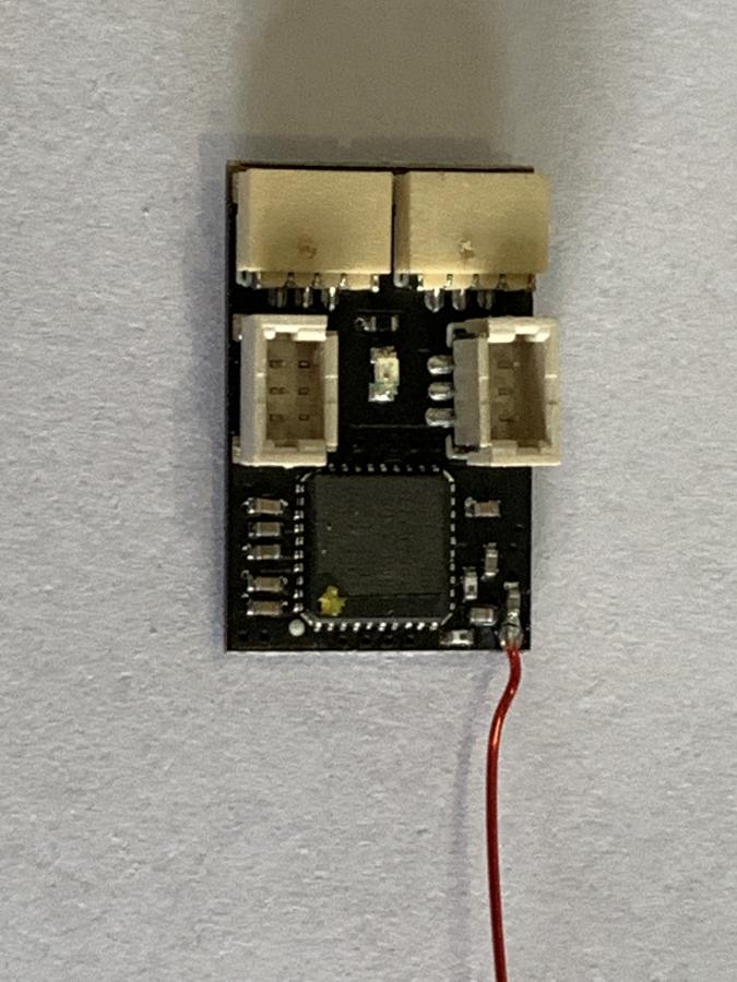

    What I have is the Dancing Wings balsa plane (Sopwith Pup) combo (with brushless motor, esc, receiver (DSMX), 2x servo, 2x Lipo........)
    And honestly I dont know, how to connect :-)
    The reciver is a rx144 for DSMX protocoll
    looks like this here:

    To connect the 2x servos, this is clear.

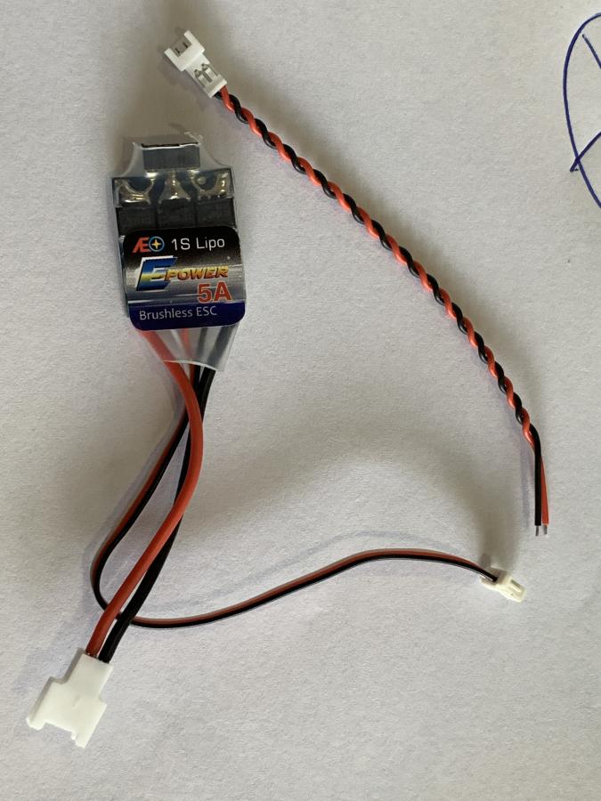

    Also how/where to connect the ESC

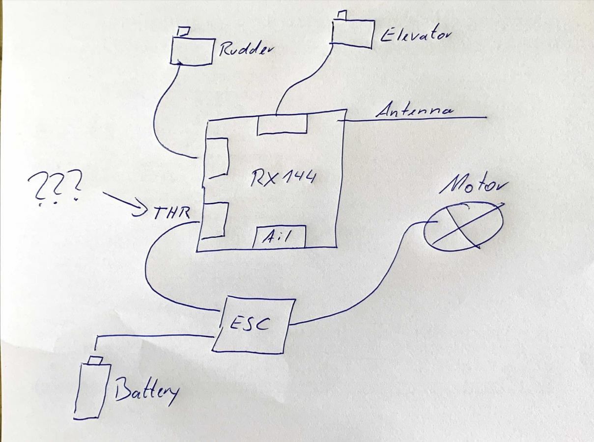

    But where to connect the battery (1s Lipo)?
    When I look at all these connectors, I would think like this here:
ID:	317392But is this correct? Will the battery connected to the ESCm which will support the receiver and serveos with power?
    Or how?
    There are NO extra cables (except the one in the ESC photo), and the connector for the LiPo will match 100% the big white one from the ESC controller.

    There is a diagram here.
    AMA 424553
    • RRHandy
      Instructor Pilot
      • 892
      • Lilburn GA

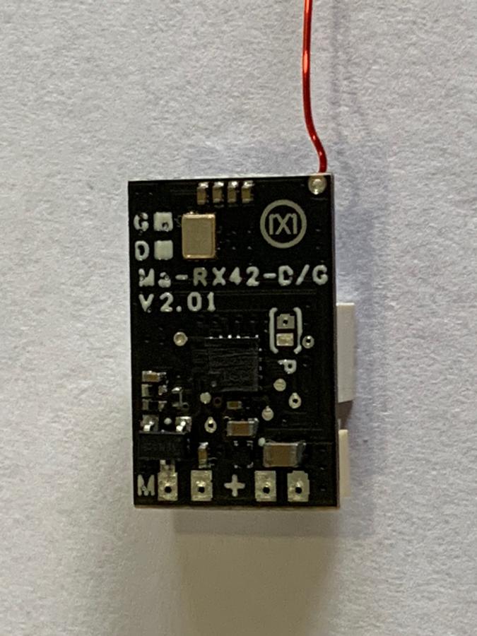

      Now that I'm looking more at it, looks that the receiver has the esc on the board and you don't need the other esc and you need to solder the leads from the motor and the battery to it. Is this parts of a kit you got or are you putting this together from parts? R.

        Hi
        Thank you. I know there is an ESC
        But only for brushed motors
        And mine is a brushless :-)

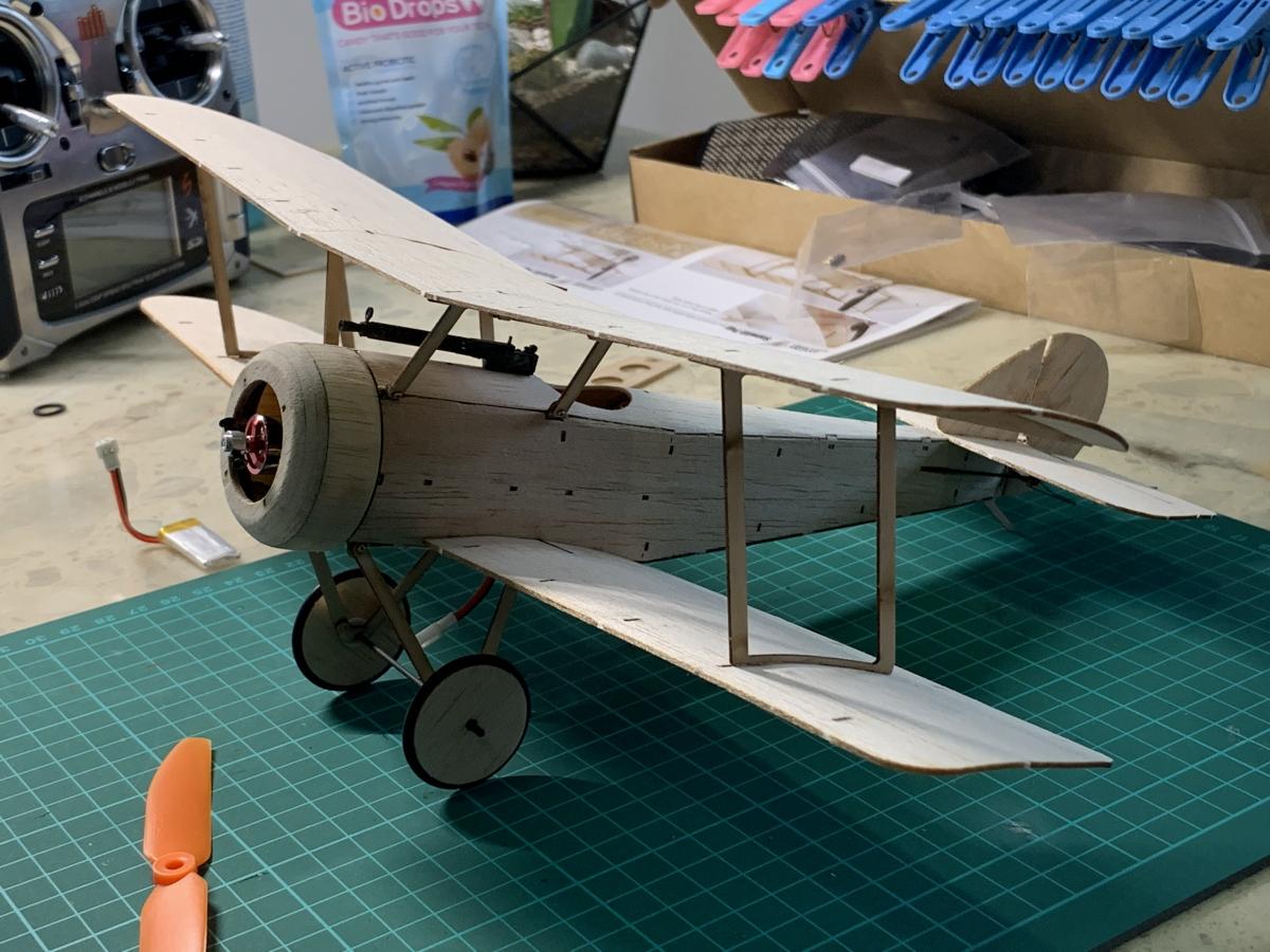

        But I have tried my schema above....and its working as expected
        So I can complete this tiny test plane
