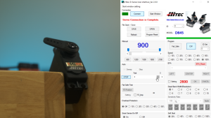

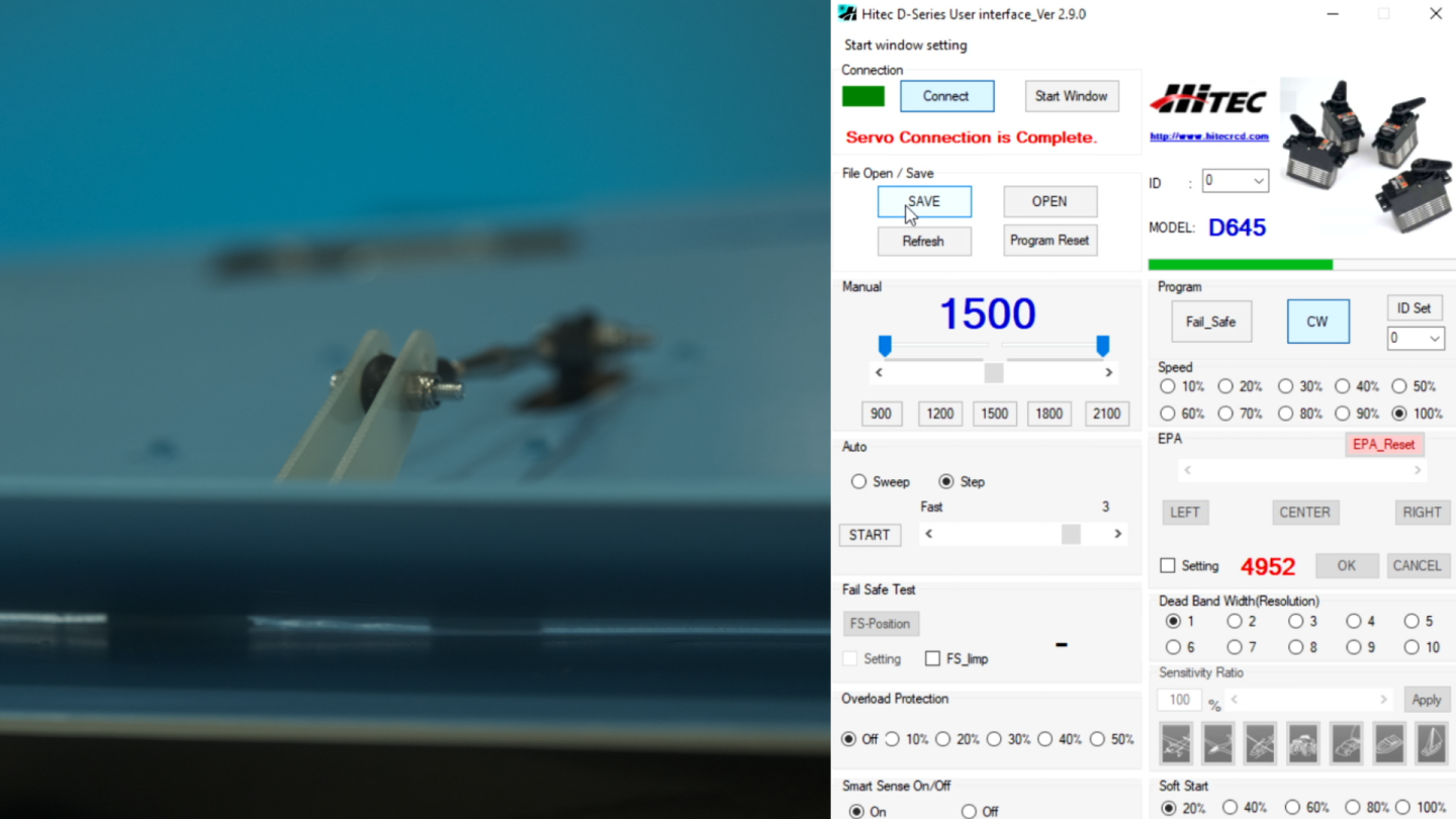

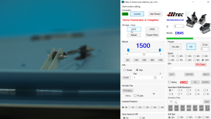

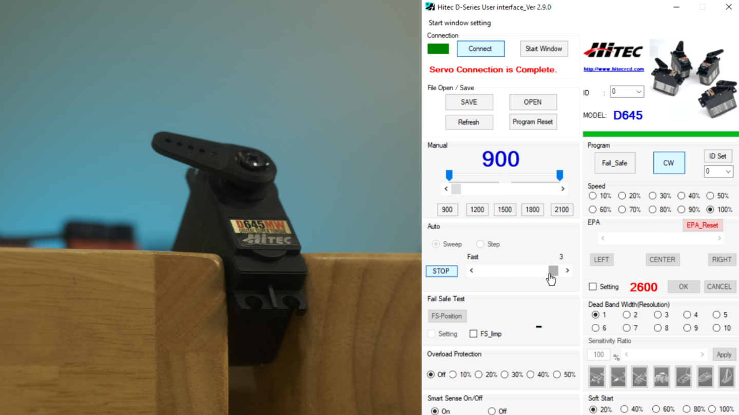

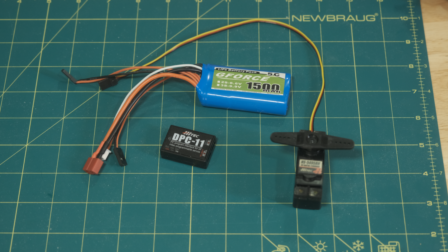

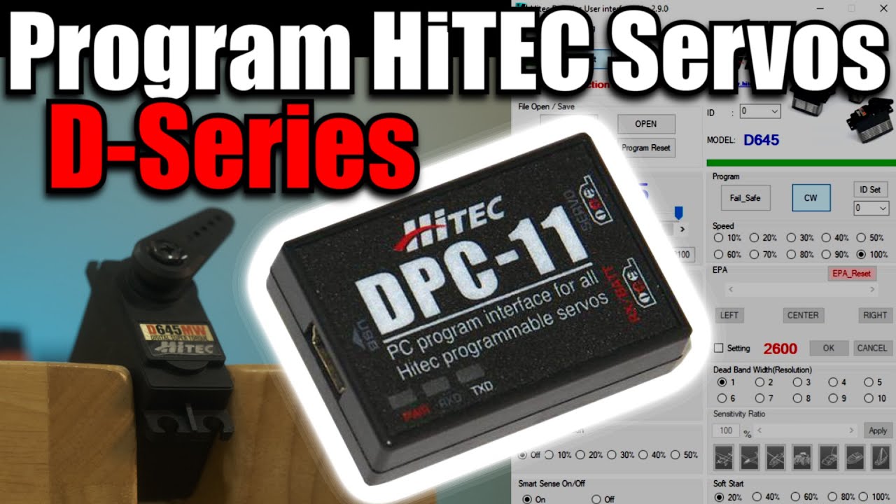

    Split-screen! I hope to save you some time when learning exactly how the DPC-11 works and EXACTLY how the D-Series servos are programmed with both parameters and center/end points. Quick note: the number value when setting your EPA...from my rough calculations, it APPEARS to be about 23 "units" per degree. For example, when I want to program a servo for 45 degrees travel each way, I set the center point, and then add or subtract 1035 from that value to achieve very close to 45 degrees. This is rough...not exact...but how I calculate.
