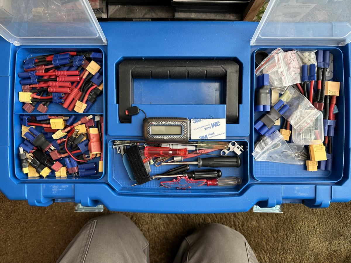

        Insofar as connectors are concerned, after over 40 years of being out of the "game", starting up again was a slow process. I was targeting only planes with certain types of ESC connectors and batteries with matching connectors. That proved difficult, so I got out my old soldering iron and started to change battery connectors to match what was on the plane and the other way around as well. As I started to get more and more planes, I got real tired of that. So, over 150 planes later, here is the top of my field tool box .............................
        Almost every kind of battery/ESC adaptor possible. I just don't worry about it.
        If I see a plane I like, I get it. If I see a battery I want to try, I get it. I still do a lot of soldering but only if I have to. When I run out of storage space, I sell one if I can, give it away if I can't, tear it apart and into the garbage if I can't either of the first two. Life's way too short to be fussing over the little stuff. When I croak, it's all going into a bunch of boxes, to be sold for 5 bucks a box - motors, ESCs, EDFs, props, tools, nick knacks, plane parts, everything, OR ........................................... Like my planes, helis, etc., I tell my family to hire a big dumpster, park it on the driveway under the deck and throw it all in there. I'll leave enough in the bank account to pay for the dumpster. If my flying buddies are able to get there in time to catch stuff before it hits the dumpster, it's all free. When I'm dead, it doesn't really matter. :ghost:
