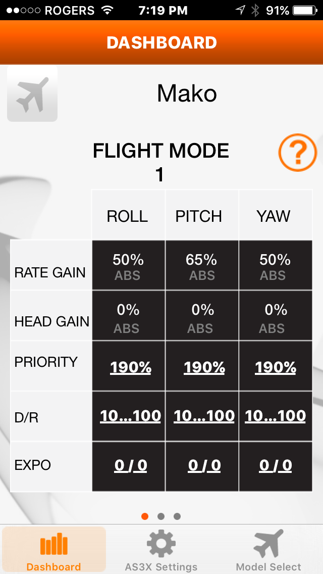

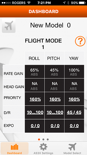

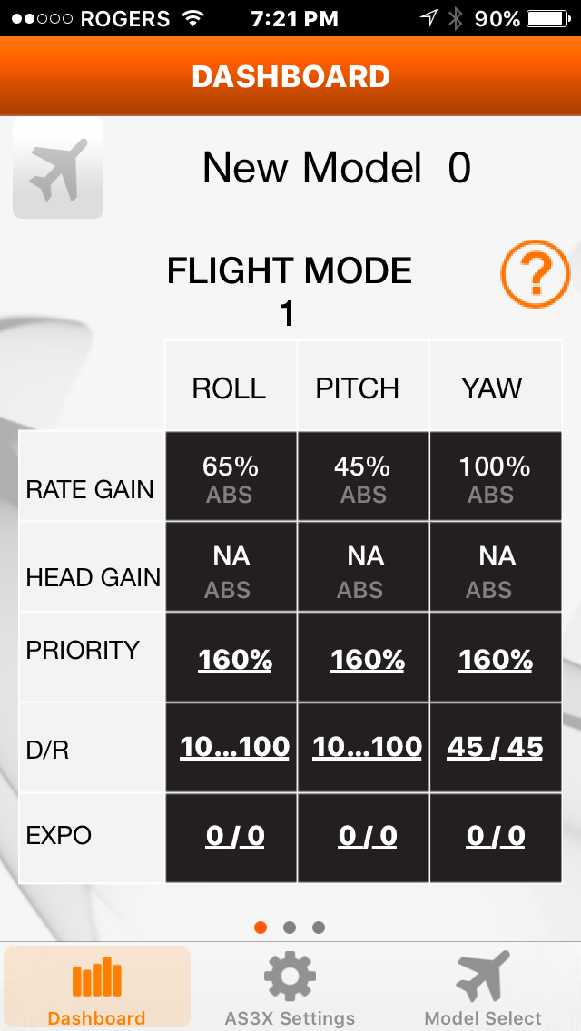

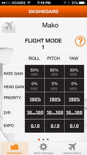

                                      The AR636 for any given Eflite plane is different and there is no "stock" setting. For example the settings for the Rare Bear is nothing like the settings for the Radian XL. Similarly, the settings are completely different for their Timber and again for their P-51.
                                      I suggest you start with something benign like I did with one of my home built foam planes. I took the one out of a Radian XL that someone gave me and I reprogrammed it for the MAKO. I've included screen shots of 2 planes. One is my MAKO and the other is what has been used for their Han5100 P51. My MAKO flies pretty good with those settings. I only use one flight mode for the MAKO, but the P51 uses 3 different modes (with 3 different gain, priority, D/R and expo). I post only one as an example. Your models may use different settings to fly well. It's a matter of trial and error and it's helpful to be able to shut it off with a switch if something doesn't feel right. Personally, I don't like the AR636. For less than 20 bucks, the Hobby Eagle is my preferred stabilizer.
ID:	46654 Click image for larger version
