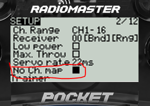

    According to the manual page 8 (and my experience) you need to turn on the receiver (Rx) without any transmitter transmitting and wait until Rx starts blinking quickly - only at this moment is Rx in pairing mode. Then turn on the transmitter and pair.
    If pairing requires throttle at minimum, you also need to check channel mapping - std AETR on Spektrum TEAR. Either the disable mapping switch turned off, or ensure throttle is at channel 1​.
    In addition, DSM uses a channel range from 1100 to 1900 ms, so it is a good idea to limit used channels in the servo menu to approx. +-80%
