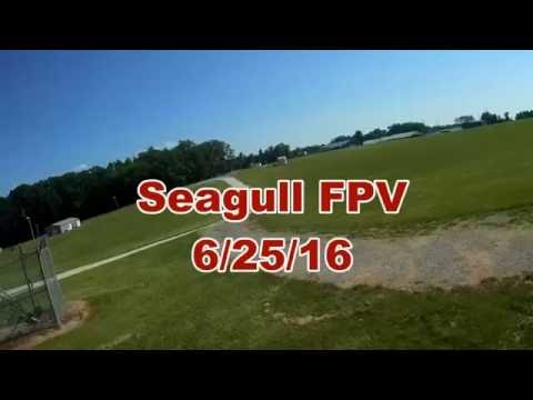

    A little Seagull action from the weekend flying with Mobius and docking transmitter.
