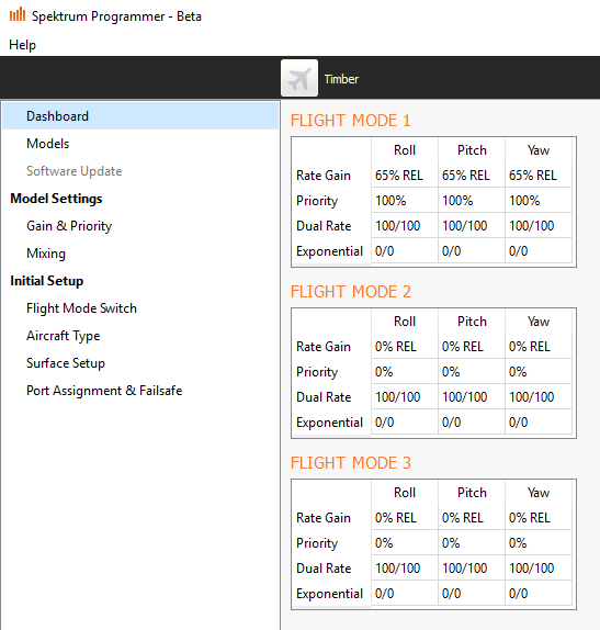

                                  I can't speak about moving receivers from BnF planes, but for the regular AS3X receivers that are programmable there is a much easier way to program them. The smart phone method is simply a stupid "Hey, look what I can do" from the IT people. 16 videos, REALLY? LOL I guess if you really need to make a change at the field it's better than nothing. I bought the Spectrum programming cable for a PC. I could not find any instructions so I called HH. The tech asked if I was using a smart phone or a PC. When I answered that I was using a PC he said "Thank God". We spent about 4 to 5 minutes going over how the program worked and I was good to go. He also suggested that I do all adjustments to the servos and all mixing in the transmitter. A few point and clicks, move a few sliders, adjust a few percentages and voila, ready to go. I'll include a few screen shots of the interfaces. Note that the receiver orientation interface was not available for my Timber BnF receiverClick image for larger version  Name:	Capture1.PNG Views:	1 Size:	26.0 KB ID:	98481

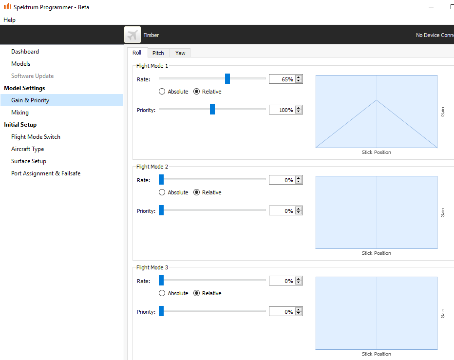

                                    Could someone explain in layman’s term what the “priority” parameter does? I know what the dual rates and exponential do and I assume the rates control the amount of opposing surface correction in windy conditions correct? Also what programming creates the “safe” feature? I have watched all the videos on YouTube but still have a lot of questions.
                                      Best bet is to call HH support.
                                        As I indicated in a previous post, Horizon has a whole series of YouTube videos explaining virtually every aspect of setting up this receiver. In fact, "Step 14" explains gain and priority fairly completely. If this isn't as "layman" as you'd like, I'm not sure anyone can do any better. I found this specific video by simply doing a Google search.
