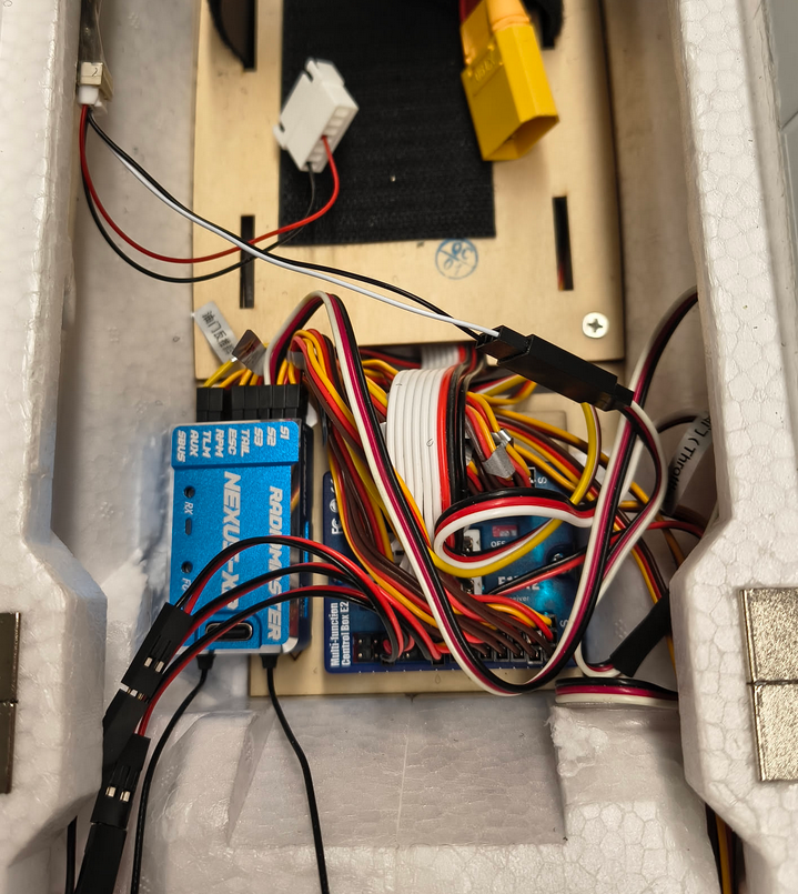

    F-22:
    No special considerations needed. I reversed the direction, if you also do this then go into Alignment and add 180 degrees to the Yaw offset

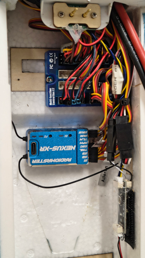

    F-16:
    The F-16 has a downward slope (regardless of whether you put it onto the platform where the blue box sits, or below that) so you will need to add a few degrees of offset.

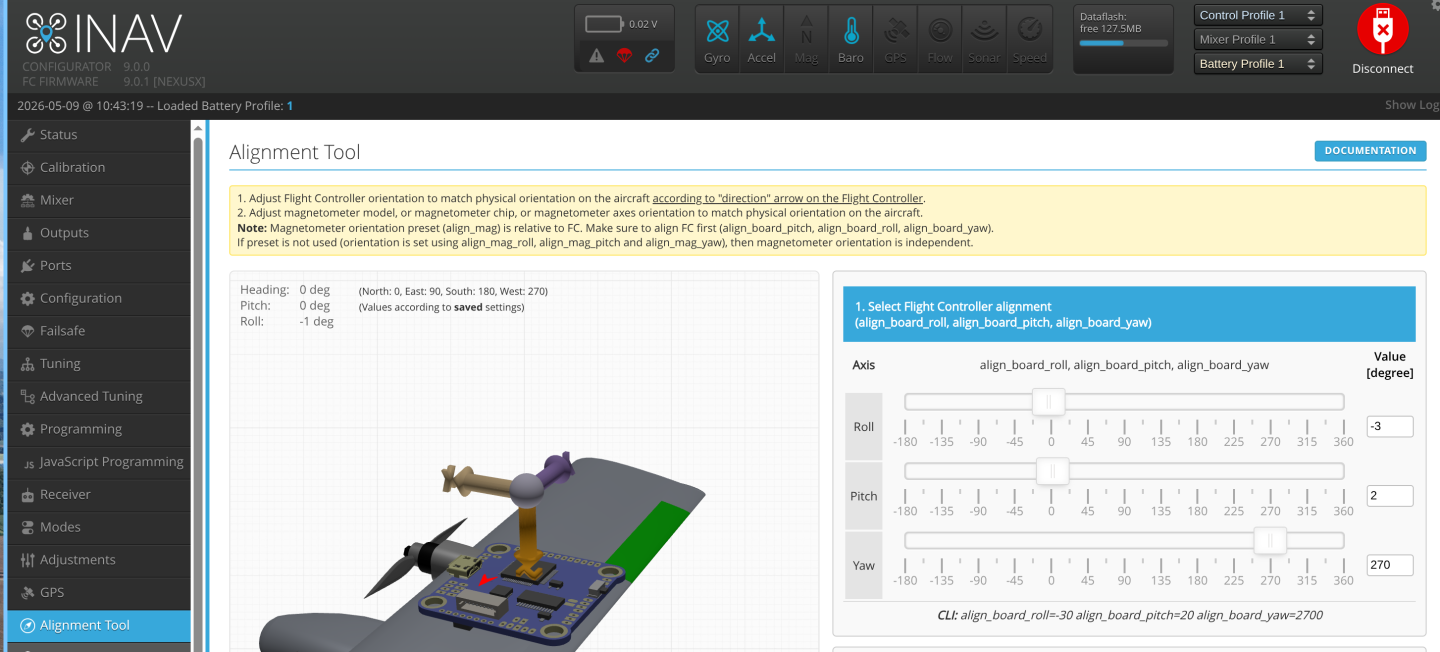

    I also installed at a 90 degree yaw offset. Extend your gear, place the airplane on a level surface, and adjust the alignment offset until you get 0 degree pitch and 0 degree roll. Note that these offsets are relative to the stock FC orientation, i.e. pitch will always offset the pitch as seen on the axis from the antenna ports to the servo ports, with the servo ports being "forward". If you install at a 90 degree angle like me this can be a bit confusing.

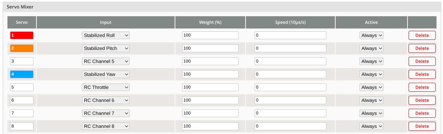

    You'll need to add a few servo output channels in the INAV controller. You do this via the Mixer, and "Add mixer rule". I set up both the F-22 and the F-16 identically:
    Click image for larger version  Name:	image.png Views:	0 Size:	87.2 KB ID:	448438​
