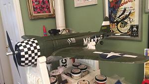

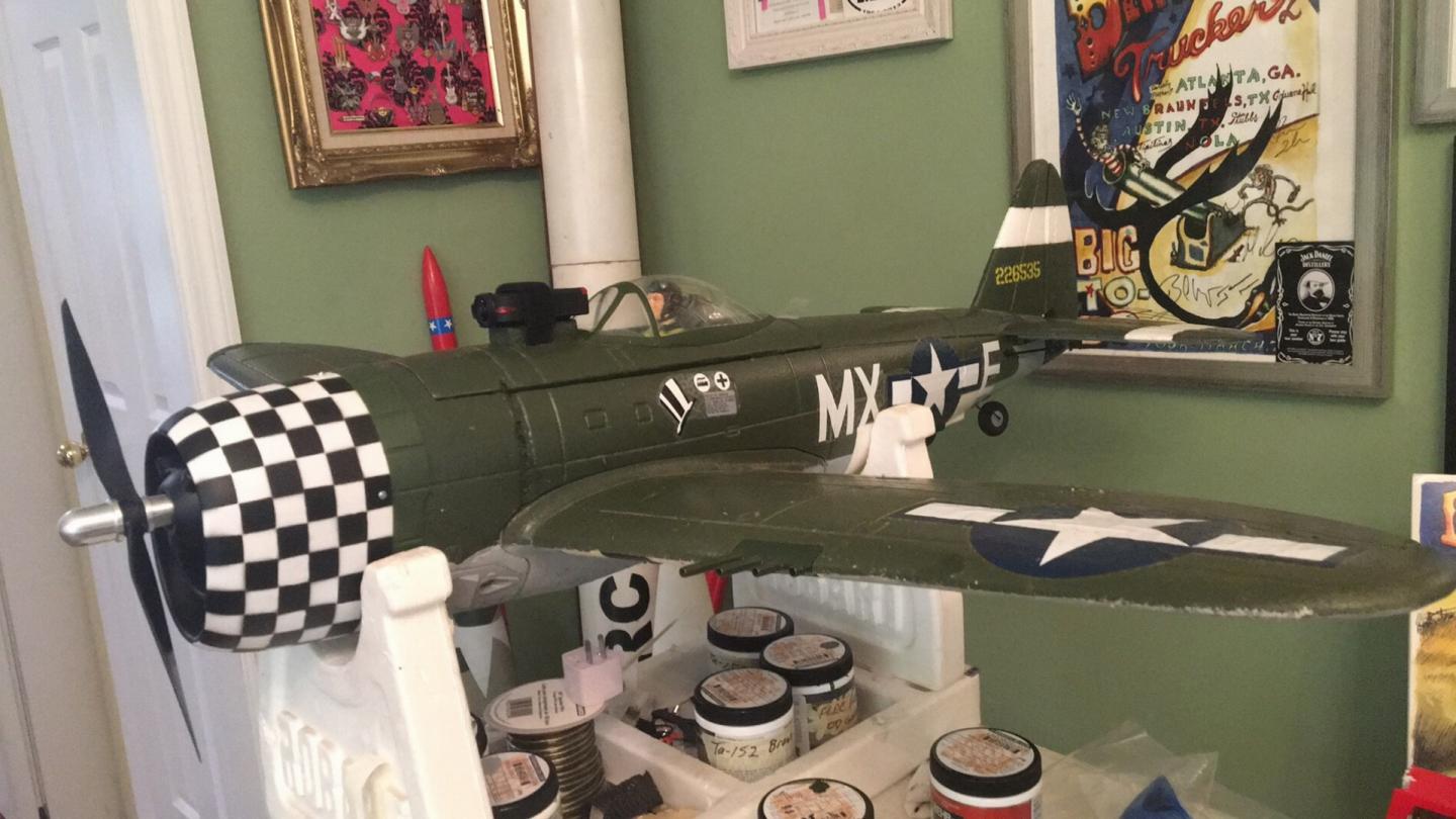

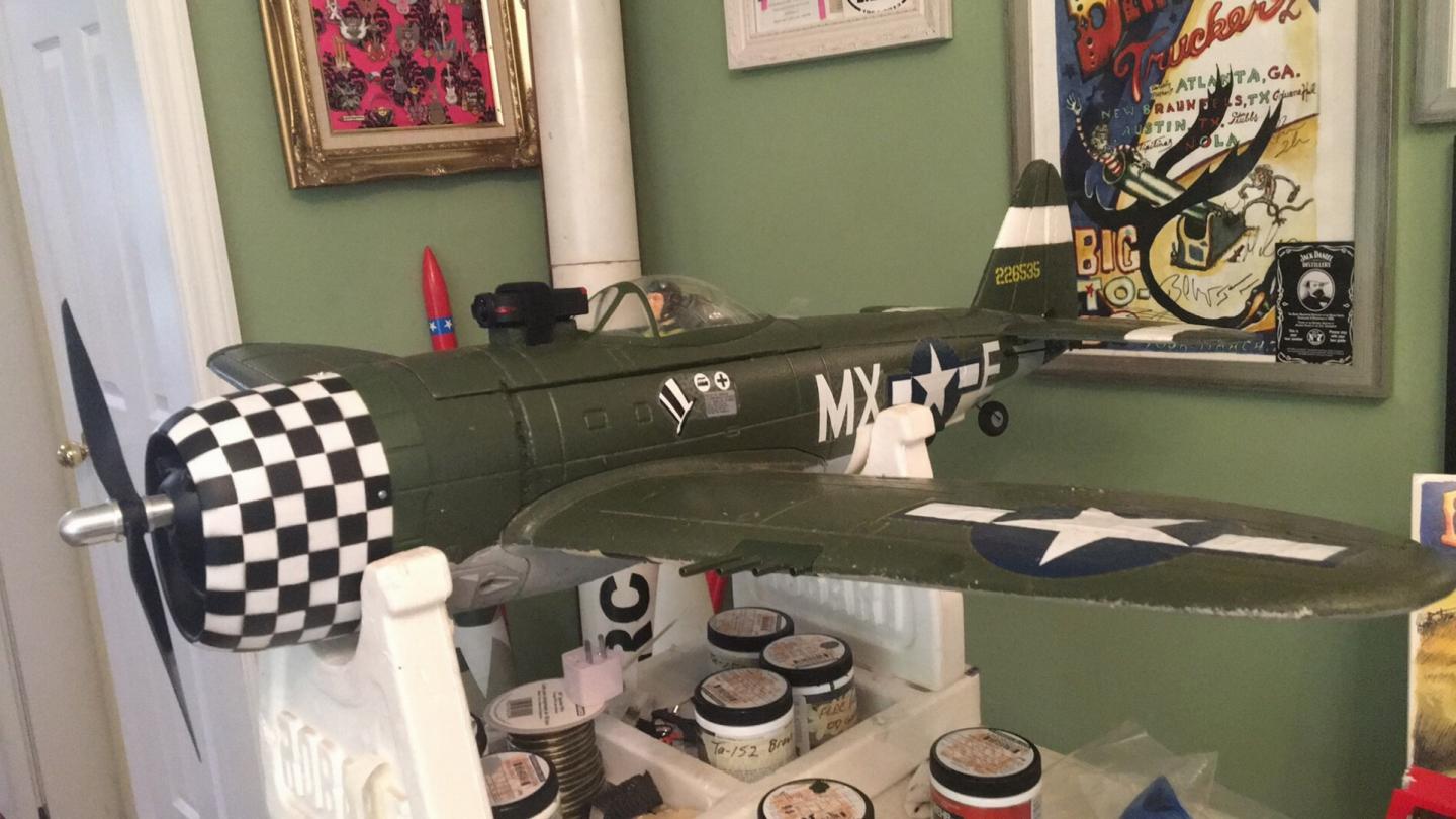

ID:	64681 On my P-47, I used a standoff block and Velcro, which works very well. I use a Firefly Q6, which is very similar in shape and function
                                    to the Mobius. The camera also sits on a Velcro mount, which allows the camera to 'float' a little, in relation to the fuselage. So, it gives a bit of an illusion of the pilot looking around .

                                      That looks great

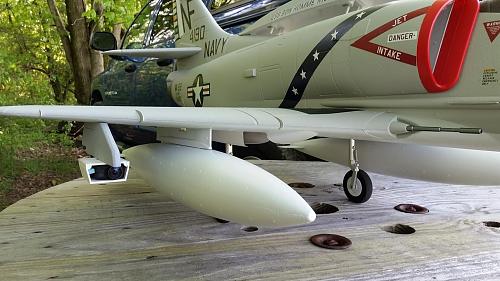

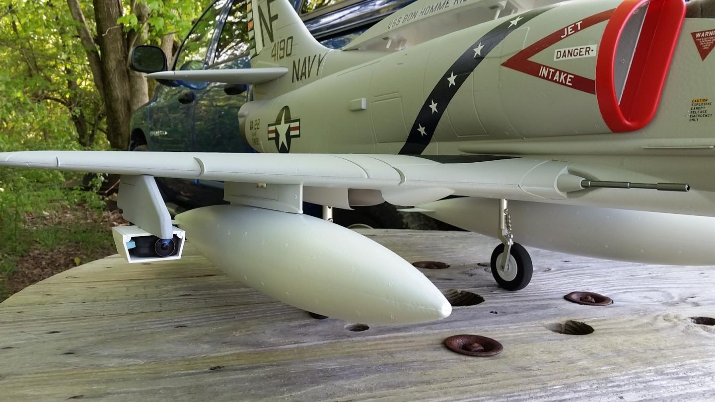

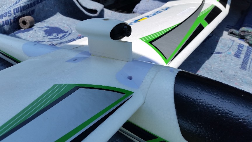

                                        Hey guys,
                                        DirtyDee designed a 3D printed part that attaches to the Mobius camera mount, so that it can be mounted on a standard Freewing weapons pylon.
                                        That was posted in the A10 thread here - post# 8430
                                        I have been working on a 3D-printed box that holds the camera, and can be mounted on a weapons pylon. This was designed by my friend Bob (he lives in Belgium, and is not on the Squawk). We've been playing with it and making different versions. We made the original simple box to mount under a Freewing wing pylon.
                                        Then we made a new design that was aerodynamic (and a lot cooler).

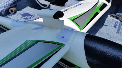

                                        Then we made a version that could be mounted on TOP of something, And, a pylon so that the camera could be raised up from the mounting surface. I used this on my Radian glider.
                                        Any of you guys with 3D printers can print these if you wish.
                                        The mounts are the standard "hooks" that fit into the "slots" that are on the weapon pylons - but you can also use
                                        APMECH1's design and print the slots, which can be mounted anywhere on the airplane so that this camera can just be mounted anywhere you want.
                                        I have uploaded the STL files. Here is a Thingiverse link if you want to download: https://www.thingiverse.com/Foaminatthemouth/designs
                                        Click image for larger version  Name:	20180520_174715cr.jpg Views:	3 Size:	153.3 KB ID:	138254Click image for larger version  Name:	Camera Pod-cr.jpg Views:	1 Size:	91.1 KB ID:	138255
