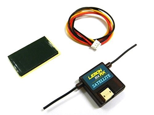

      All Spektrum Rx's that have a satellite port do require the Satellite to be connected and bound. That is just the way Spektum elected to configure them(you can figure the marketing plan behind that idea).
      Almost 2 years ago I walked away from Spektrum after having issues with two separate AR8000 units in which one cost me a $600 bird.
      Go with Lemon..... a 10 chan DSMX with satellite for under $30. And you do not need to use the satellite but why would you not. :Confused:
      Or the 7 chan with Stabilizer and Satellite for under $30
      Or the 6 chan w/sat @ $17.60
      Here's a link to the web retailer I get mine from:
      Add the Telemetry for $34 to either of the previously mentioned and your still at better than half the price of the Spektrum telemetry integrated receivers. ;)

                  What is this Lemon upgrade change? Is it some kind of receiver compatible with Spektrum radios?
                  I currently have a X9303 and would like to get recei vers for it, but the AR6210 I find on Ebay seem to be all clones.
                  is my solution sell and migrate to Futaba?
                  what good rx should I buy for the tx I got?
                  Read the AR610 is a good Spektrum 6 channel receiver, about 40 dollars on Ebay.
                  Attached are receiver dsmx etc, do I need both to work? Or only the 6 channel rx?
                  this is so confusing, I am moving from frequ3ncy radios and all the satellite stuff I dont know what it is. And my rc cars is bind and drive...
                    • 8814
                    I'm not sure what "upgrade" you are asking about. All Lemon RXs are Spektrum compatible. I've been using Lemon and their telemetry units for a couple of year now and have been very satisfied with those products. The satellite RX is simply an extension of the main RX to make it more of a "full range". I always use a satellite RX with my Lemon RX's to ensure I get the best reliable range possible. I have flown my planes to the limit of my eyesight on some planes without reception problems. I'm not sure about the JR radio. Is it a Spektrum radio? If so, then the Lemon products will work.
                    PS. You can use only the main RX by itself without the satellite, but I would consider this to be only a "park flyer" type of range even though they say the ones with the "diversity" antenna are full range by themselves. I recommend you use both the main and the sat. They're not that expensive. Just make sure that if the main is DSMX, the sat is also DSMX. Lemon sells DSM2 as well.
