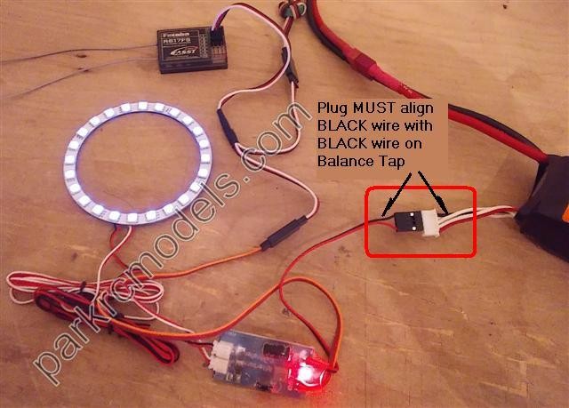

Not a problem at all. Happy to try to help. Do you have it wired up like the attached picture that ParkRC provided? Make sure the negative wire on the prongs is plugged into the negative wire on the LiPo's balance tab. That's crucial otherwise it can short out. Also, be sure the opposing side with the two white plugs are correct and attached with the corresponding colors properly in place.This ring is a rc castle cyclone for 80 mm jet, however my goshawk is a 90mm but the 80 fit great with little modifications. My two admiral 5000mah 60c 4 s batteries are wired in series to the ESC once plugged in. Ring worked great with servo tester and with an external power system that came out of hawk. Original system was a 6's 90mm edf with factory 130 amp ESC with external ubec that was already wired in to ec5 connector. With this system hooked up and ring plugged into balance lead on admiral 5000mah 50c 6's battery, all worked great on table. I converted this plane to a 90mm edf inrunner, the ZTW 150 hv ESC, ZTW ubec, and 8's power. With ESC unplugged from batteries, ring would work while plugged into balance plug on 4's battery, when I plugged in ESC, the wires going from balance plug to power ring, immediately started to smoke, and melt. This is a 2 plug connection, one red and one black wire of which plugs into balance lead. One pin on plug goes to black wire on balance plug and the red pin goes into 3rd cell hole in plug as per manual. The description on web site say this ring is capable of working with up to an 8's system. So why the melting wires?? It's really working my brain and just don't get it. Thanks for all the help with this.
