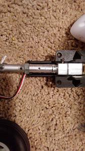

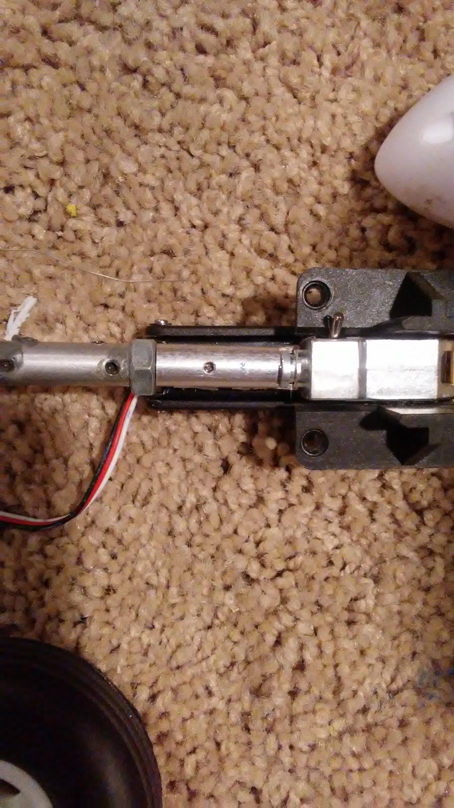

        I gave up on Dynam retracts. I replace them with the Freewing type A 4.1mm retract. They bolt right in and you can use the original strut and wheel assembly. For rotating retracts like in the corsair, I use the ones from the FMS 1400mm corsair. The retracts will bolt right in, but you need to come up with a strut that will work. If you get the strut assemble from the FMS corsair, you will need to extend it. I used a small nut...

          Will that work on the f6f hellcat also.

            Hi Dewey, I assume the retract would bolt right in since Dynam would use the same bolt pattern on the Hellcat as the Corsair. It would just be a matter of the length of the strut. Not sure if you would have to extend it or not.
