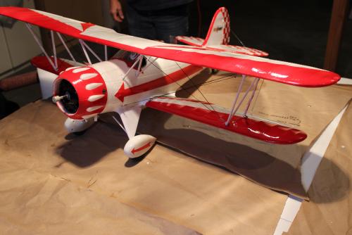

        Seriously, I did my Mustang a while ago, right over decals with no trouble. Recently did a little leading edge reenforcement on my Waco with some red duct tape and then coated it with Minwax and that worked great as well. Just beware that if you aren't doing a surface that has already been painted, you'll have to rub the Minwax into the surface. See the Minwax topic in the forum. I tried applying the first coat on my Waco much like I'd apply a coat of wax to a pair of shoes, rub it in and it removes any leftover mold lubricant (and there will be some!), let dry then coat again. Try it in a small area under the wing first.
        Works Great!

              > Give it a try, I did with some IPA, but the results weren't the best, I
              > found it a lot quicker just to rub the Minwax in. Hippie 64 (Brian) air
              > brushed Minwax on and said the results were really good as well!
              > Grossman56
              > This is my Waco that I rubbed the Minwax in first
