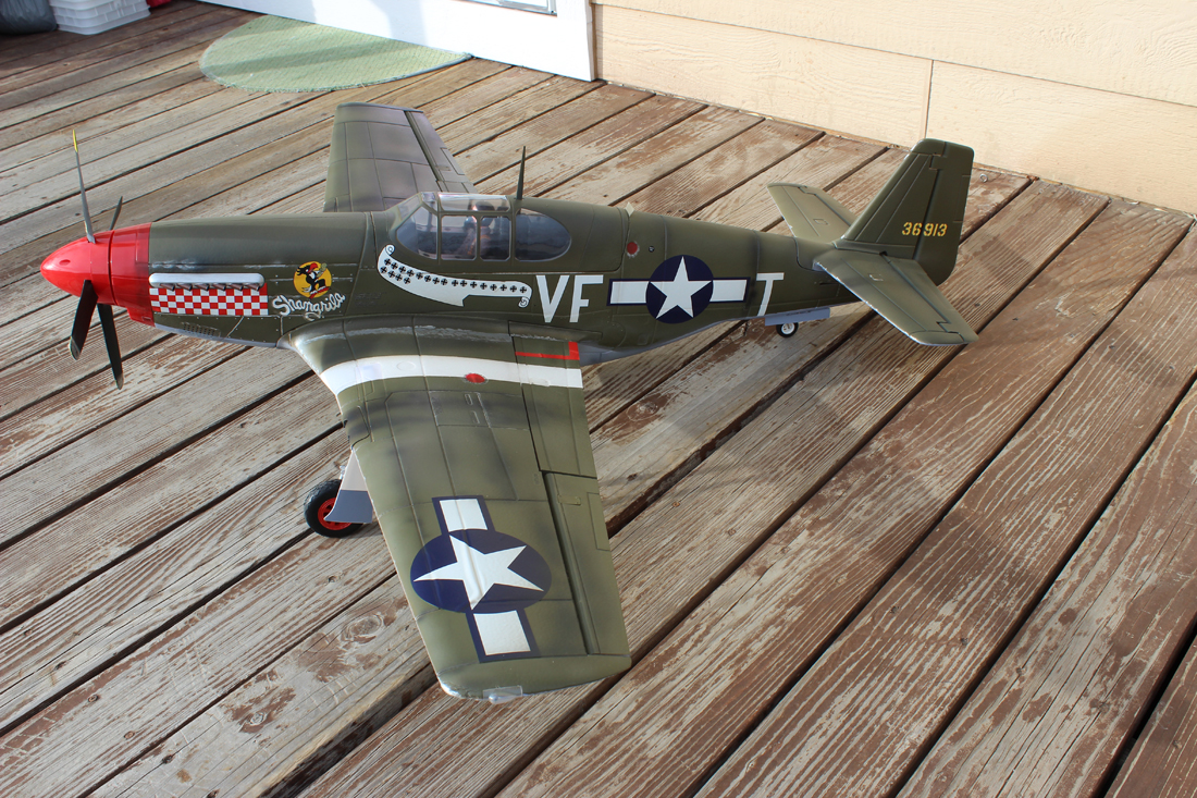

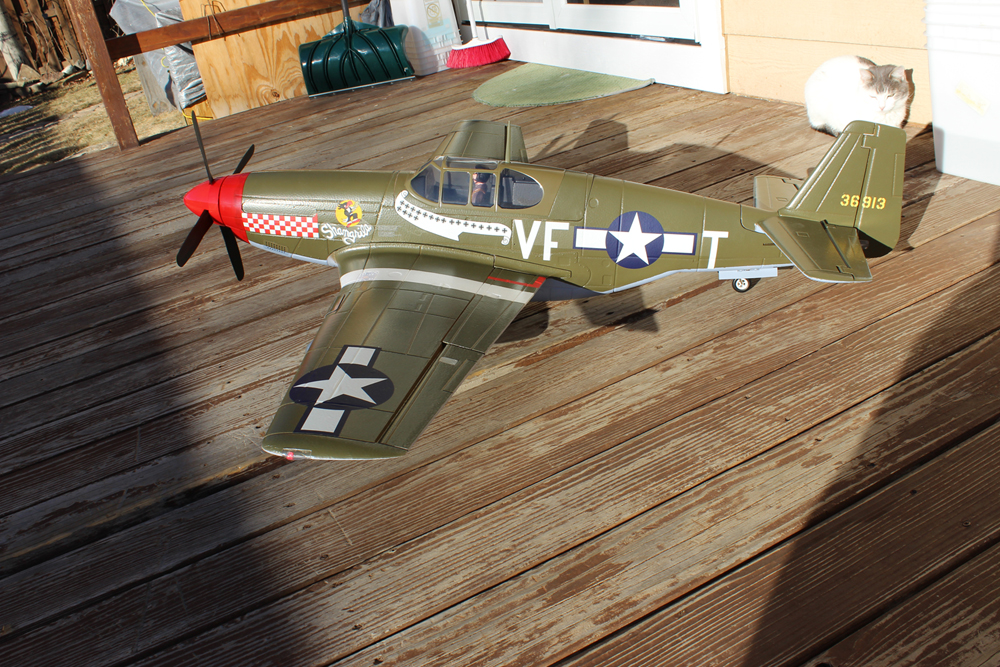

    Here we are guys!  We asked for it and MRC responded!  Now lets see what we can do hear.
    I've been experimenting around with my airbrush, getting the feel of it.  Going to try the two other needles that came with it as well
    If you didn't catch this before, here's a great set of videos to help you along.  I found them extremely helpful.
    https://www.youtube.com/user/grextools/videos?sort=dd&shelf_id=0&view=0. Shangila went from factory finish
    To warbird finish
    using this fellows techniques
    Party on !

    Dang G56-that looks fantastic! Wish I could see it flying too, I bet it will looks outstanding on those fast, low fly-bys! Awesome!

      Thanks Lone, can't wait to see her fly myself, just waiting for the weather to get better and the wind to let up  a little.
      You know how you get a good feeling about an airplane, like you just know she's going to be great in the air, well, that me with this plane.  Still have to check the control throws and I'll probably do the CG again, just to make sure, but yeah, she'll be great.
      That was the thing when I watched the video of Ryan flying his, it just looked sooooo authentic!!

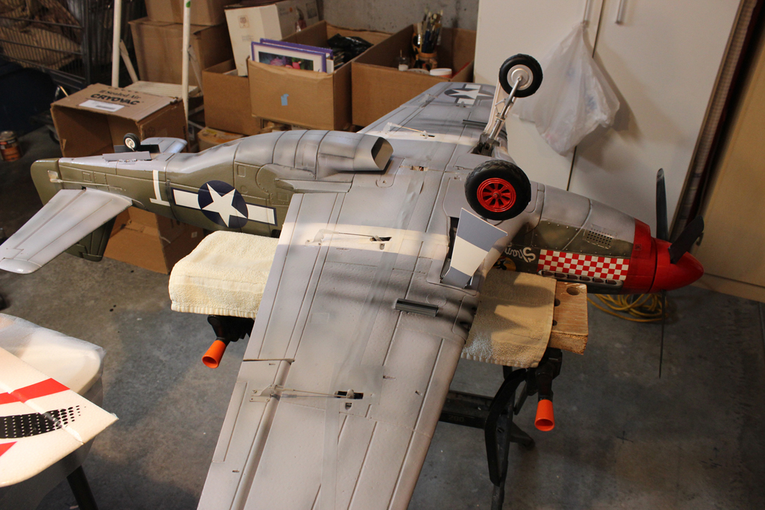

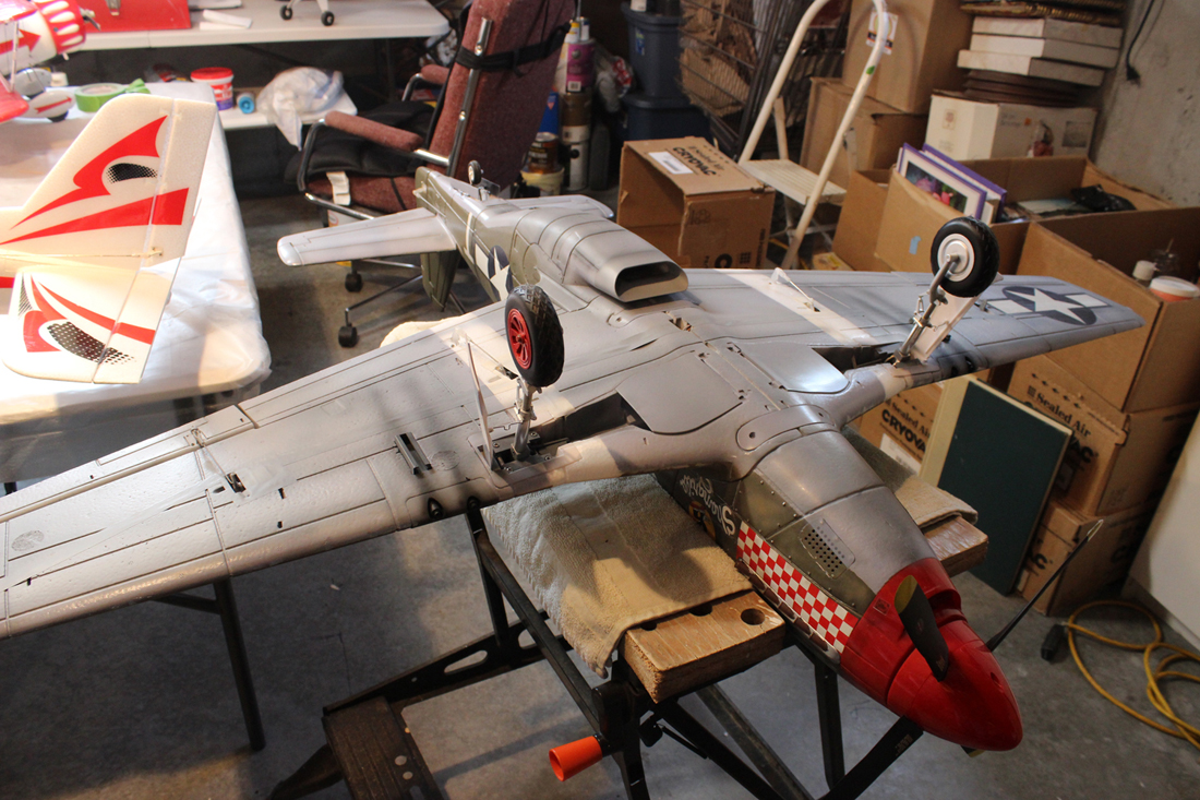

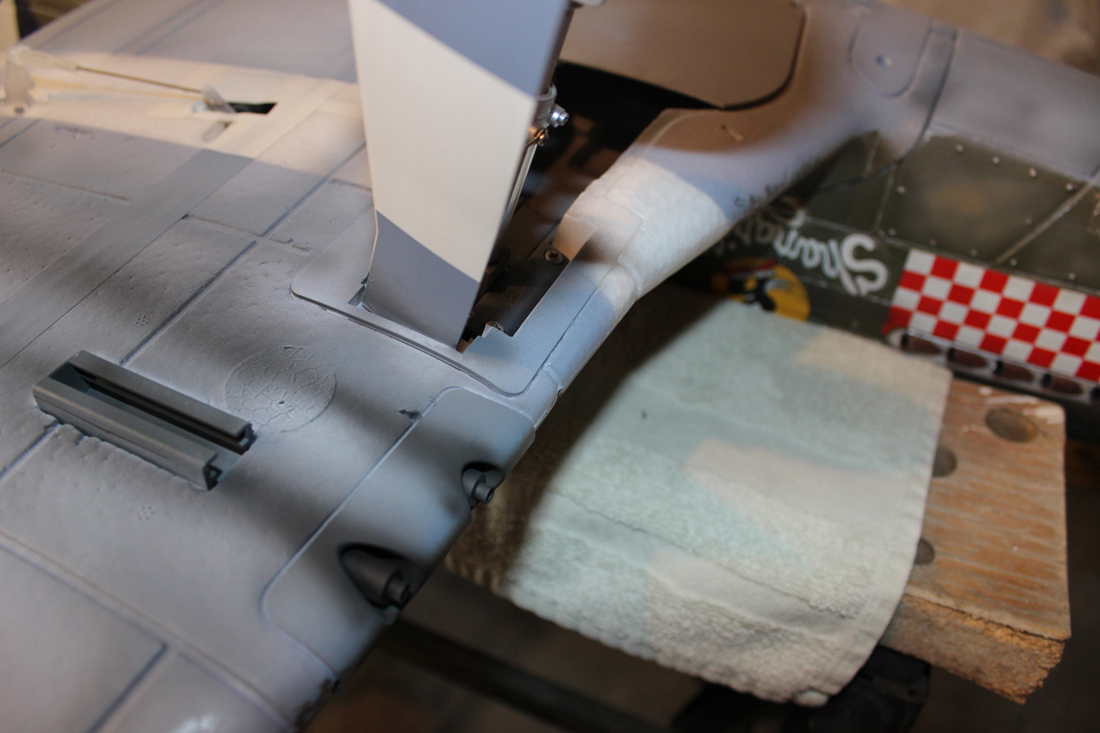

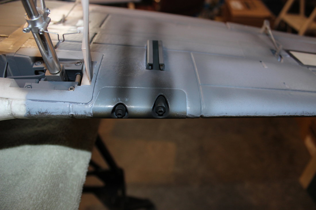

        Got the undersides of Shangrila done this morning as the sun is shining and 60 degrees here.  So why, pray tell, am I not out flying?
        Damned wind is knocking down power lines!!!!!!!!!!!!!!!!!
        Notice the wheels are red as Shangrila's were
        Did a little practicing with the airbrush, aiming, controlling flow,etc. I found, once again, that thin paint is the best for me, about 50/50, then I adjust the flow of the gun so I can crawl right up to the panel lines and add black, I really noticed an improvement today.  I'm using two hands on the gun, just as if I were shooting a pistol and easing back on the trigger rather than stabbing it.  If you have it set just right, there is no spider webbing when you are less than an inch from the panel.

          Looks great Gman,
            I'll be getting the new airbrush soon so I will try it on my Freewing P-51.  60 degrees.......you're kidding, I'm getting ready for 15 more inches of snow here.  PLENTY of time for airbrushing!!!!

              That looks great Gman. Looks like you caught on to that airbrush dang quick!
