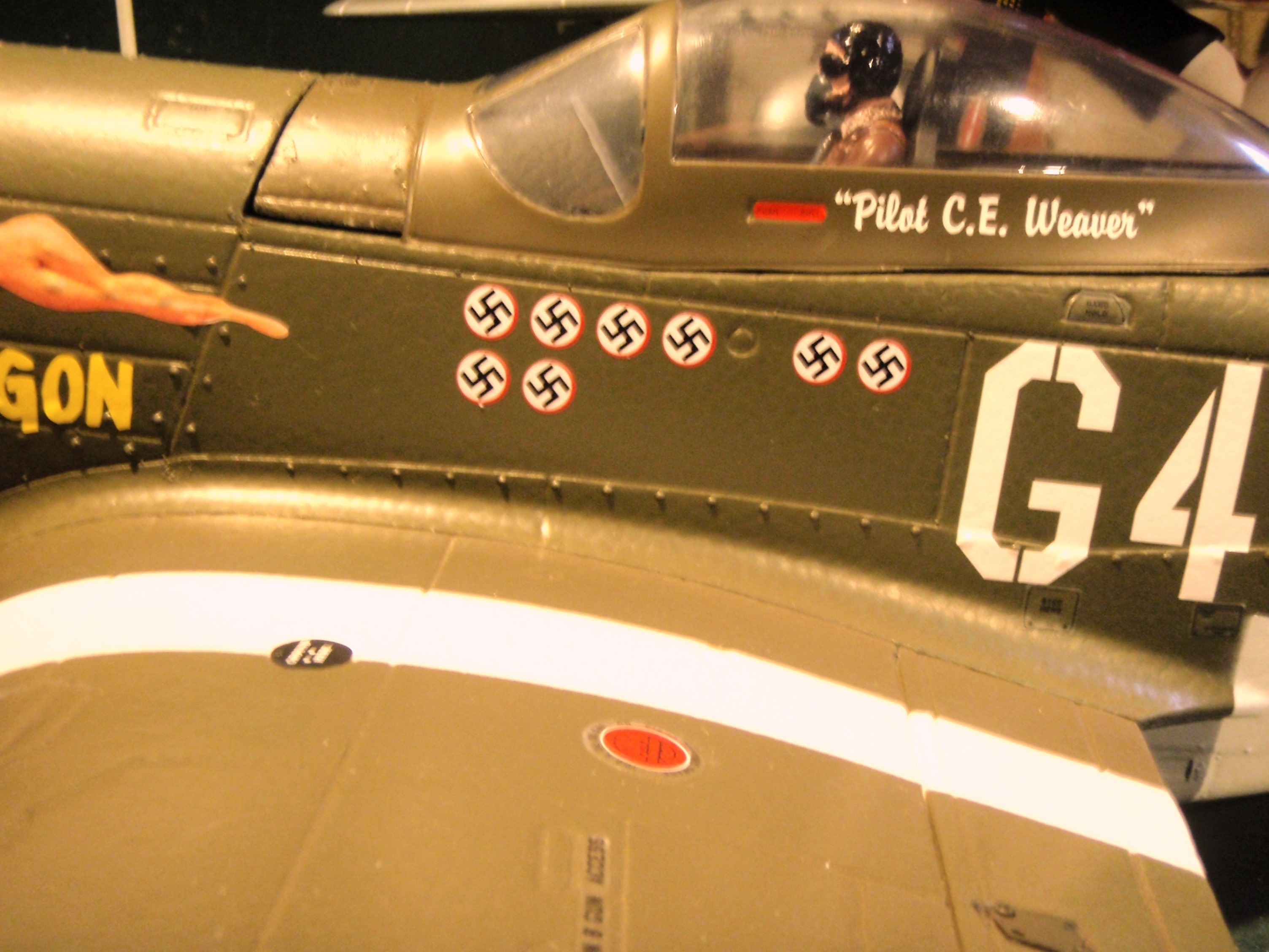

    I've had experience with one set of Callie decals.  My P-51 Passion Wagon is all from Callie.
    First of all, your right on how you think the decals will be applied. You peel off the heavy paper on the backside, then position and press the decals into position with that thin sticky still attached to the decals.
    I first cut out around the specific decal I was going to apply, leaving about a 1/4 inch border around the decal. Of course, I have a visual of where exactly I want it positioned, and carefully put/place it into it's place. NOTE: I had GREAT concern about the thin clear film sticking to and pulling my new paint job off. DID NOT HAPPEN!
    When you position the decal, and apply it, make sure you don't just start rubbing the decal anywhere.  Have a plan (start in the middle and SLOWLY work towards the outside/end of the particular decal, specially the large surface decals, like the stars on the wings and fuse. This is so you look for, and avoid pressing on wrinkles/bubbles, pulling up the decal some if you happen to have this issue. When you see, no wrinkles, happy with its position, start pressing on the decal, but as much as possible, avoid pressing the clear film that you are going to be peeling away shortly. You will find the decal will form very good to panel lines.  I used a cotton tip cuetip in those areas, getting them to form/stick down in the panel lines.
    NOW....decal in place, you've pressed firmly on the decal....time to peel the clear film off.  SLOWLY start at one corner of the film, and pull the film as much as possible, parallel to the surface, do not pull up and away! As the film gets to the decal, be ready and not surprised, if the decal sometimes starts to pull away from surface....have a cue-tip or something soft to poke and hold the decal back into position on the surface...then continue slowly peeling. This will not happen all the time....Just be ready!
    Take your time, you'll love the results.
