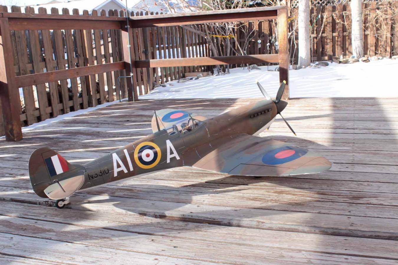

                              Speaking of clear coats, I'm usually looking for a glossy coat, the glossier the better! With the new Spitfire, I loved the original colors
                              But when I coated it with Minwax stain finish, it really darkened the colors and left it too shiny.
ID:	119587 So I went hunting for Minwax matte finish. It's a rarity out here in Cody, so I had to resort to buying it on line. I recalled that when I used an airbrush to apply the glossy clear coat on one of the other planes, it was duller than applying it with a brush. So taking this bit of info, I applied the matte finish with the airbrush and it dulled it down considerably and lightened up the colors as well. I have one coat on it so far and am looking at giving it three in total, same as I do with the gloss coat. Hopefully that will help get it back to dull and authentic.
                              When I'm finished, I'll get some more pics so you can see the results. However, from this experience, I would recommend that if you have authentic looking paint samples, Minwax it with some kind of UV protectant in it before applying colors until someone gives us all the definitive answer on a clear coat that doesn't change the color.

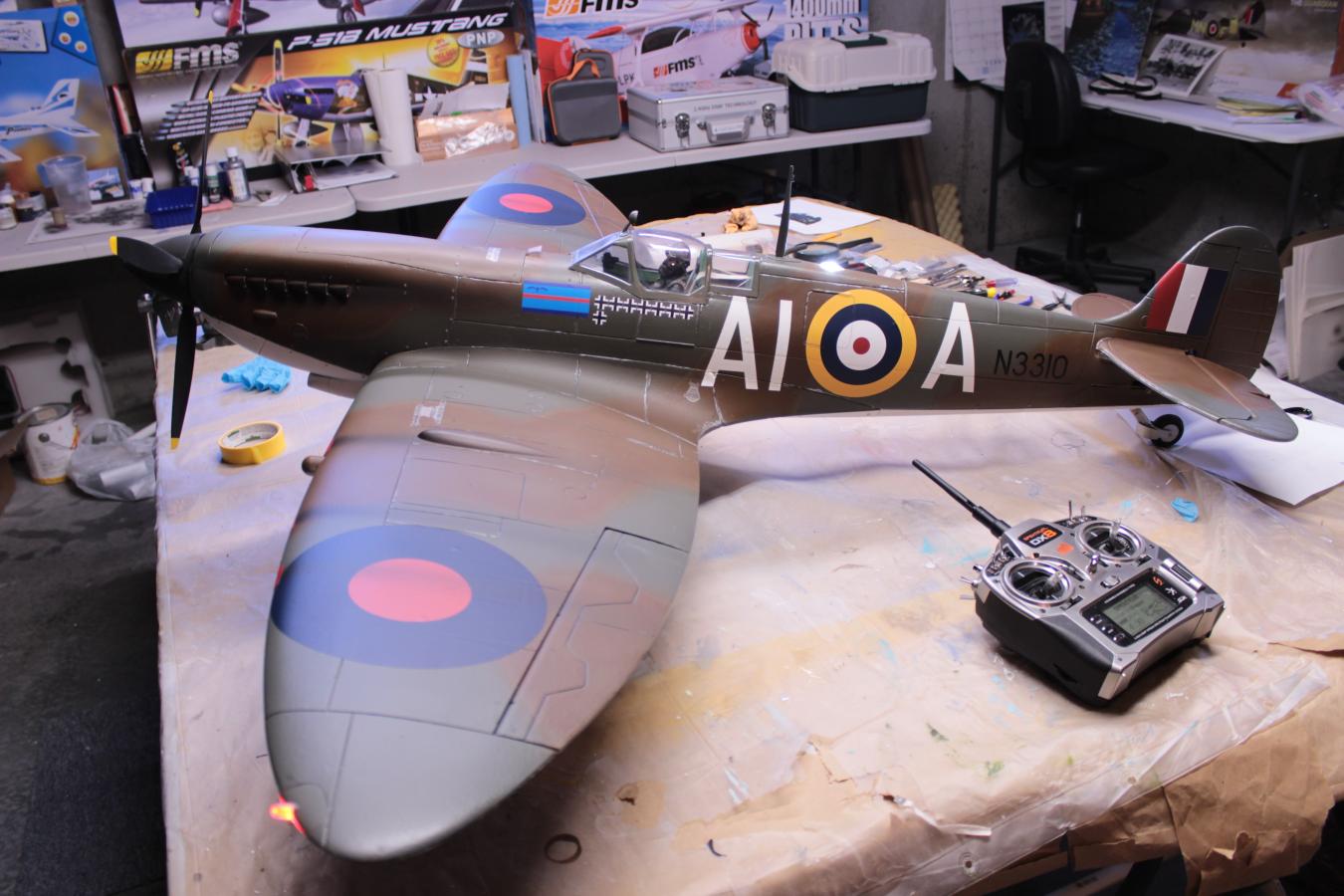

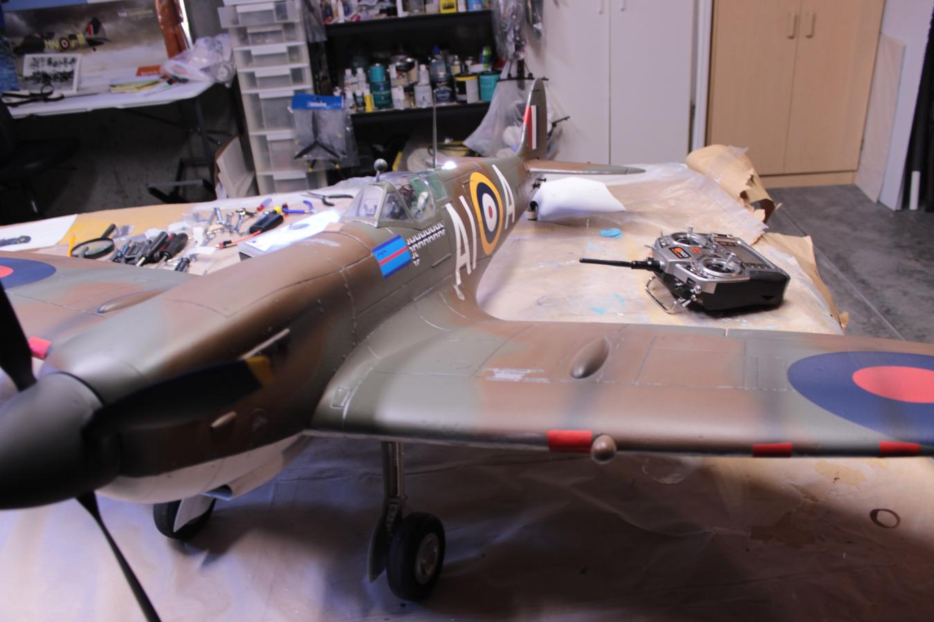

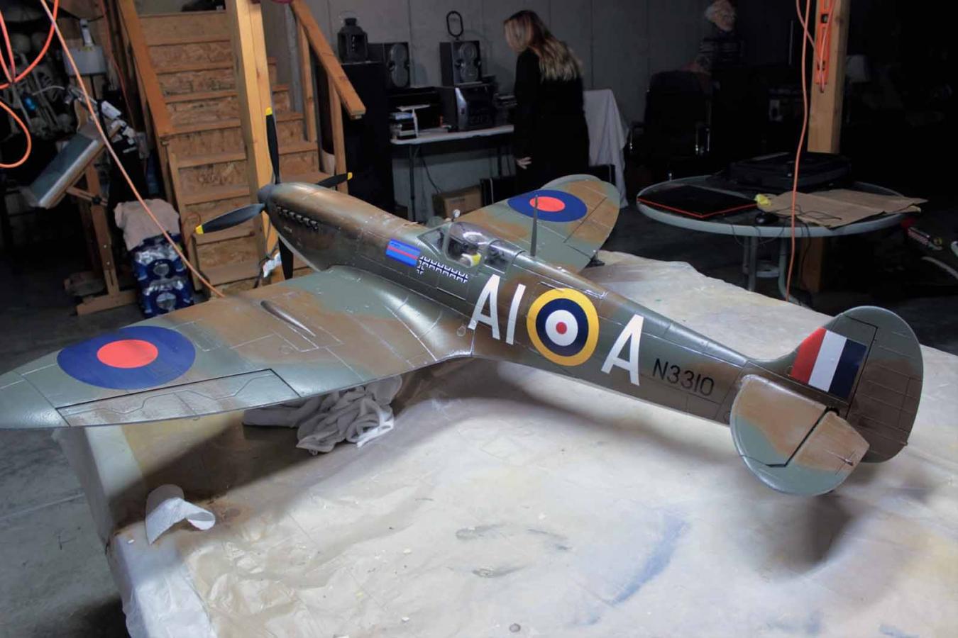

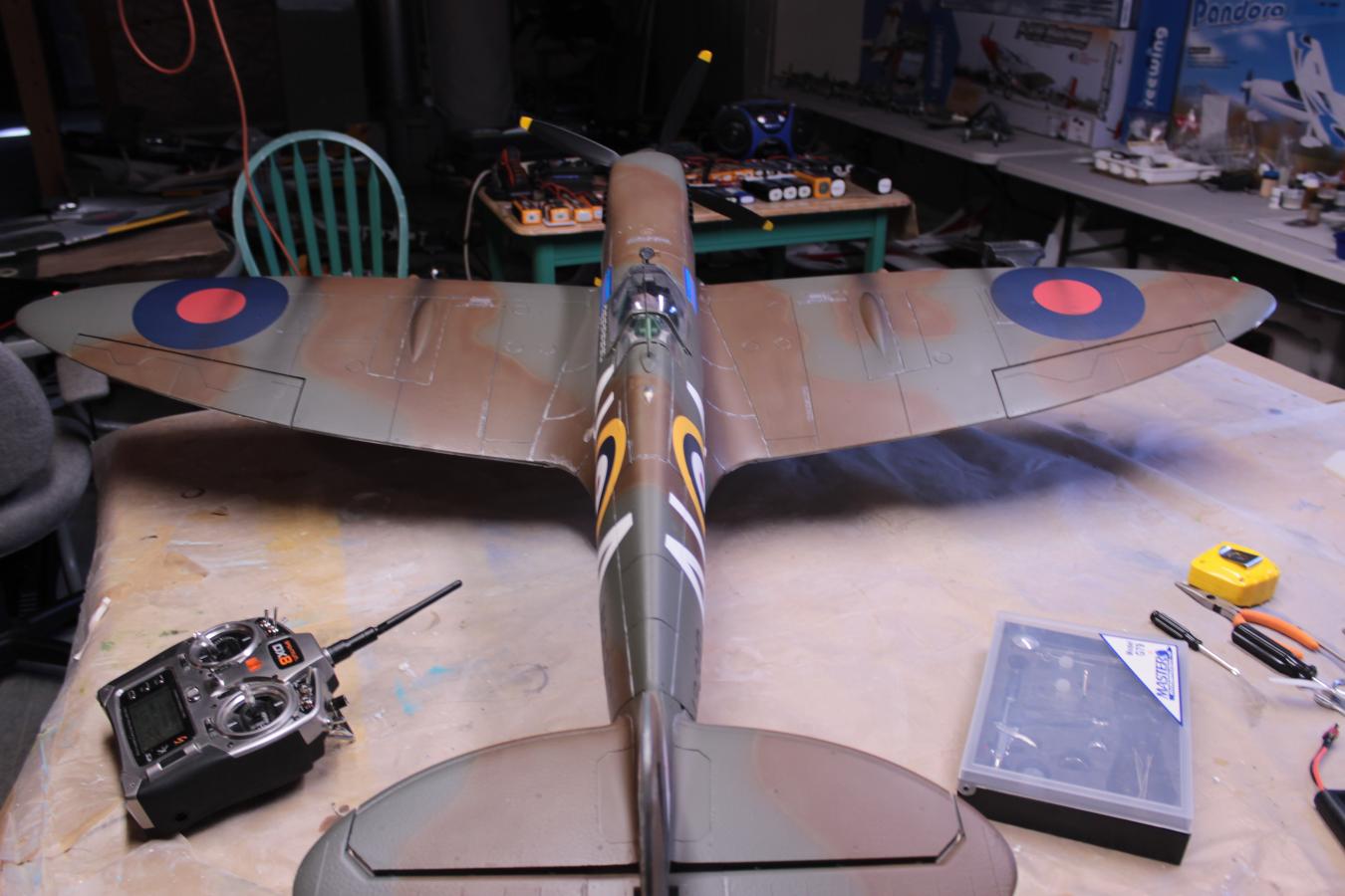

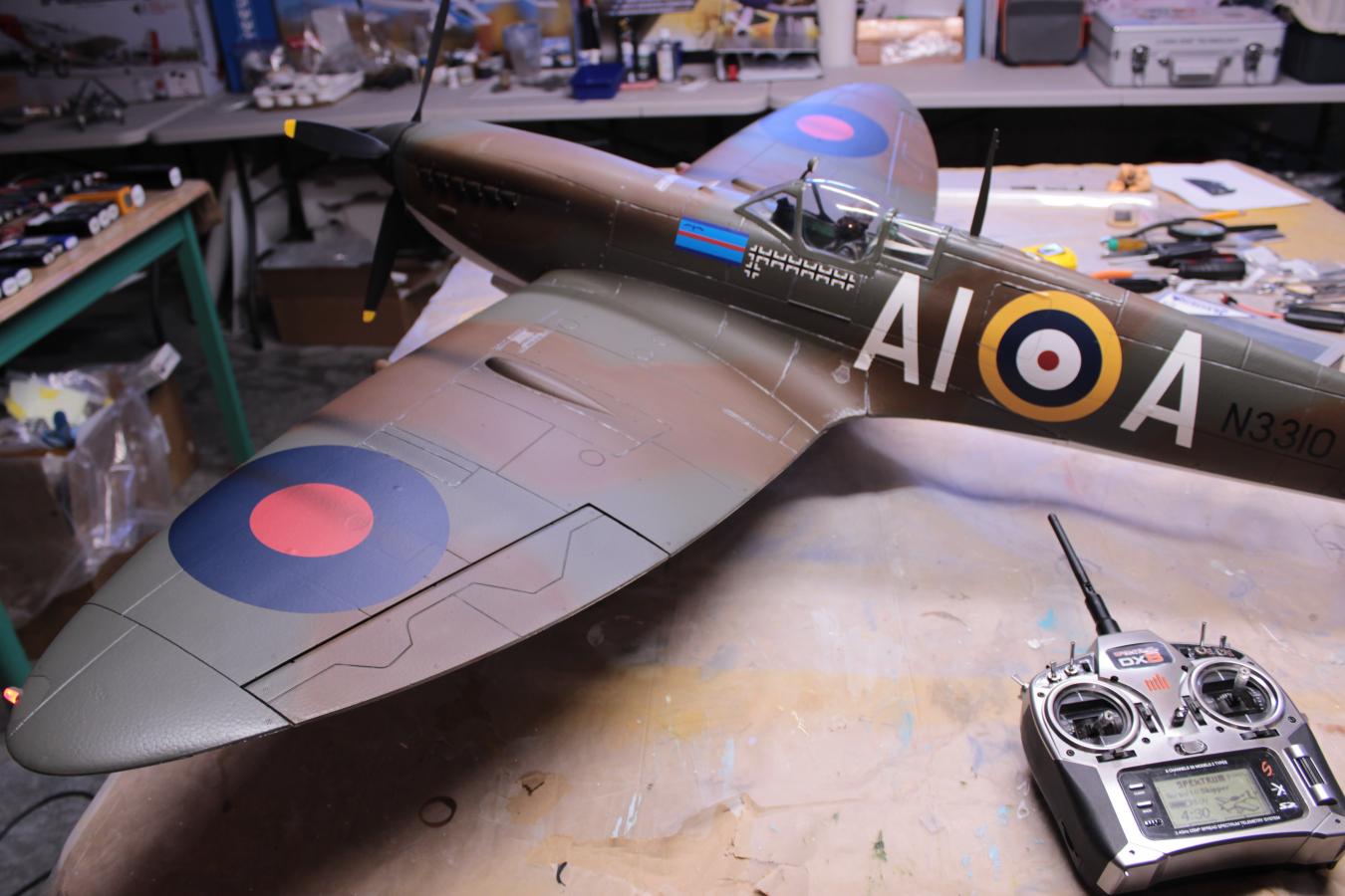

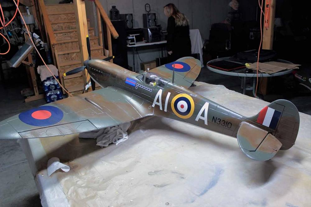

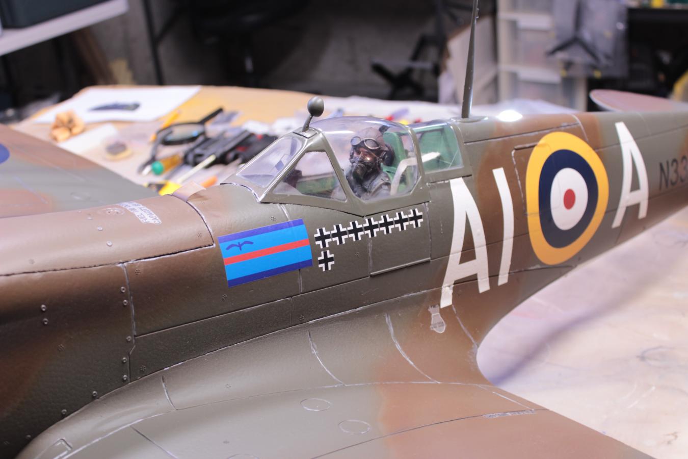

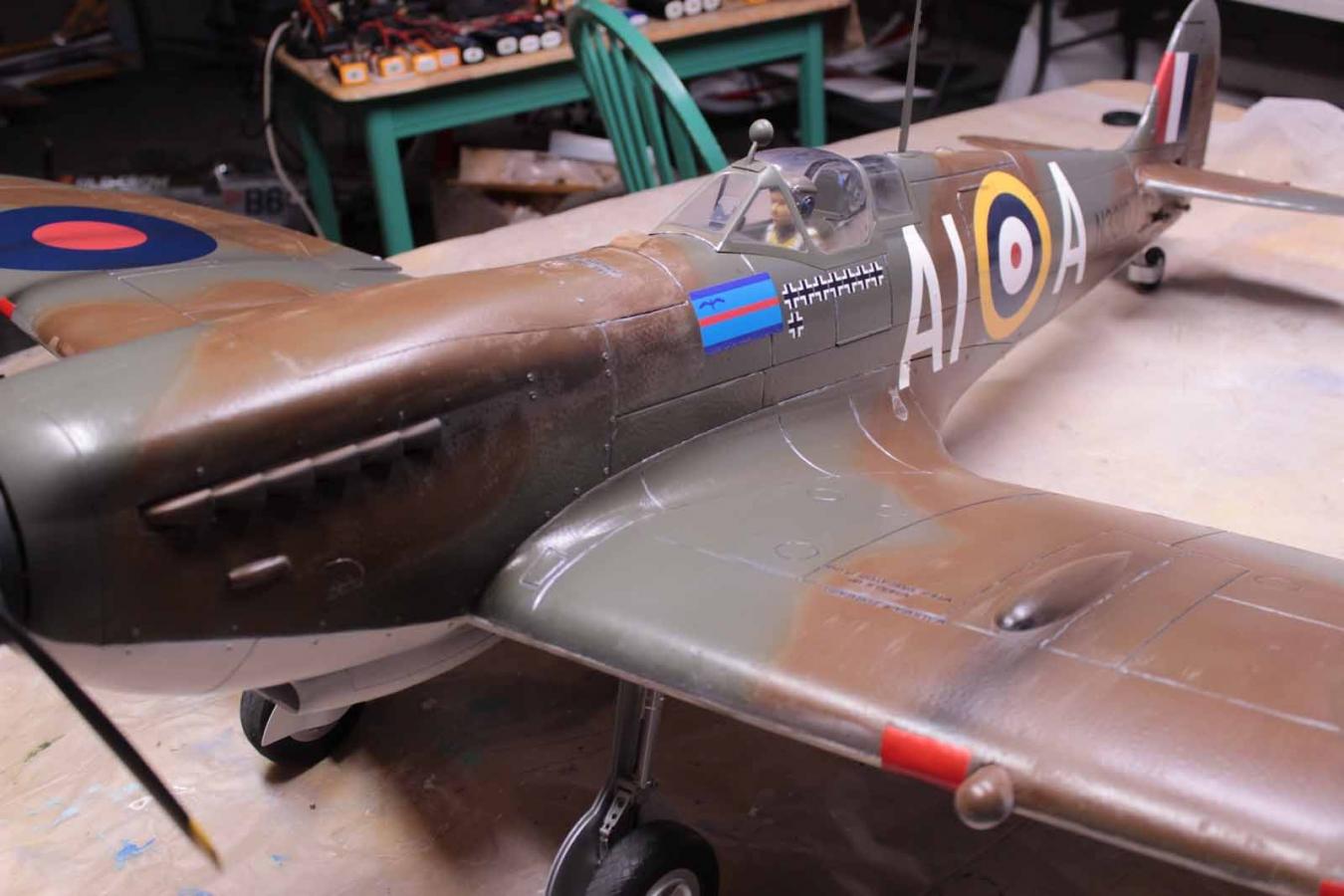

                                  Got three coats on the Spitfire and am happy with the results.....
ID:	119734Click image for larger version
ID:	119735Click image for larger version
ID:	119736Click image for larger version
ID:	119737Click image for larger version
                                  The one thing I'm not thrilled about is the stock nomenclature decals. Best to order them from Callie, see how the stock ones are foggy?
                                  You can see the difference, hopefully, with the Matte finish. Its dulller, of course, but it also helped lighten the brown back up, here's a before shot. Unfortunately, it's beautifully sunny out, but the wind is up, typical Cody, and I don't want any unscheduled take offs, besides, it's colder than H___ as well
