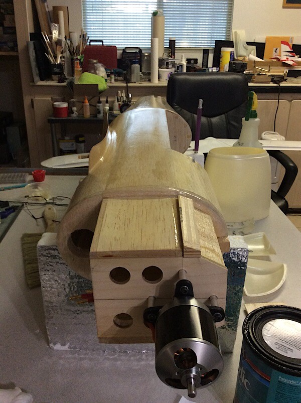

                    Do NOT use steel wool with any water based product, unless you want rusty looking freckles in your finish.
                    No need to waste time with a sprayer - this finish came from a foam brush (disposable) over 0.5 oz fiberglass cloth. I have used the Minwax on my new foam models and brush is the way to go- dries as if sprayed.
