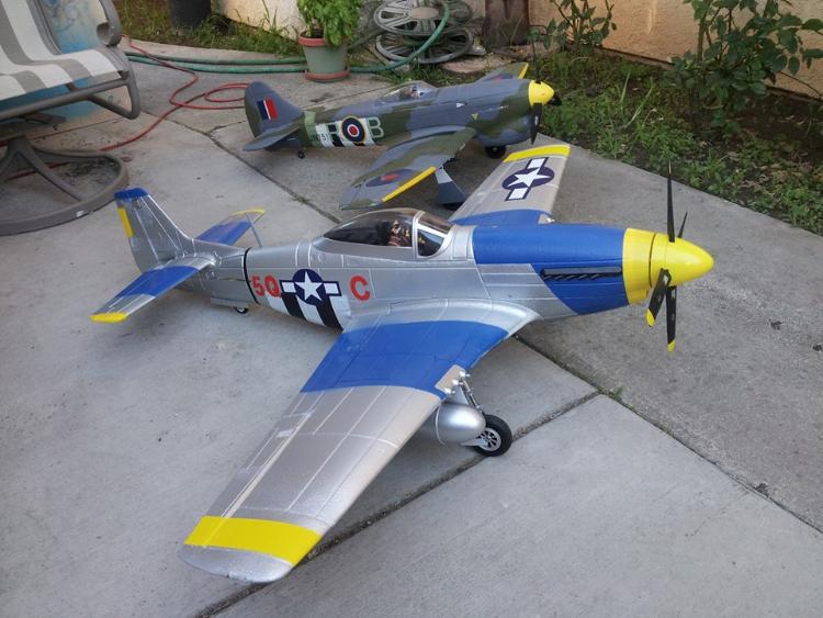

I purchased the FMS 1450 Marie V7
I really have been enjoying this plane although it felt a little underpowered for vertical climbs.
I recently discovered a youtube where the guy added pieces of ziptie under the leading edges of each propeller blade. I tried this modification using a ziptie that was about 1.6mm thick and narrow enough that I was still able to get the screws back through with out the ziptie sticking out from under the blade.
I can tell you that now I get almost unlimited vertical and the airspeed has increased by more than a few miles per hour. I am really happy about this mod and believe FMS should investigate some variation in their 14" propeller pitch. the stock is 14x8, I'm not sure how high it is now with the "shims", 14x9? 14x9.5? 14x10?........... What ever it is though, IT ROCKS!!!!!!!!!!!!!
FMS 1450 P-51
Stock 4250-540kv motor
Stock 14x8-4 blade prop (modded)
(4s) 14.8v 3000mah 30-40C Lipo
Before Prop Mod, Watt Meter showed 50A 720W with 4s 30-40C
After Prop Mod, watt Meter showed 56A 820W with 4s 30-40C

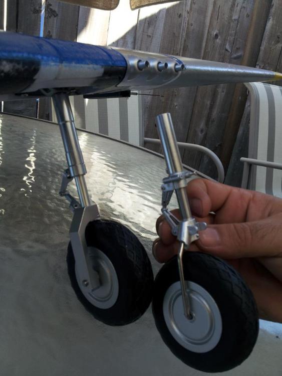

Another Mod I made to this plane was to get a different sequencer and a servo reverser from hobbyking, each was about $4 and now my gear doors close after the gear is down so I won't have to worry about them dragging in the tall grass where I land.
FMS 1450 P-51
