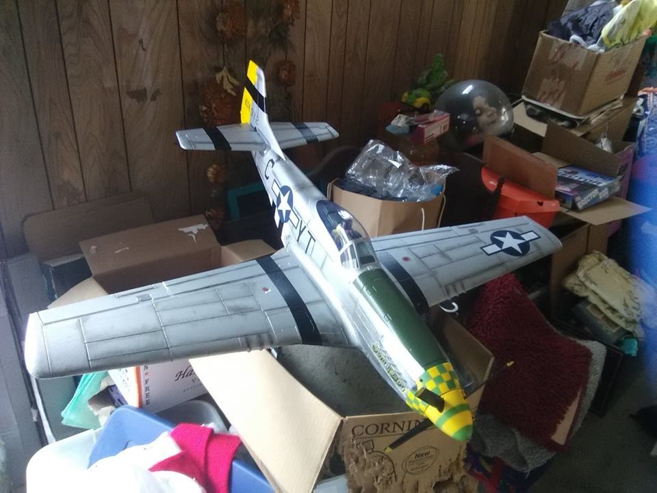

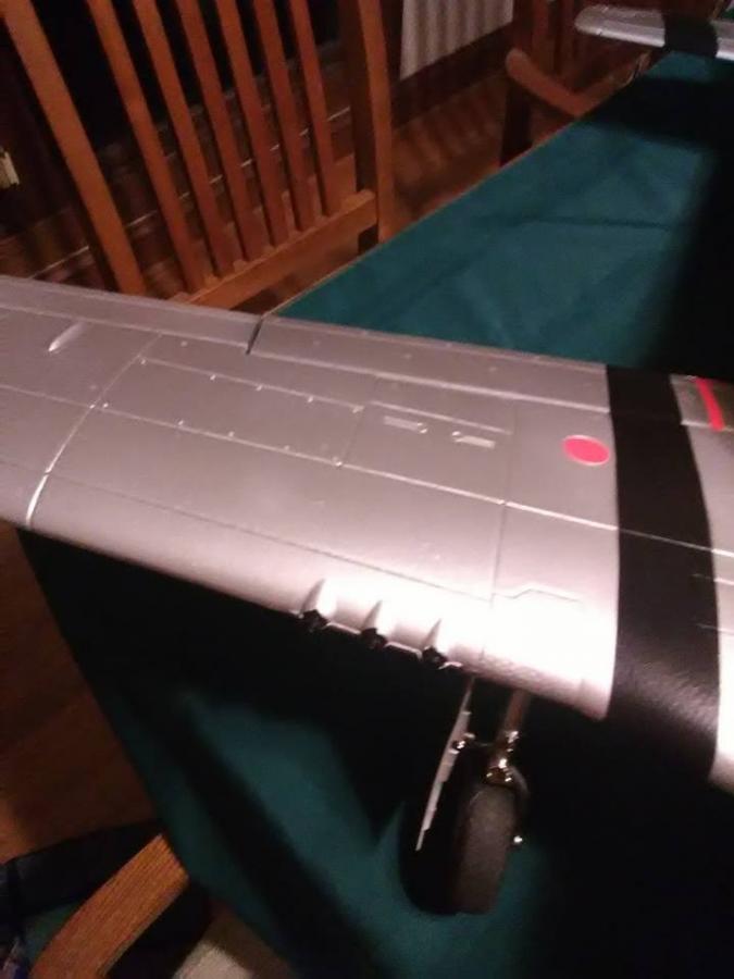

            Got home from school a few hours ago and spent a few minutes with a Charcoal crayon trying my hand at making some weathering marks. They look better in person - from really far away....The exhaust stains are getting better with more layers - and adding directional flow.
            I could see where a liquid application would be easier. The crayon is very soft - and I am using my fingers to work it onto the surface.
            I think it really ages the surface when compared to the original wing.
            It will be a progressive process! I enjoy it, too.

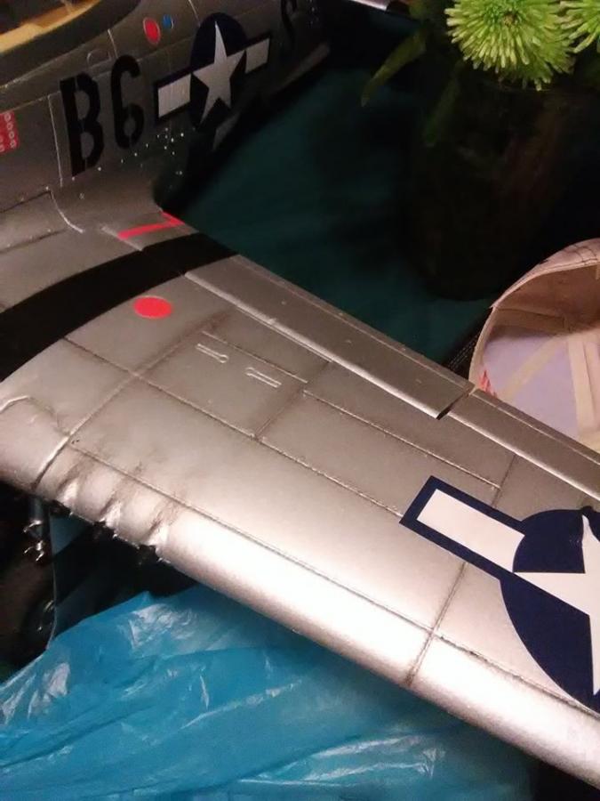

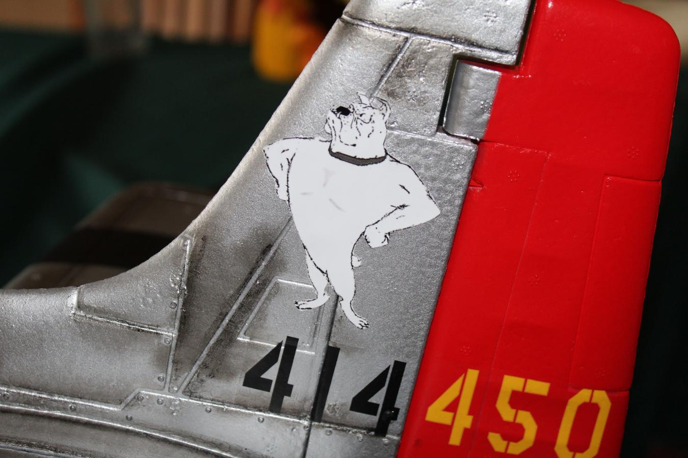

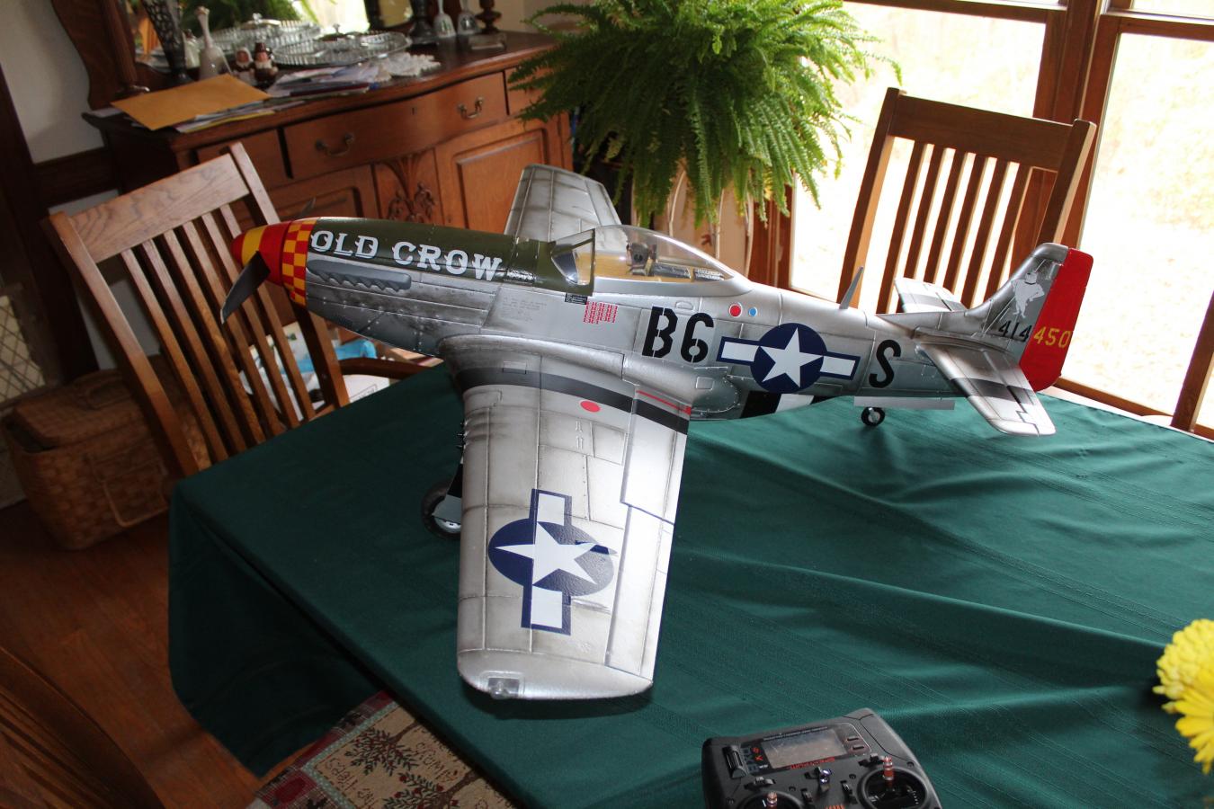

                Here's some better shots today after I did the other side. Looks more like the pre-cursor to full weathering - which I am happy with, considering it's a new - to - me plane. Maybe if it makes it a few years I can go all out and really get it detailed. I am content with him now.
                You've noticed my picture by now - maybe - of our beloved girl, Boo Boo - an English Bulldog. I made a sticker with some neat paper I found and printed out some tail art.....Cute. Had to be careful not to get any smudges on those...Was a fun little process. Will try other materials and processes in the future.
                Thanks,

                  I'm not entirely pleased with how the exhaust looks - but I believe that to be due to the foam pattern underneath getting more contrast. It doesn't look as natural with those beads showing up so clearly. Maybe after a few more "start ups"....
                    • 4877
                    PA, It looks great. And at 70mph, 6 ft off the ground and 30 ft away it will be outstanding!:Smug: Lots of planes yet to be weathered. Best, LB

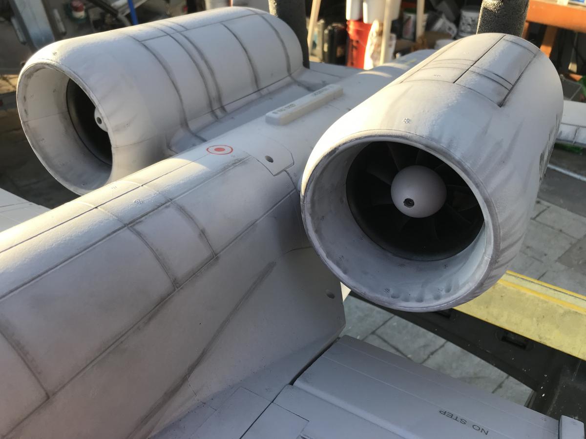

                          Weathering is holding up on her....Flew a bit in the snow yesterday in a slushy parking lot - lots of water spraying around...
                          Went ahead and did the same job to my little fella
                          It's not a excellent show job - but it's quick, cheap, and makes a point....No fuss
                          Looks pretty awesome in a fly-by as well.....

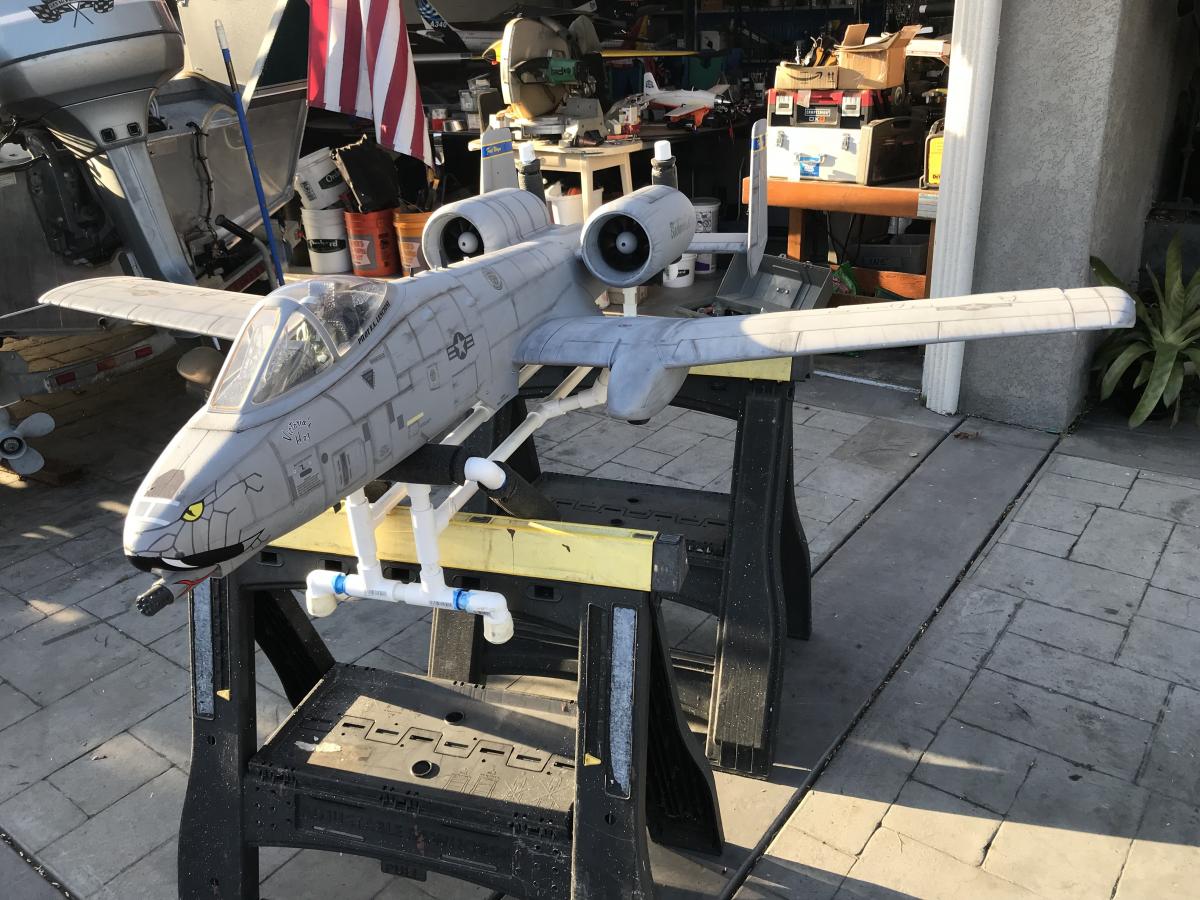

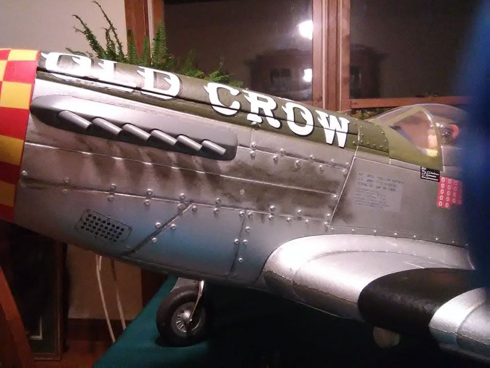

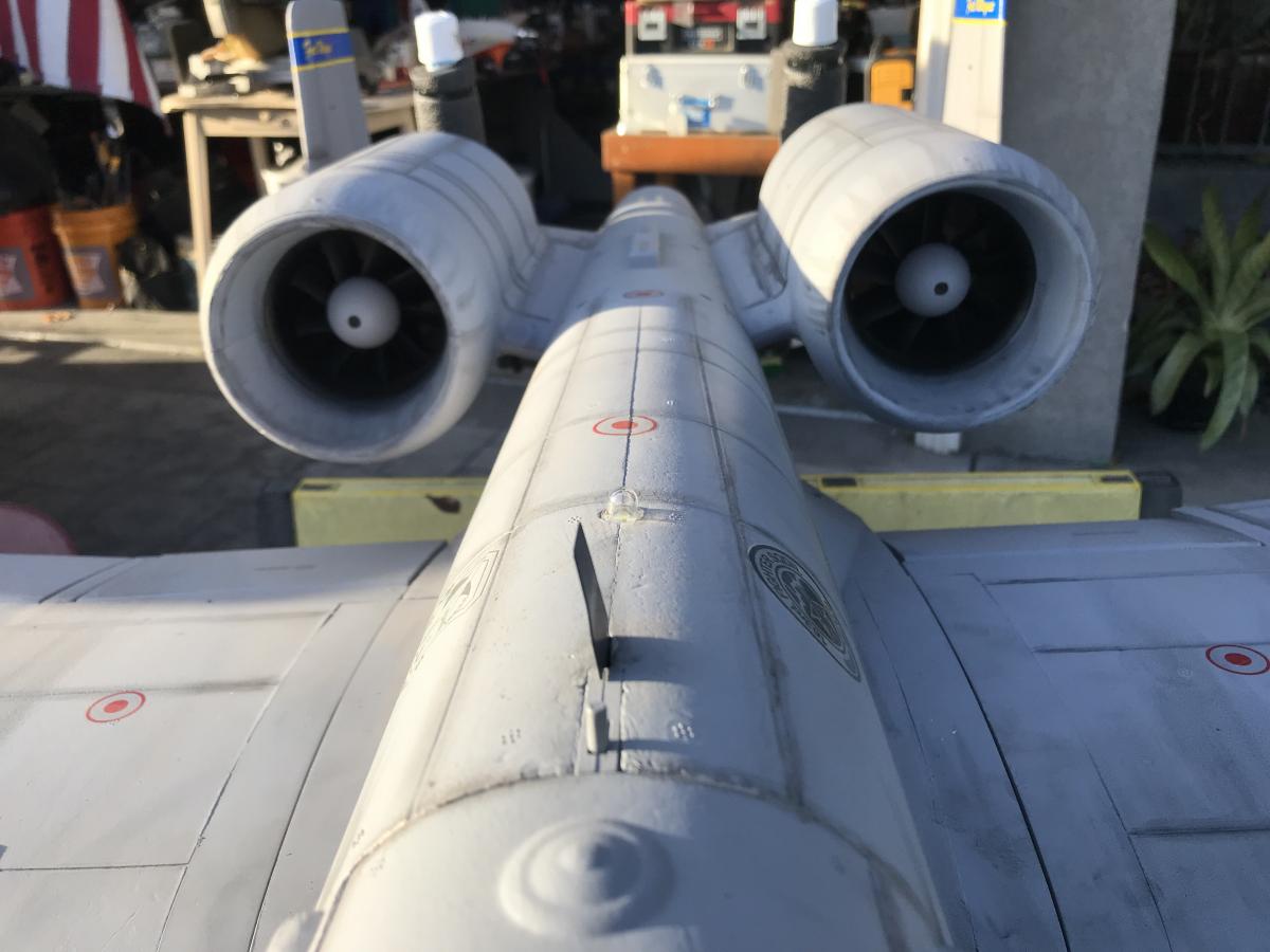

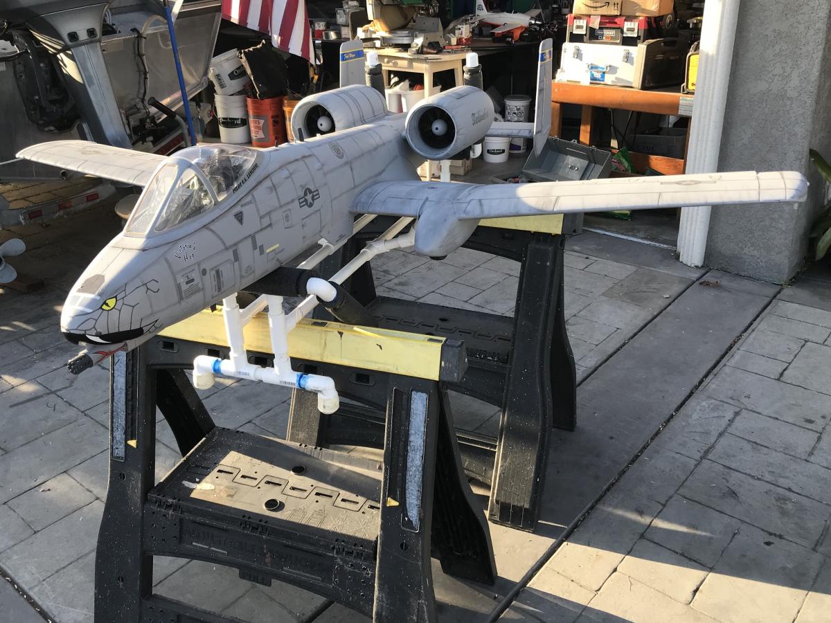

                              Everyone has a different method I suppose, I prefer compressed charcoal and pastels. You can go as light or as heavy as you want, and can really achieve some incredible results very rapidly. Paper towels can be used to streak, and different colors simulate rust and other things.

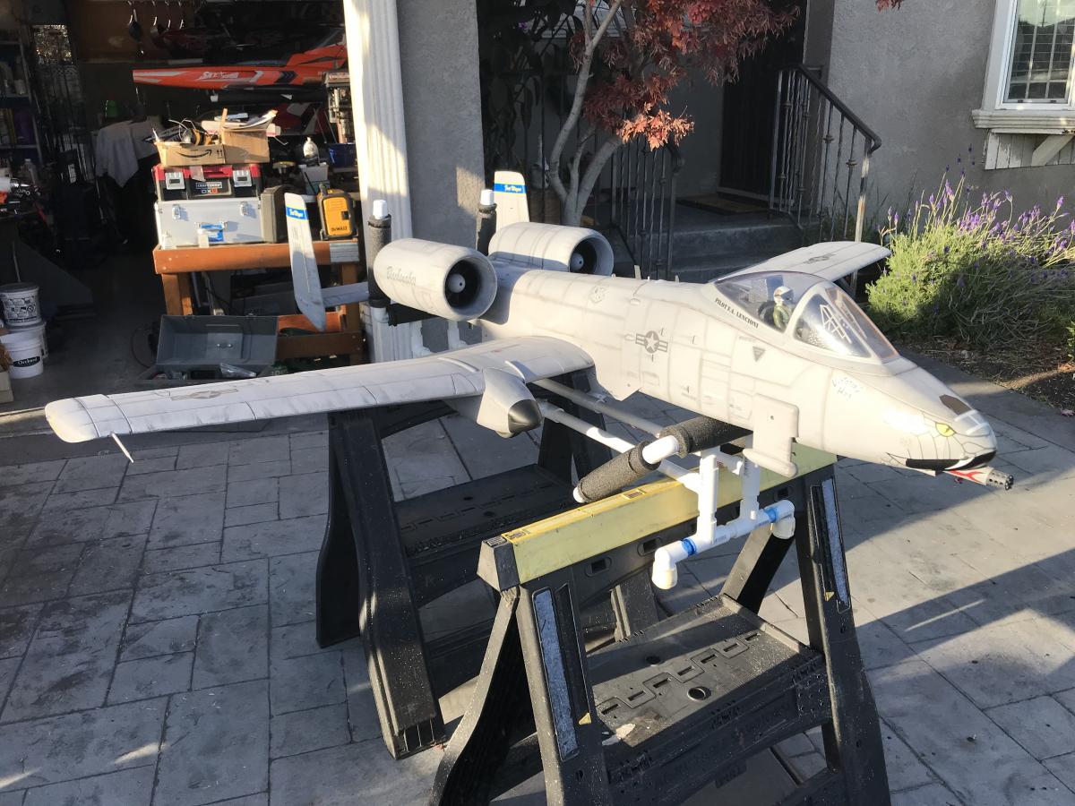

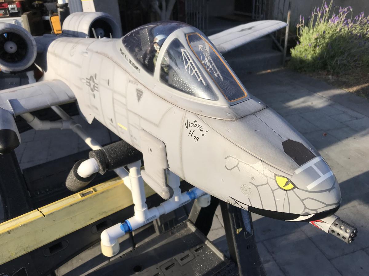

ID:	189676Click image for larger version
ID:	189675Click image for larger version
ID:	189674Click image for larger version
ID:	189673Click image for larger version
ID:	189672Click image for larger version
ID:	189671Click image for larger version

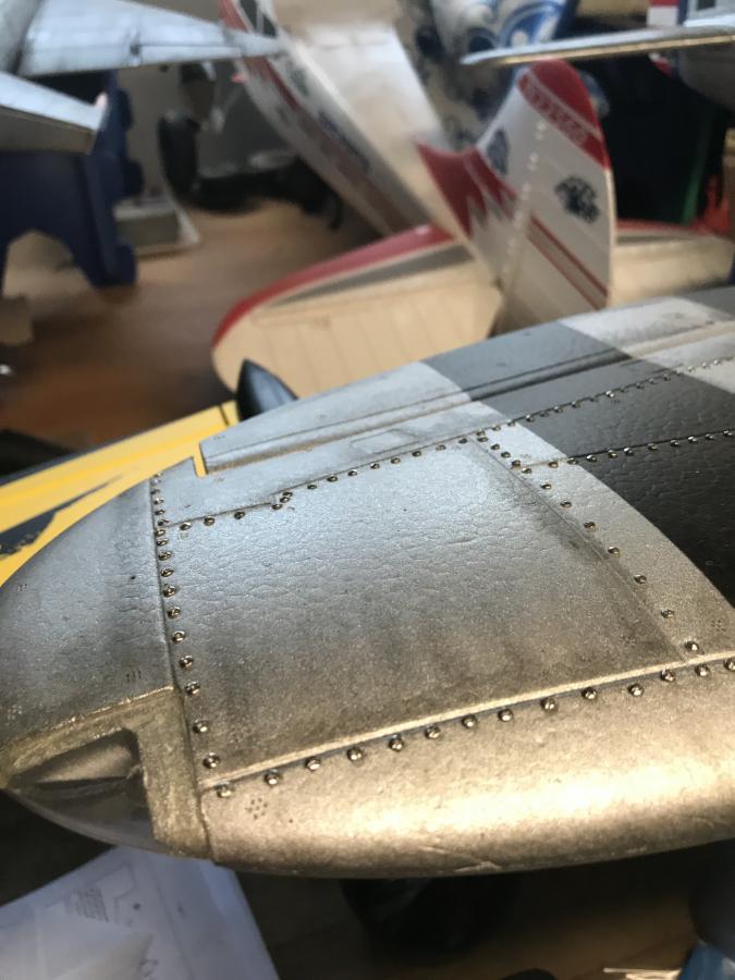

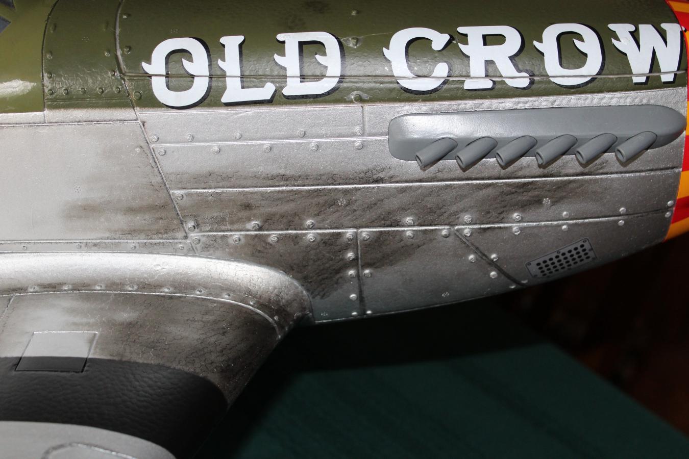

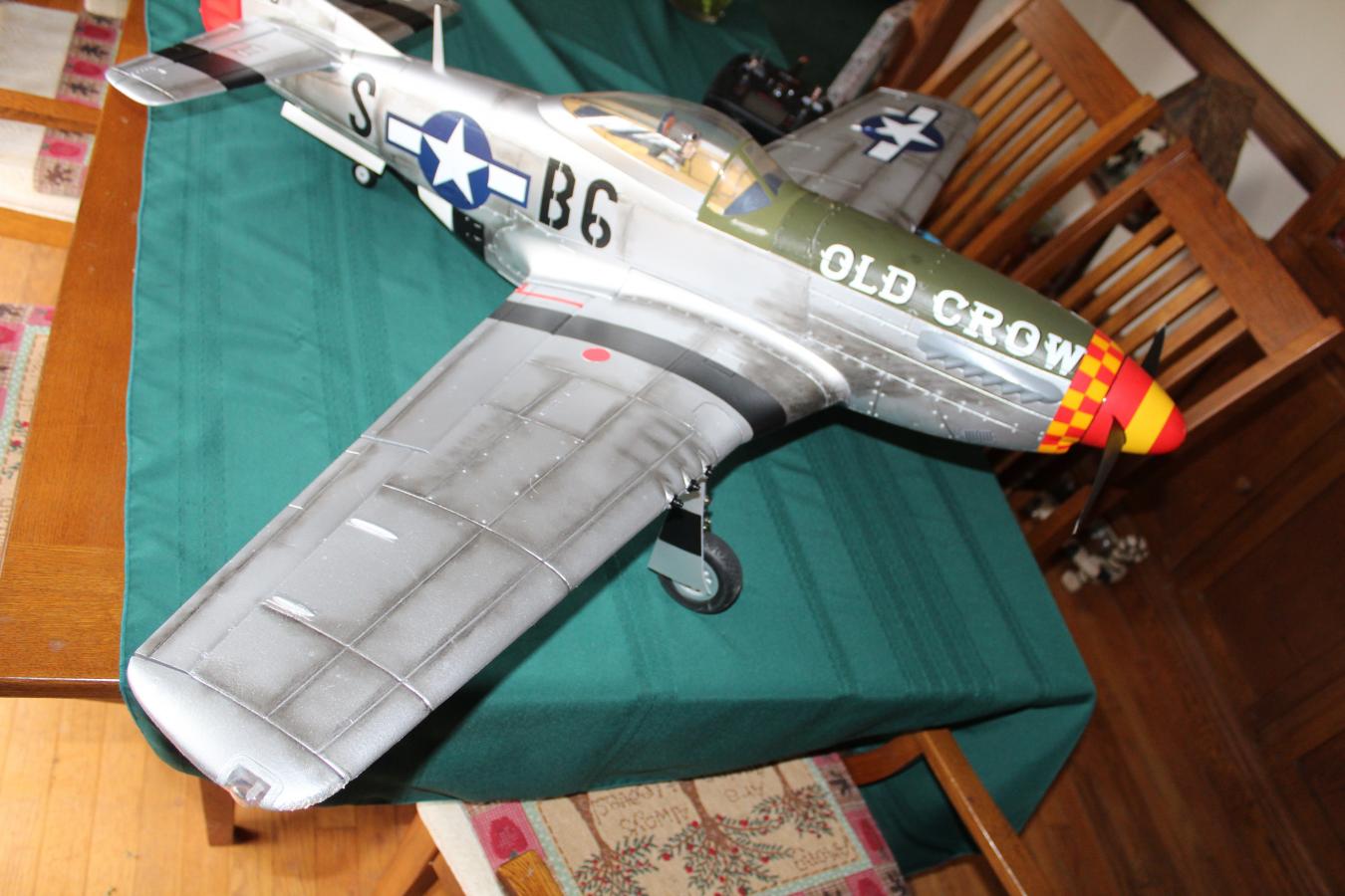

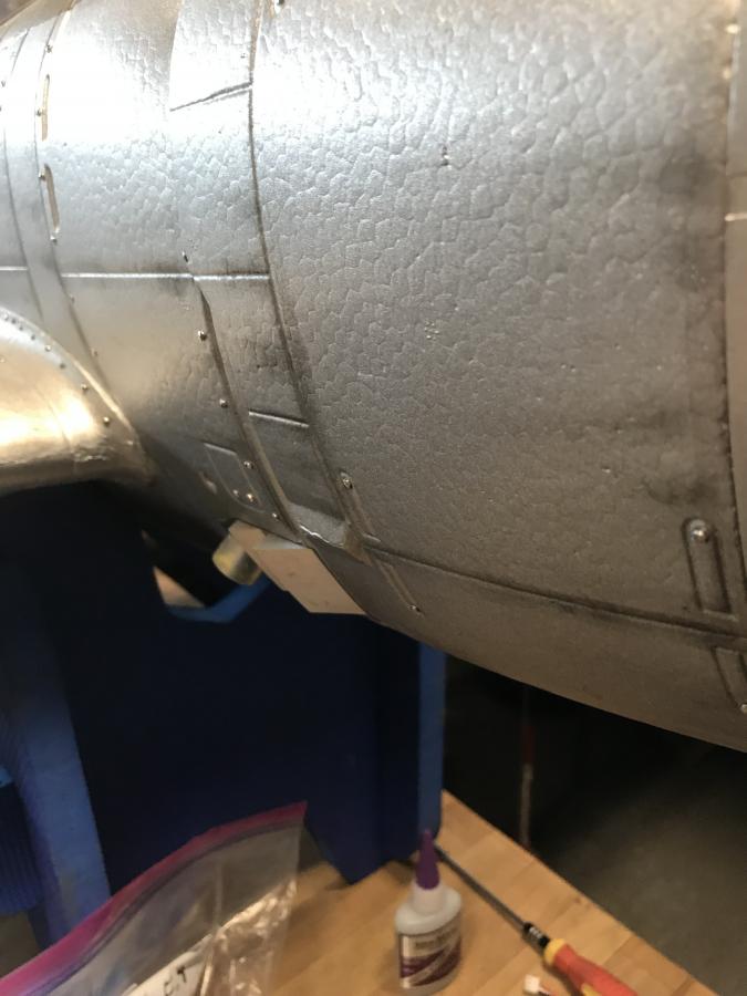

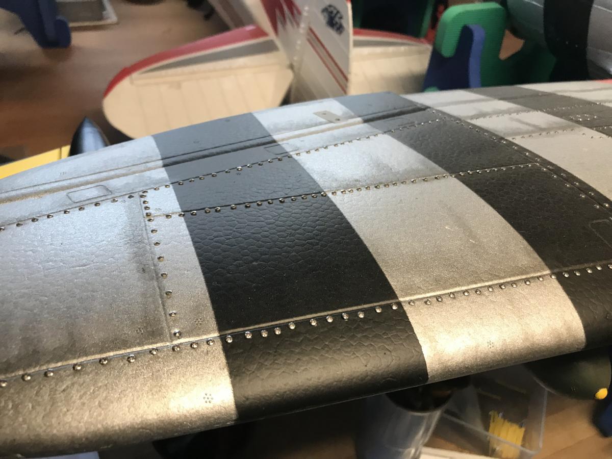

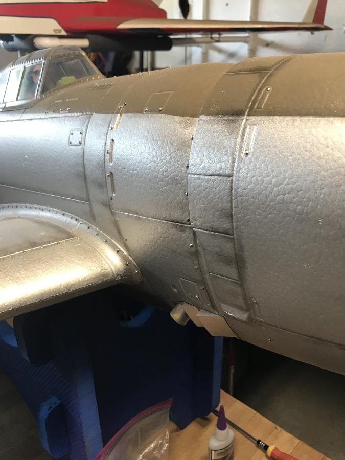

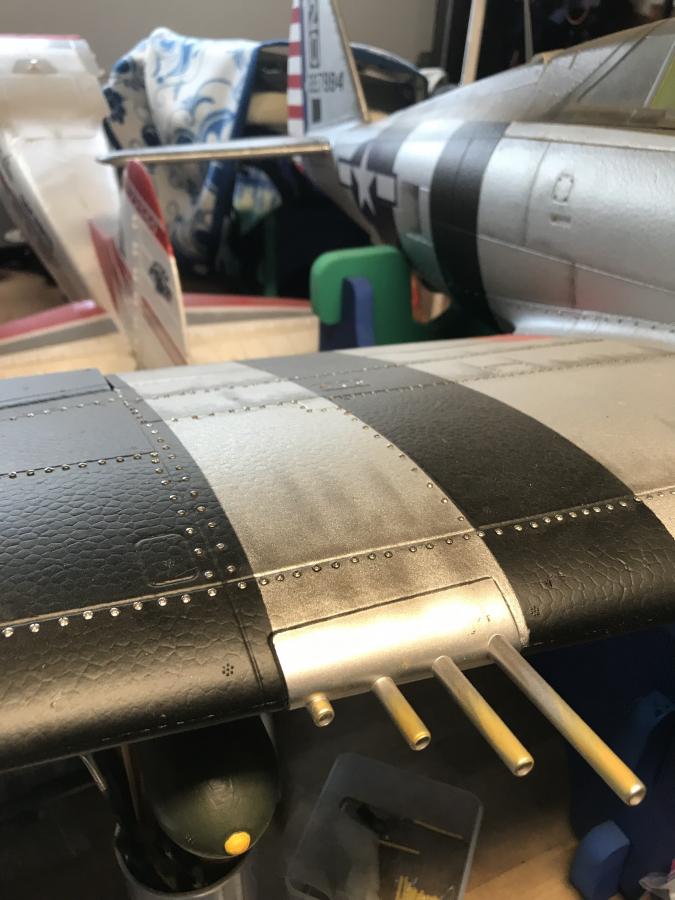

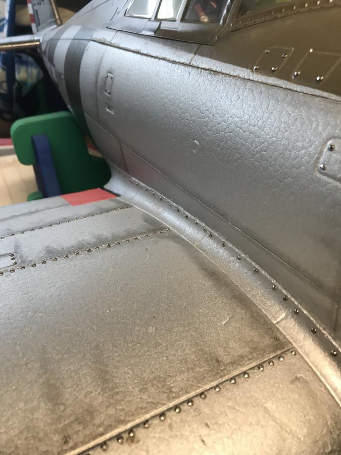

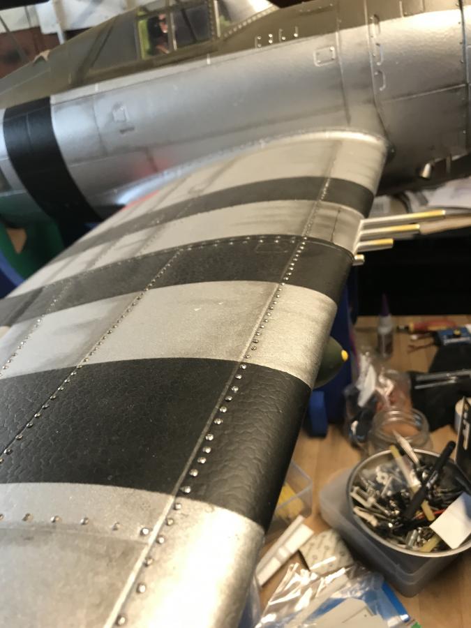

                                  #17
                                  P-47 Weathering and rivet detail. Click image for larger version
ID:	189678Click image for larger version
ID:	189679Click image for larger version
ID:	189680Click image for larger version
ID:	189681Click image for larger version
ID:	189682Click image for larger version
ID:	189685Click image for larger version
ID:	189684Click image for larger version
                                    • 4877
                                    #18
                                    44, Again, fantastic work. :Win: Bravo Zulu. Are you using oil pastels? Best, LB
                                    • lmramos44
                                      Jet Pilot
                                      • Mar 2014
                                      • 199
                                      • San Leandro, Ca.
                                      #19
                                      Thanks Again. I use Tamiya Weathering pastels, Airbrush, Charcol stick and the rivets I purchase on eBay...for a look of peeling paint, I will use either aluminum or silver leafing.

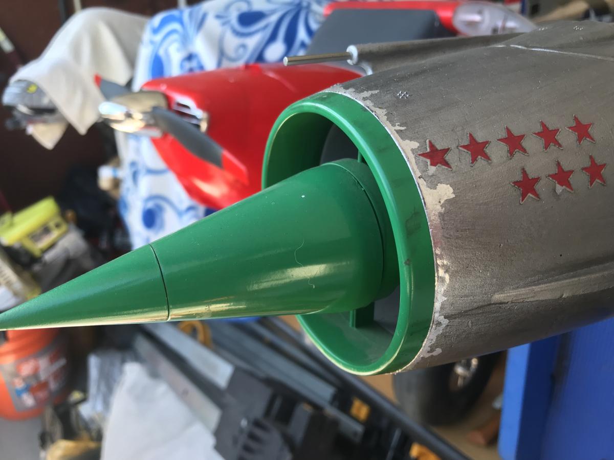

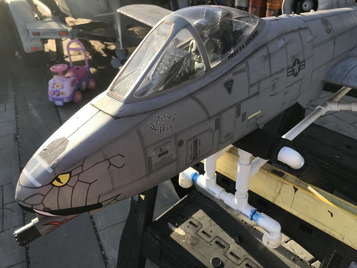

                                        #20
                                        Example of peeling finish on my Mig
