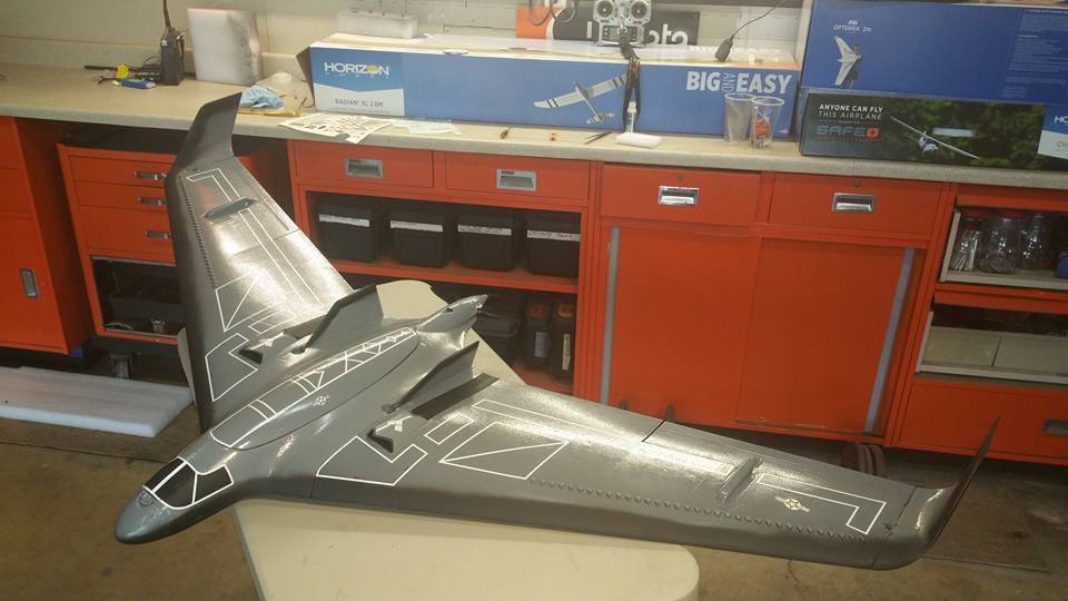

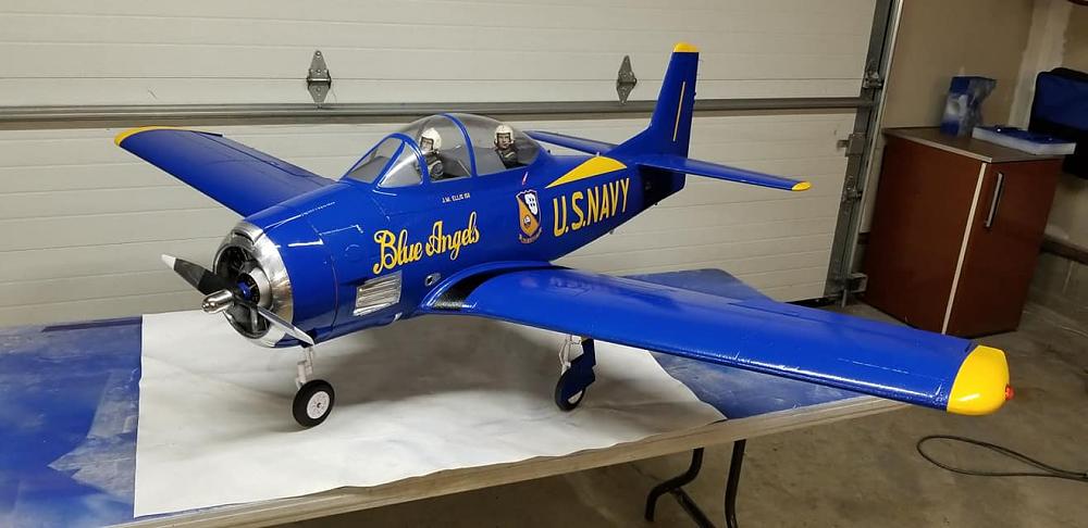

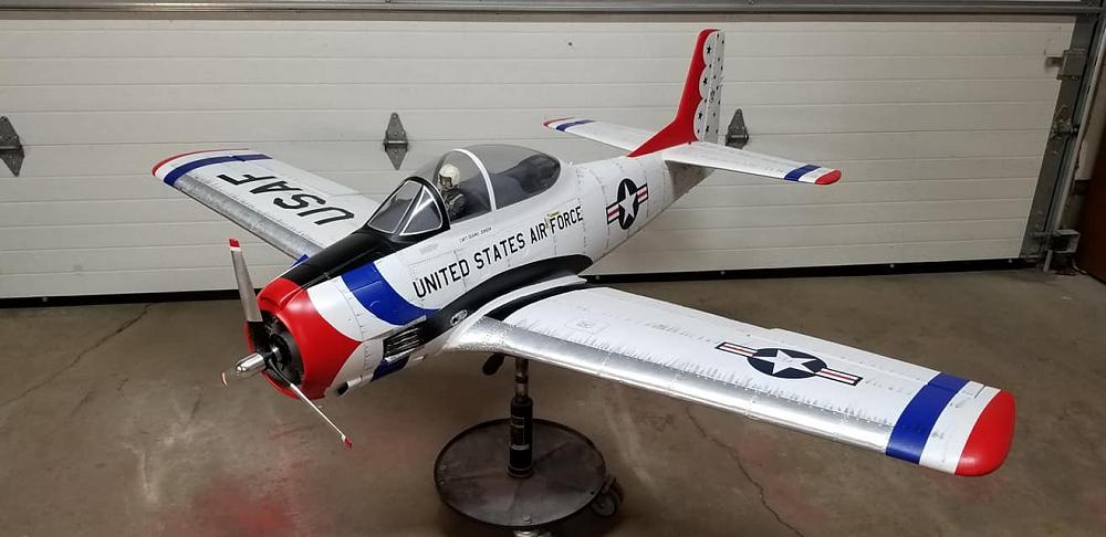

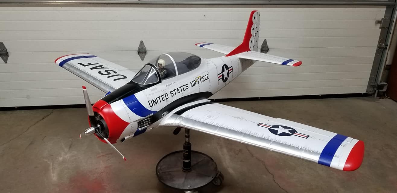

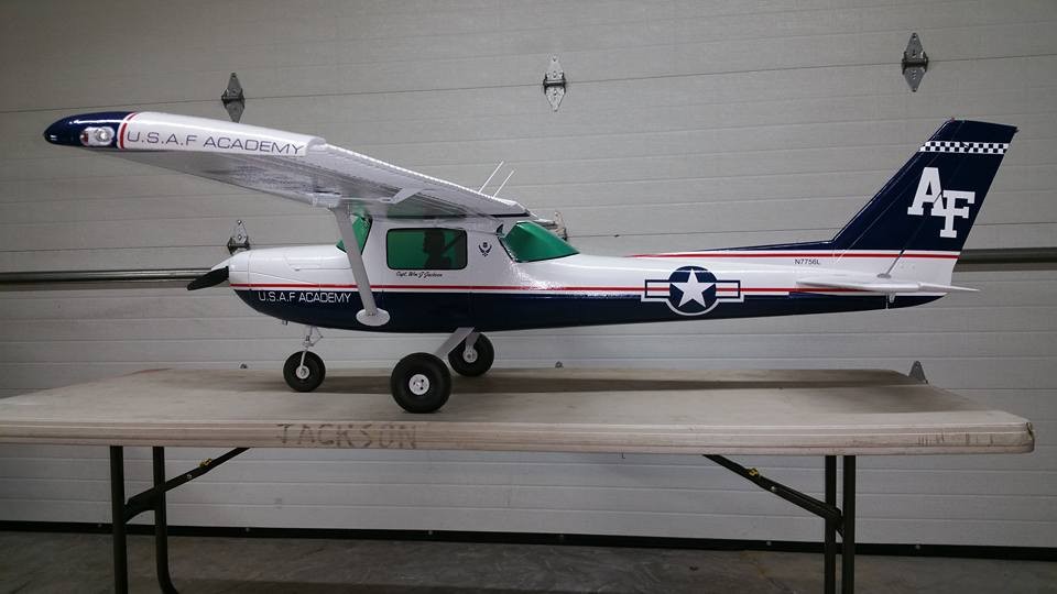

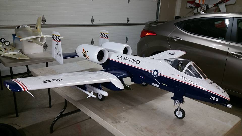

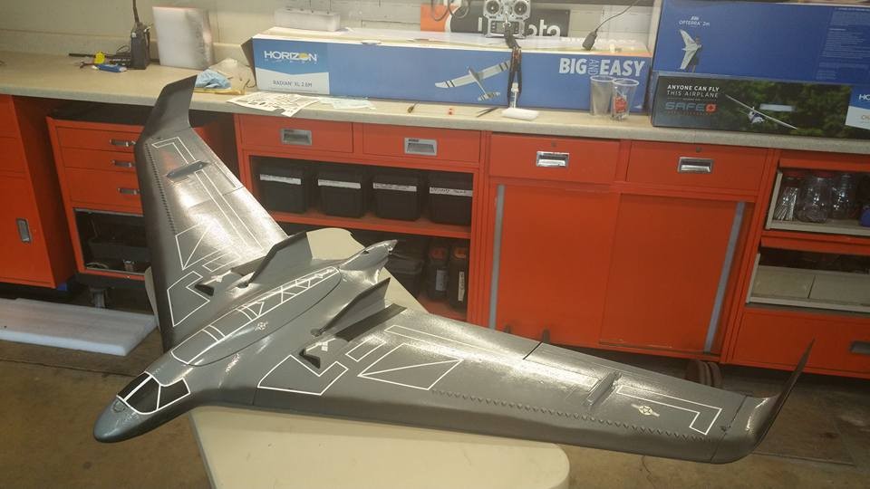

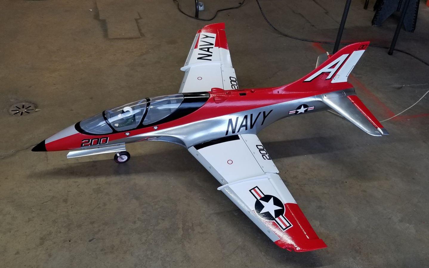

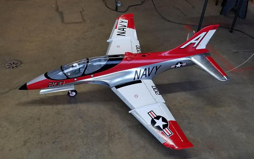

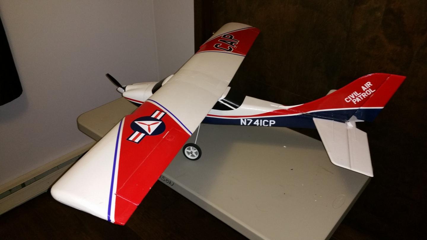

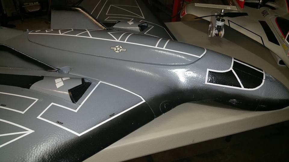

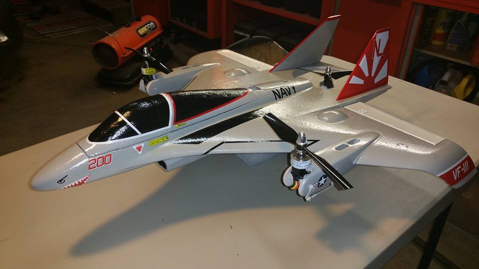

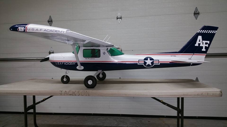

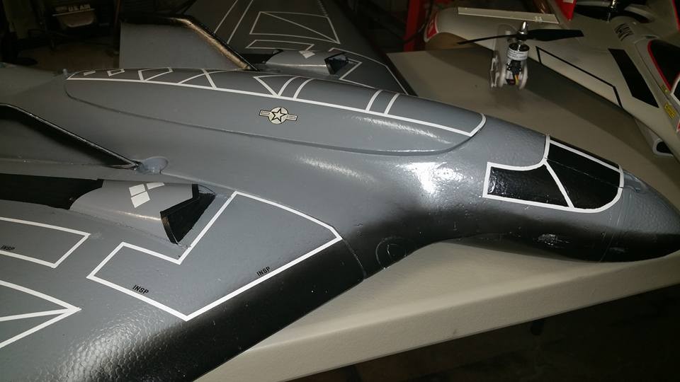

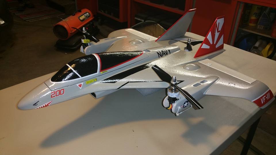

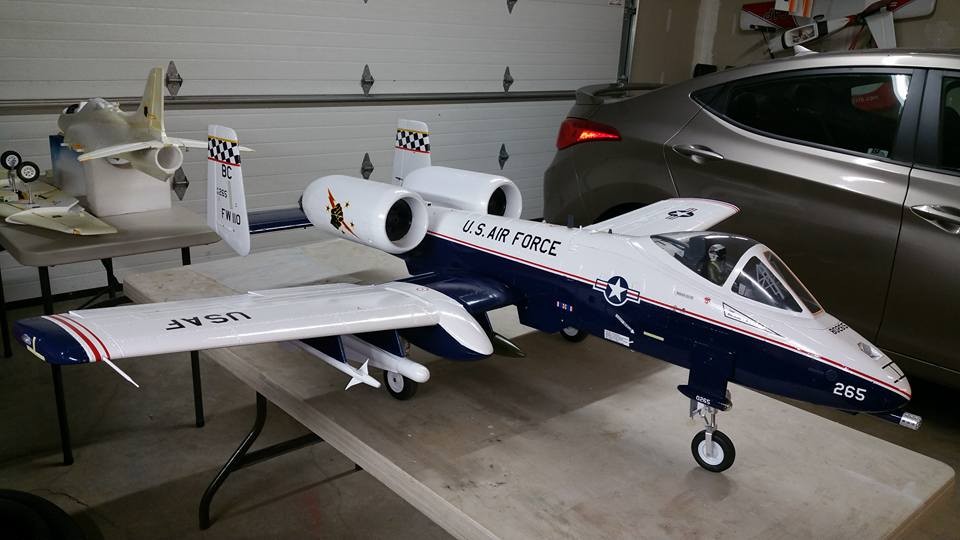

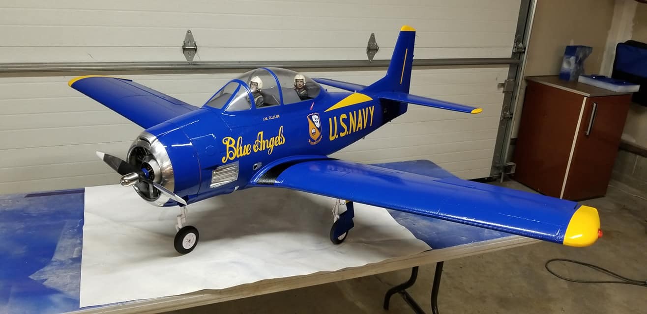

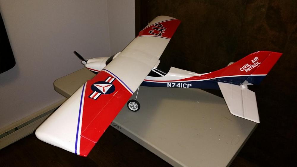

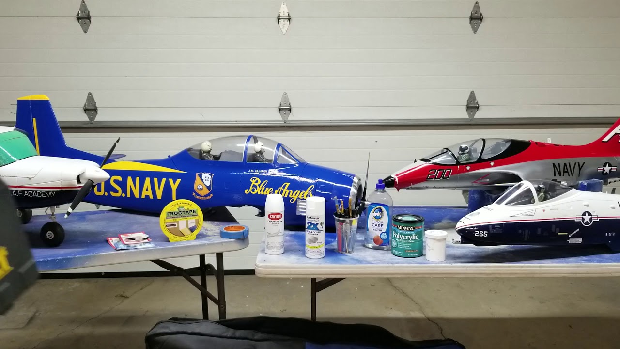

    This is a look back over the last two years of learning how to paint a foam airplane. I will leave out all of the mistakes parts to spare you.
    My First project for a kid that I taught to fly, who crashed ,so I repaint it.
    All of these planes have a "Minwax" coating base of at least three to six coats. All are painted using Rustoleum 2X paint. All of my graphics are from "Callie Graphics". I find for me the Rustoleum clear coat works best, two to three coats. Yes there was alot of prep after removing the decals , sanding and filling. I use YELLOW "Frog" low tack tape to mask the plane. I also use a heat gun set on low to remove my tape.
    The two T-28 Trojans , are from two civilian planes I found on Goggle.
    Each plane has been a learning experience for me and I try to do different things with the next plane to try new stuff.

                  • icepirate3
                    • 214
                    Those all look great! It certainly shows when you take your time and do it right. Did you notice any performance loss in the A-10 and did you happen to take a before and after weight on any of the larger models? I am thinking of a couple repaints this winter and am curious. Thanks!!
                    • t33jetman
                      • 515
                      Thanks, no difference I noticed in the A10 performance, which was a surprise for me. Maybe I did that one right I don't know, but she flew very well and fast and landing was NO problem for me with this plane. No I don't weigh my planes, I just try to wet sand ALOT to keep my weight down.
