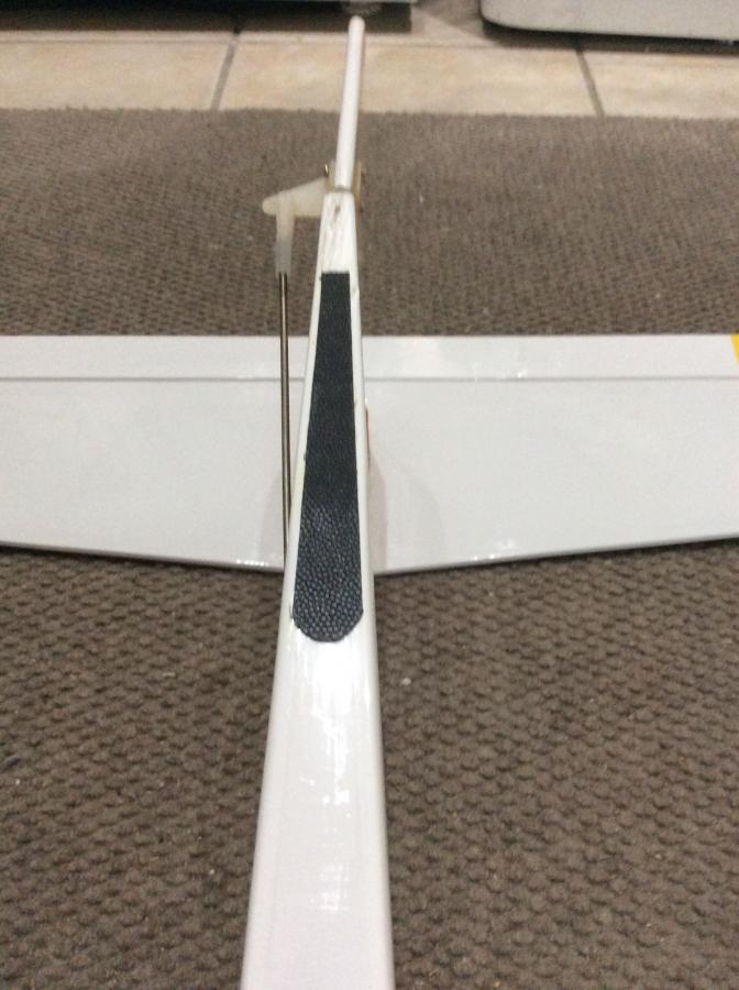

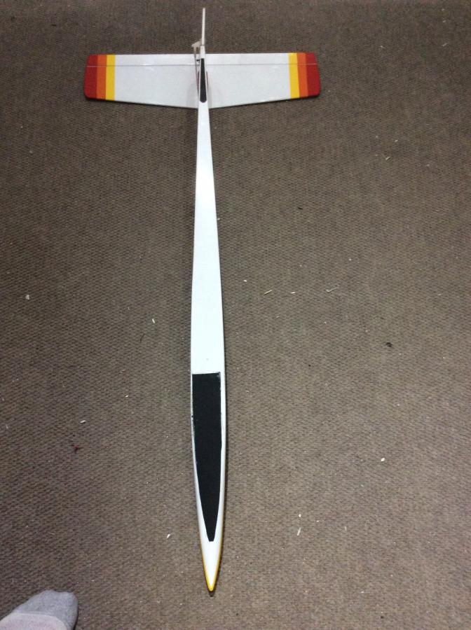

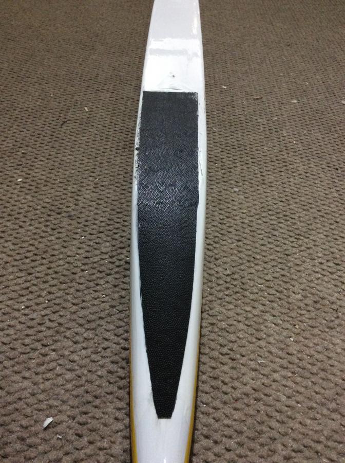

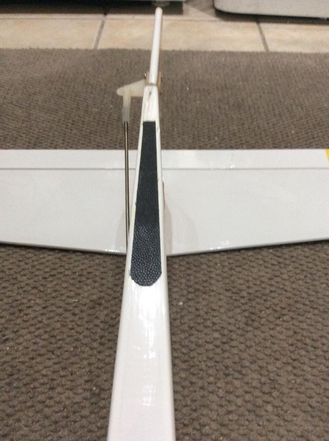

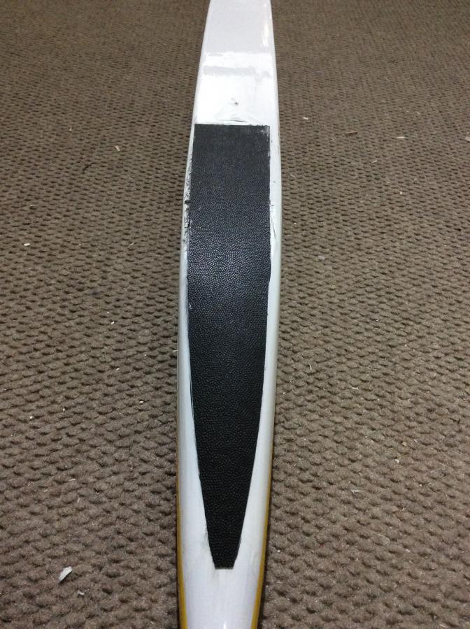

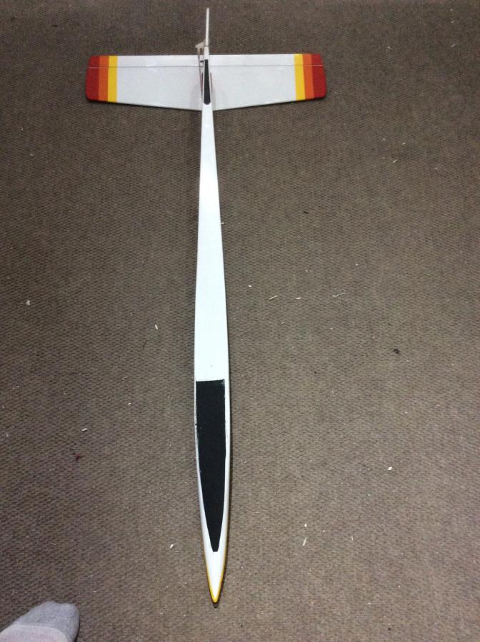

                        I have found those cheap lexan cutting surfaces - they’re like disposable cutting sheets for countertops - can be cut to the desired size and contact cemented to the belly. And they come in some useful colors!

                          CORRECTION...
                          I just realized I stated Lexan but they are polypropylene. I think you get like 6 in a pack at $store.

ID:	186576 This was a polypropylene placemat I used On the Sophisticated Lady. The grainy texture took the contact cement really well. It’s pretty tough stuff!
