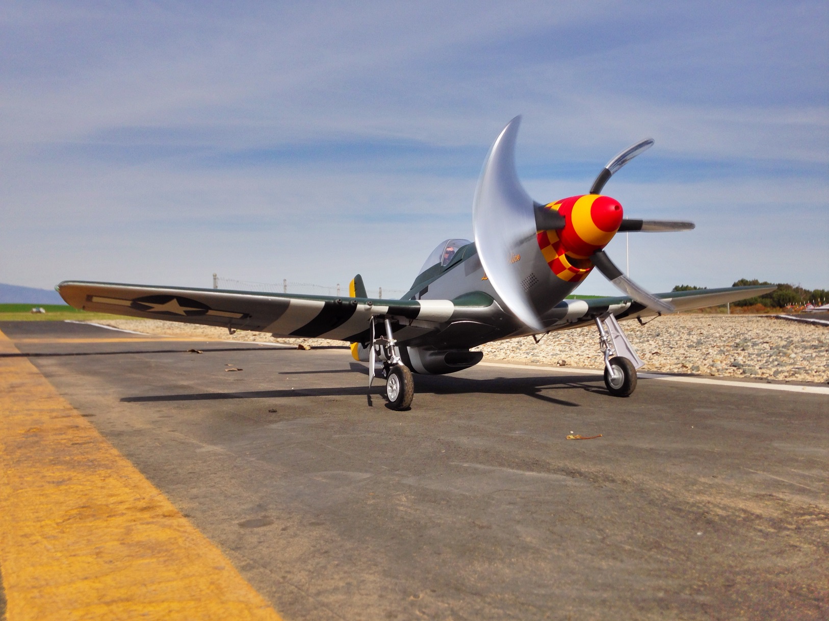

                      Model Master Metalizer paints work well for a buffed surface. Alcad as well, although it is tough to apply durably onto these flexible props. Chris Wolfe recently used chrome monokote to great effect. Scroll down near the bottom.
                      http://thercgeek.com/2015/09/how-to-refinish-a-foam-warbird-ep3-fms-rc-p-51/

                        I have had great success using chrome monocote/ Orocal  1mil material. I cover the front face of the prop, trim close with an exacto knife, and final sand the  leading and trailing edge to remove the rest. then final balance. I have not had one fail yet, and the look of a chrome prop reflecting the sun is pretty sweet.

                          The chrome monokote really does stand out nicely!
