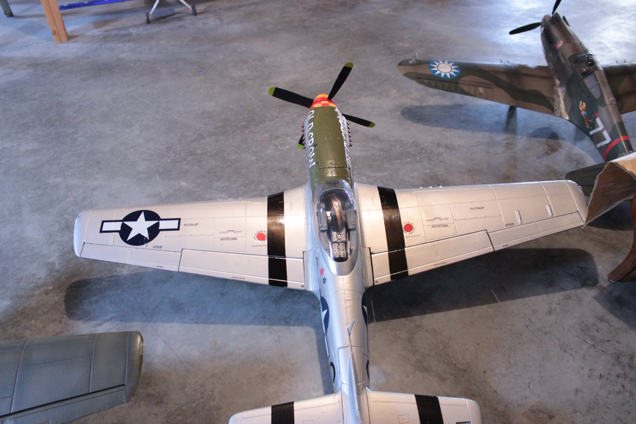

                      Hey Alpha, this is what I used based on Doc's info and recommendations
                      Used it on Old Crows new wings and one coat give it the wet look, beautiful!!
                      I had to use several coats with Minwax, its definitely worth a try and a good call by Doc.
                      Here's a shot of OC's new wings.
