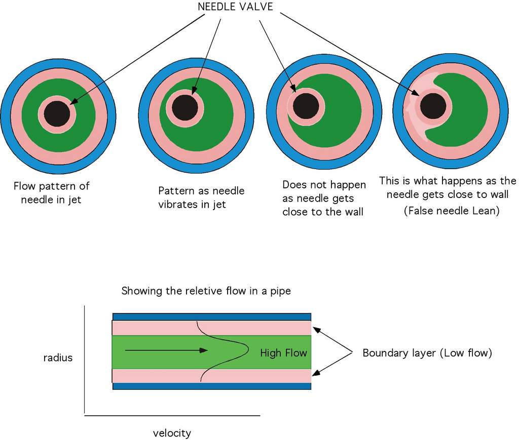

          Please be aware that adding an extension to the needle valve can cause fuel mixture tuning issues. This is because the added overhang can start to vibrate allowing the needle to move around in the jet. If the the needle moves around enough that the boundary layer of the fuel jet and needle interact this will effect the fuel flow rate through. the jet. This phenomenon is known as “false needling” in the high performance engine world or hysteresis in engineering circles.
          It is best not to add the long wire extensions if possible. If you must try to support the end of the wire with a grommet through the cowl that gives a snug fit on the wire. Brazing the head of an allen cap screw is much better as far as the operation of the engine. But it is not considered safe to use tools around a running engine. Finding the lean reversal point can be a pain if one does not use a running engine to find it. You should use a tach and record the readings and needle positions to find the lean reversal point. Barring that be very carful with any tools around a running engine.
