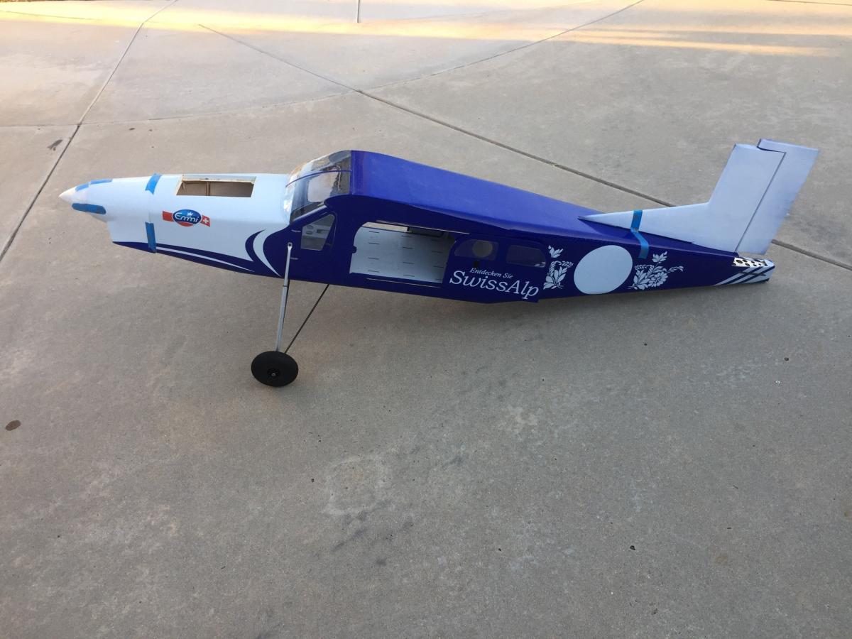

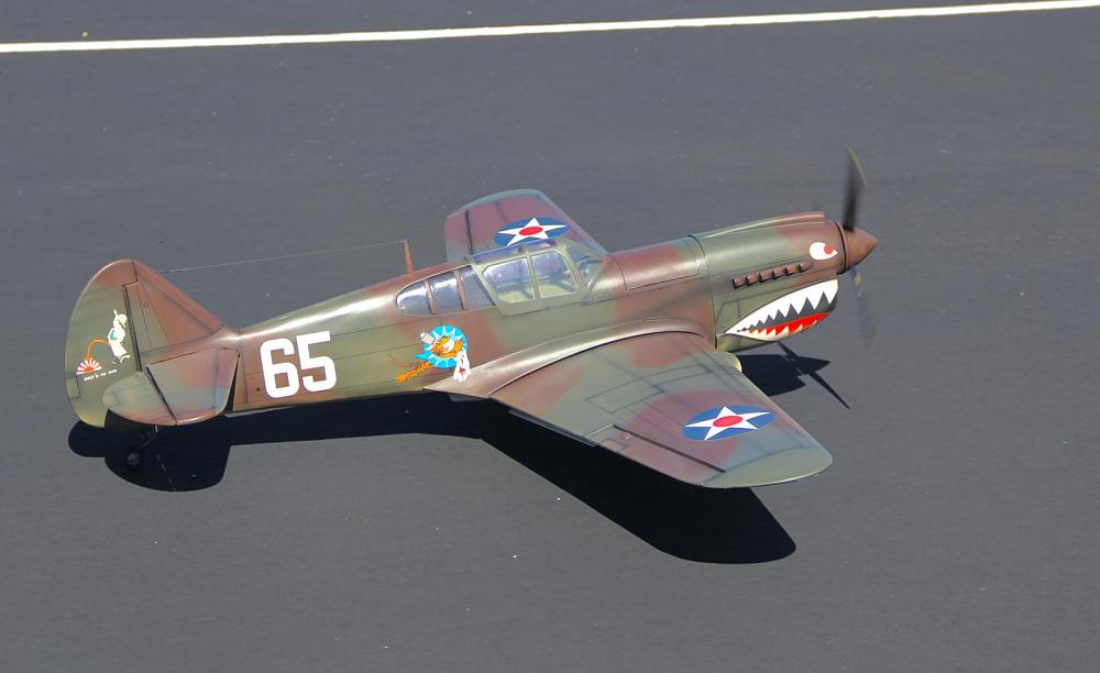

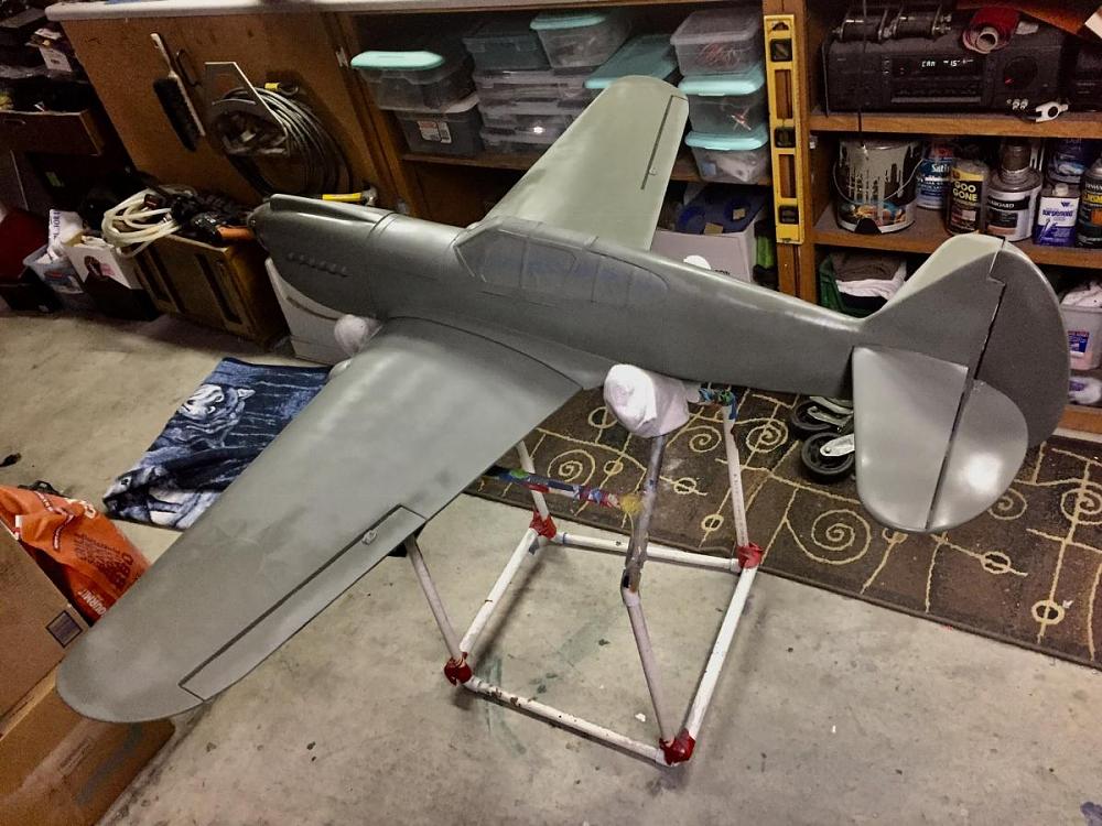

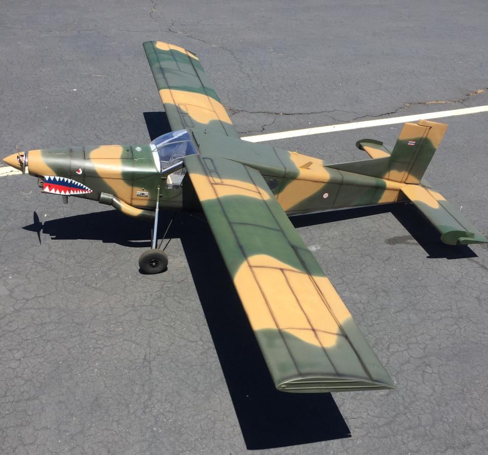

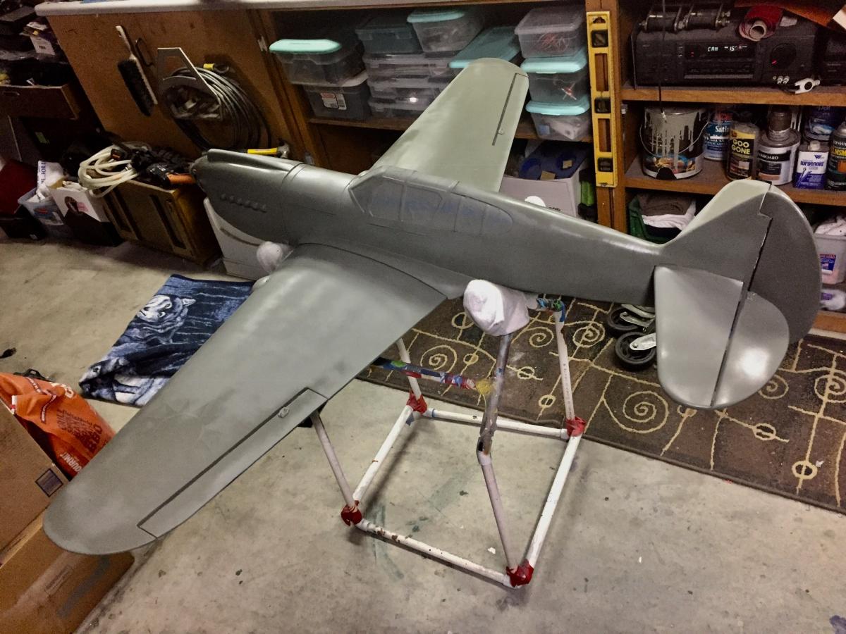

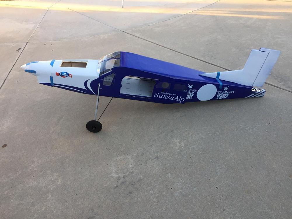

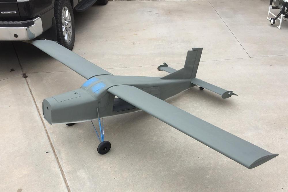

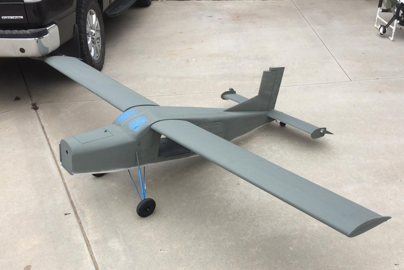

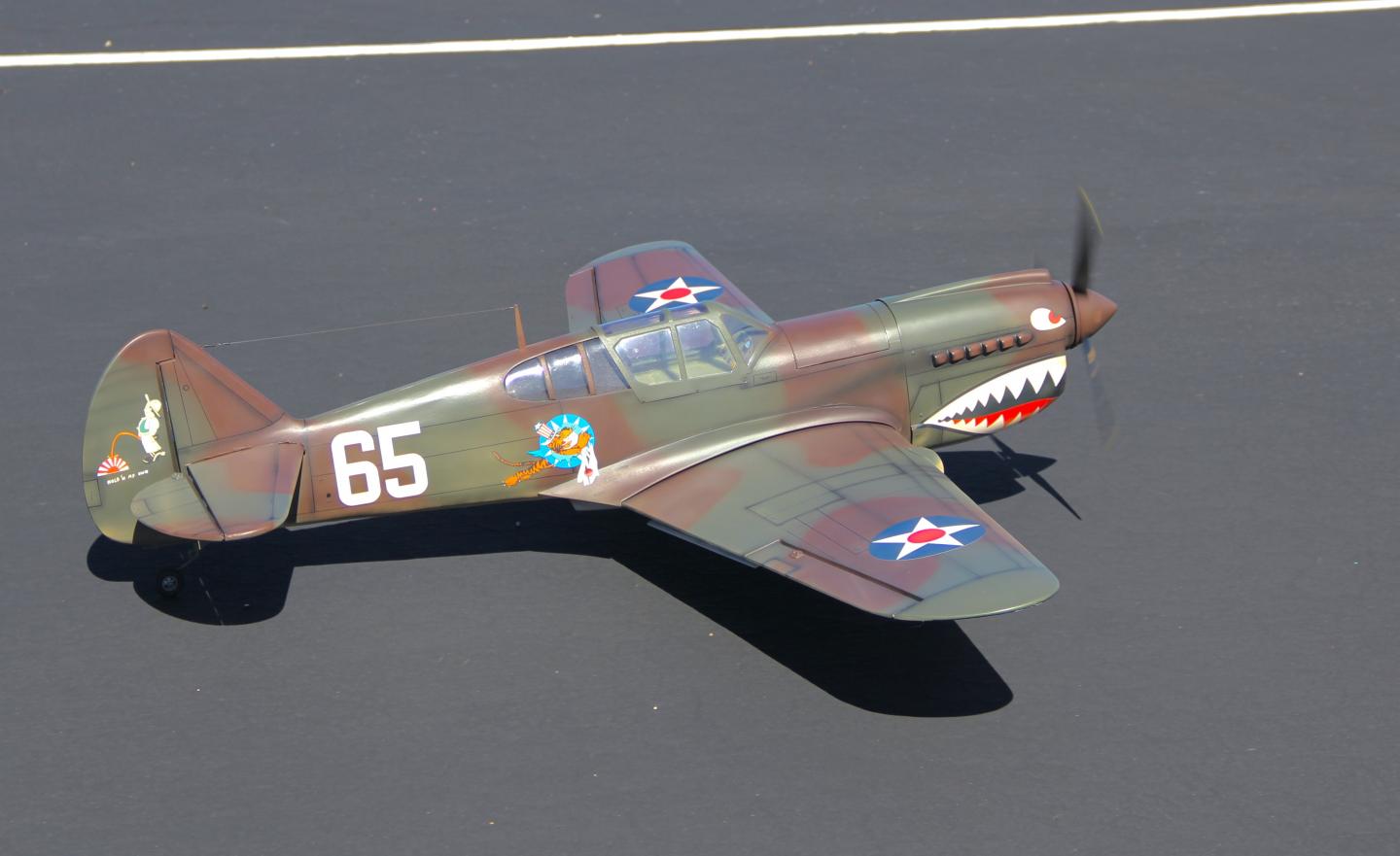

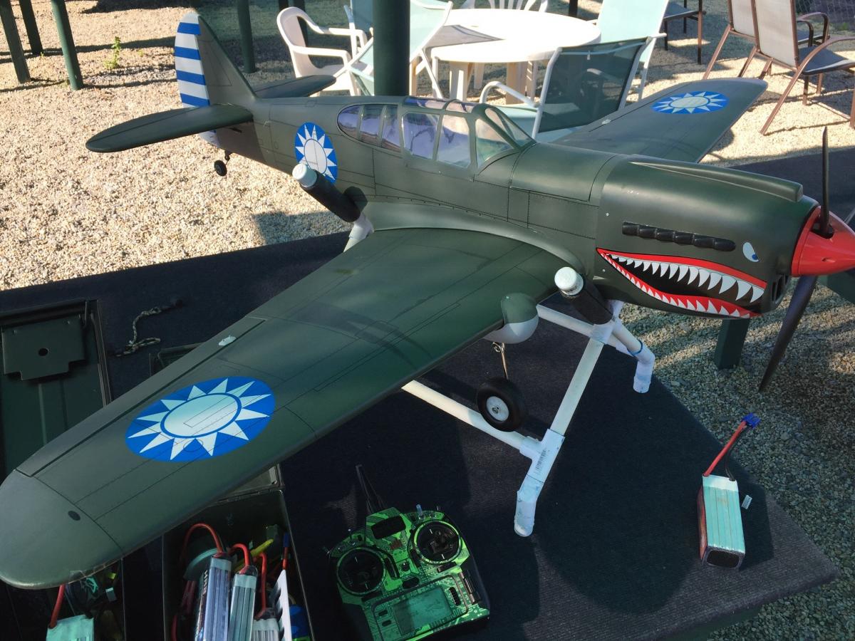

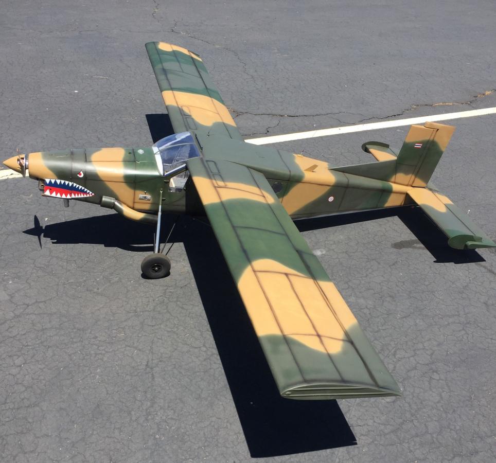

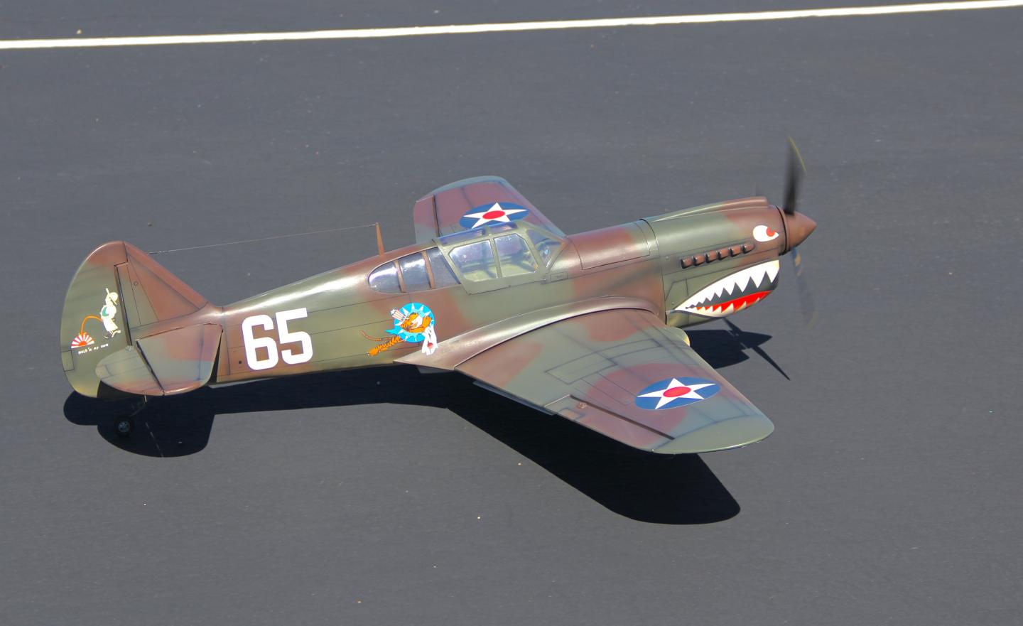

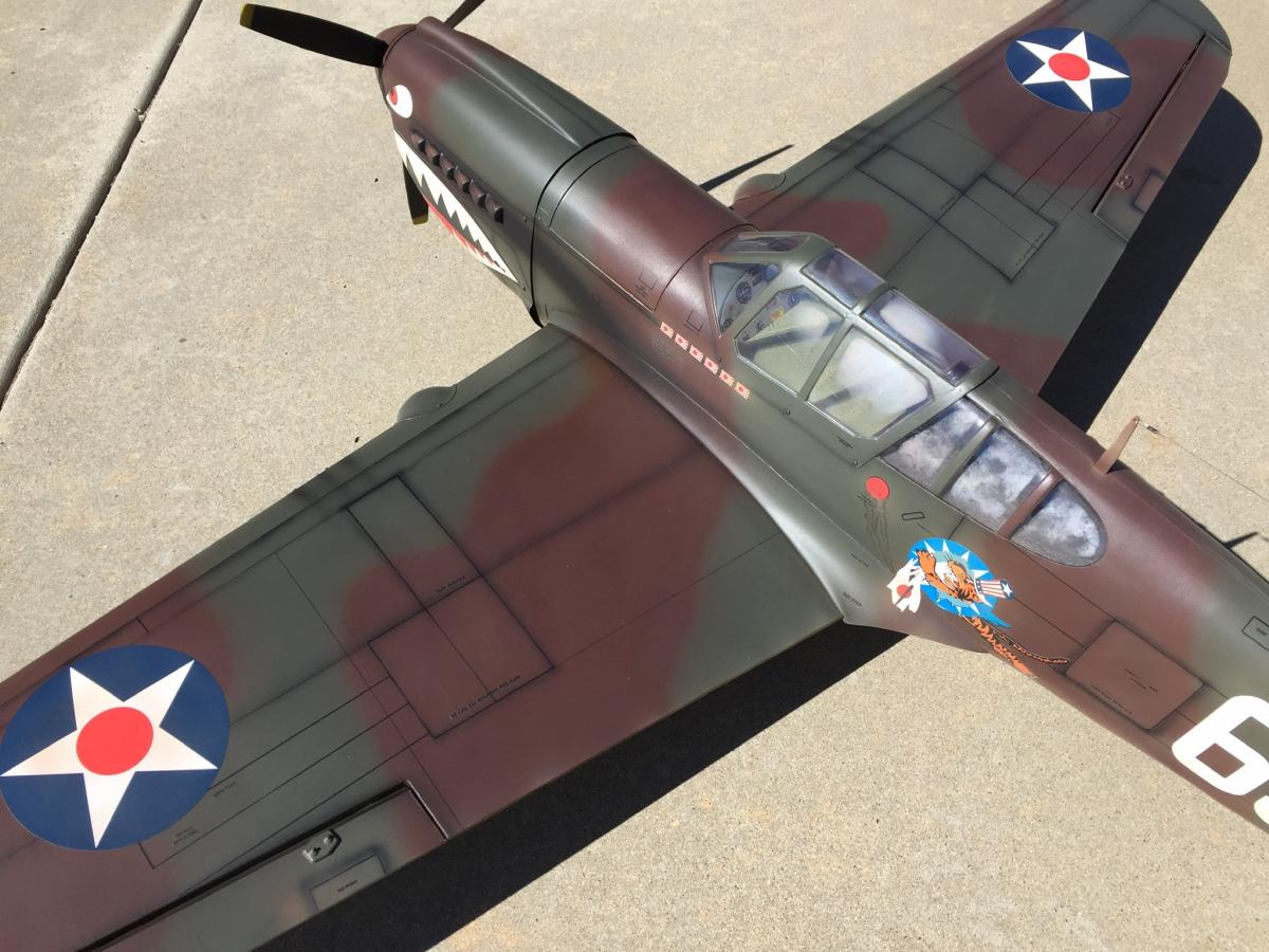

ID:	192491 When I repaint a covered, built up planes: lightly rub 0000 steel wool, self etching primer, airbrush with Tamiya acrylics, coat with Minwax Polycrylic or Testors Dull.
