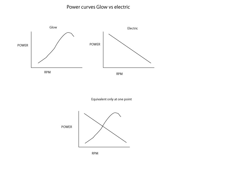

          Care to share why going to electric has been an adventure.
          I came from glow engines (alcohol). I even build my own engines. And I have always found that electrics are much easier, predictable and reliable than glow. Also as a result of the added torque they fly better as they can swing a much more efficient prop than a comparable glow engine.
          I think matching the power curve of a linear electric motor is far easier than trying to match that of a glow engine. The attached chart is trying to show how much different the electric motor is compared to the glow engine. The big thing to notice is the slope of the power curves are reversed between both power sources.

                Electric is cleaner and doesn't require as much field equipment to fly. The other guys in the club give me a lot of bunk about how fuel is a lot less than batteries and they can fly longer and you can get less cycles on a battery because they only get about 100 charges. Funny though the few that talk this trash fly to the point that there batteries are well below 3.7 and so hot you can't touch them. This is just a few who fly just one or two calling them there expendable toys. Not real planes. I like the faster response as well as the predictable nature of electric. A mishap is also a lot easier to repair. After coming back to flying I thought I had completely lost any experience I had gained 20 years prior. Started back with some nitro planes I aquired from the club I joined. One led to another and then one day I had 3 nitros. Went to the hobbyshop one day and bought the corsair with safe. Loved the way it flew and handled. Next got a Dynam Pitts biplane from a friend to try without the ax3 and was hooked on electric since. Although do have gyro in my 1450 airfield corsair. Wanted to put one in a phenix 55"spit fire that I'm putting together. Started out go to put a 55 ax o.s. engine in it but now leaning towards electric setup. Sorry about the book. All I have is an old cat to talk to.
