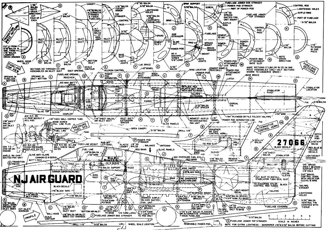

1st choice: F-84 Thunder streak (I have attached the plans, still need landing gear plans).
