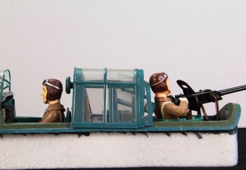

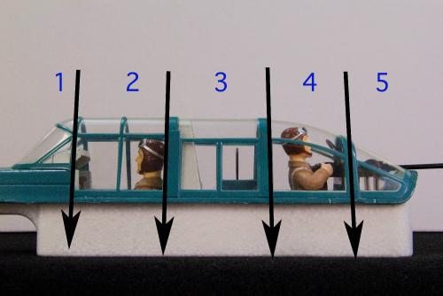

      Ahoy there, the mod on the Dauntless is really easy. I found its a great Idea to have 2 canopies one cut and one stock. Carefully peel the canopy off the hatch. Cut the canopy into 5 pieces using scissors as the picture shows. Section one stays where it is and glue it back down. Stack 5,4,3,2 in the center of the cockpit. Position them where they look good by allowing a slight overlap toward the rear gunner. When your happy with the placement glue the sections down. It looks better and more 3D if you pull the gunner seat section and turn him to the side and reglue him. I painted the inside of the cockpit with flat green Tamiya paint.
