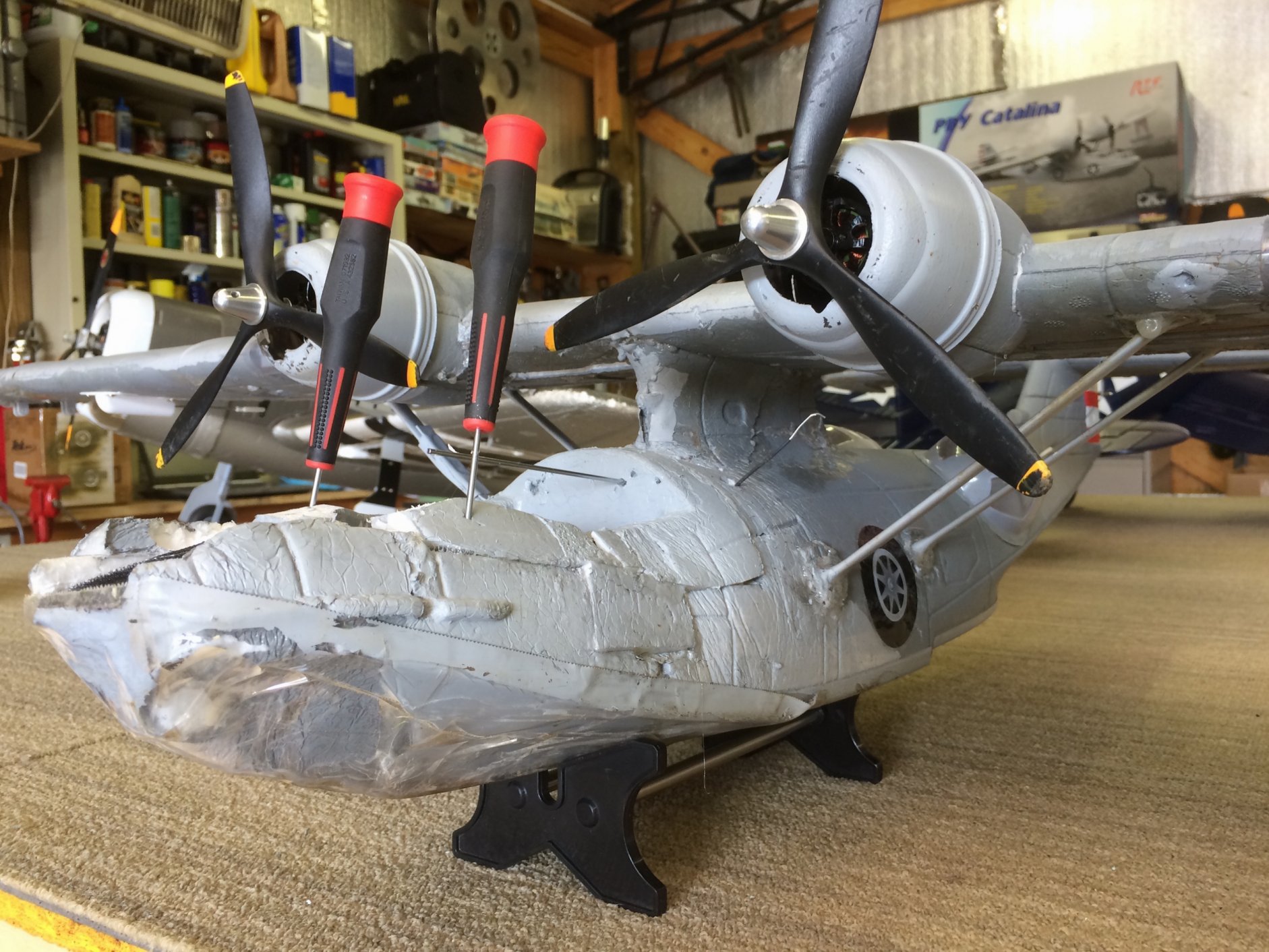

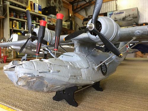

                          Well, the Spitfire's back together and ready to take to the air in just over a day!!
                          The P51 is flight worthy again as well, just needs some cosmetic touch ups, check out the pics.
                          BTW, no spinners were lost during this performance, didn't even break a prop on the Pandora, she still a work in progress.

                                        P-1 is well on her way, replaced the servo as that's the only thing I can see that it could be. I removed the push rod and sprayed some WD40 on it and slid it back in and worked back and forth, no binding there, and the elevator itself is free floating, so it HAS to be the servo, right?
                                        The damage to the leading edge looks pretty good, a bit of sanding left and some work around the front L/G attach point and she should be ready for the air again.
                                        That bird is tough as nails!!
