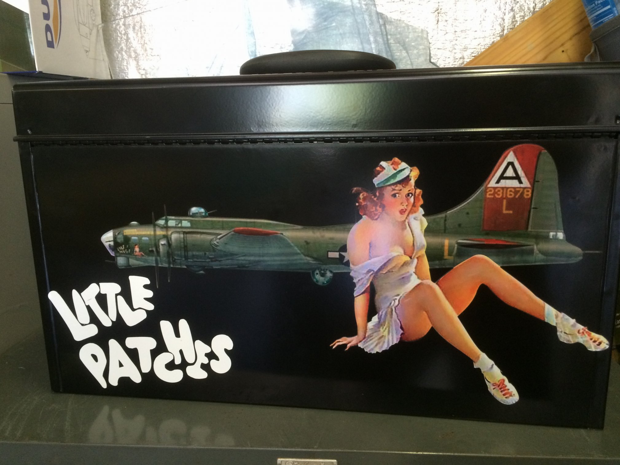

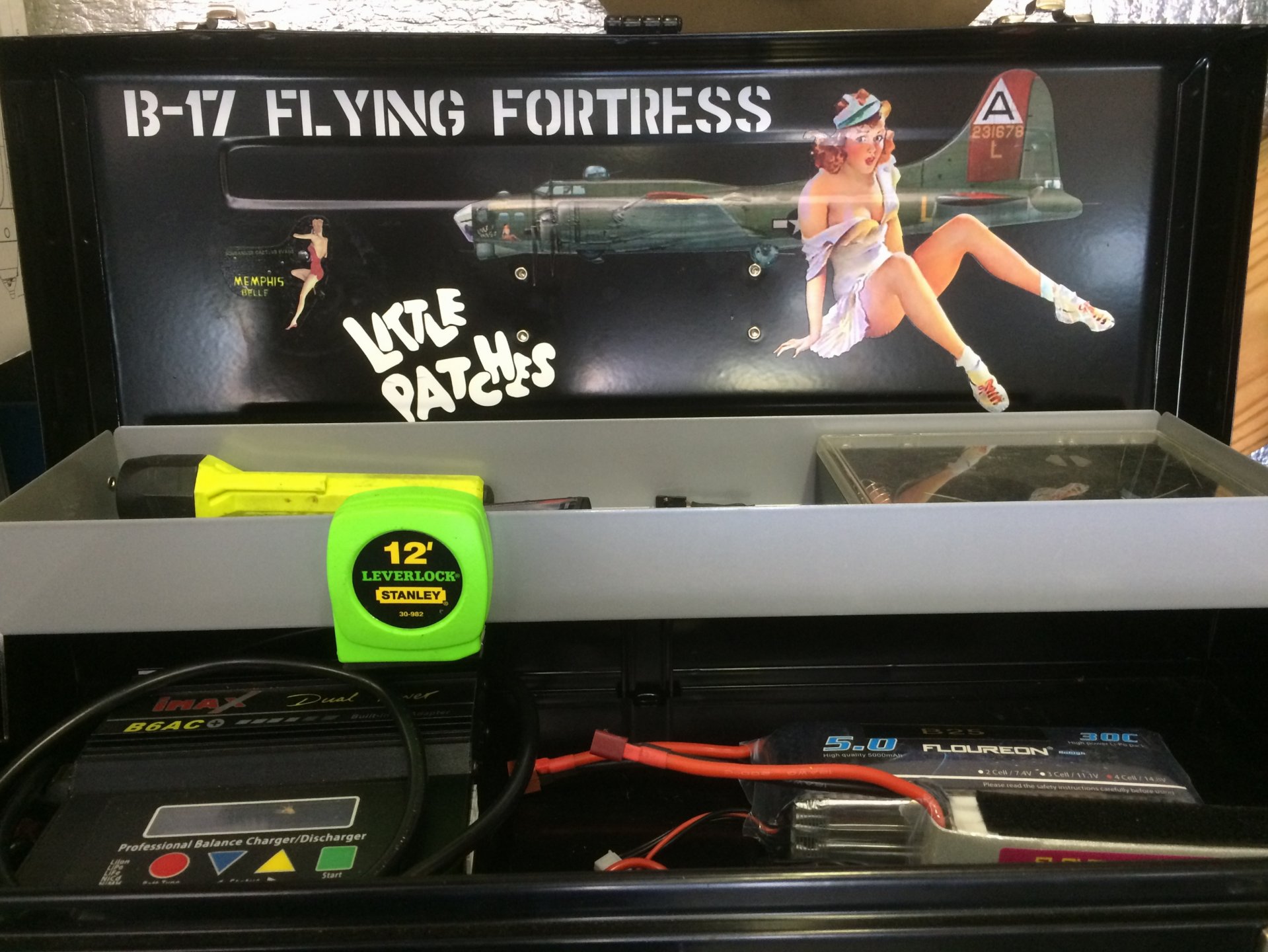

                            She'll make anything you want...she did these for my field box.

                              Very nice TiredIronGRB!
