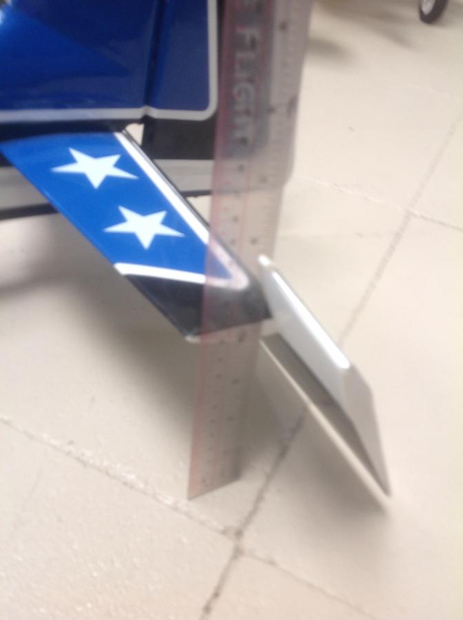

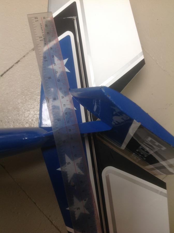

              Here's another post that I was referring to in one of the posts above. I'll see if I can find anymore I think might help.
              Dunno if this will be any use to you, but I know you guys sell some little 3D planes. I was asked how to set up rates on a new 3D bird. The big throws can be a bit challenging for someone new to 3D, so here's how I do it, the idea (as said above), is to be able to flick quickly through a few options on initial flight testing and see what works best for you, and the plane. Obviously you need a radio with a 3 position switch, but good for 3D pilots.
              "Hey mate. Here's a simple easy formula I follow for setting up rates on a new bird. I never follow the manual as I been flying long enough, I know what I like. And I don't know any pro 3D pilot who doesn't go for as much travel as they can get.. lol. I'll fine tune these as I feel necessary after flight testing.
              1. Get as much throw as you can possibly get on all surfaces without binding your servos. Set this as position 3, this will be your MAX rates setting. (Note: especially important you ensure throws are equal in each direction for all surfaces).
              2. Halve this rate. This is your low rates.
              3. Set the high rate as half the distance between low, and max rates.
              It's a easy starting formula, which allows you to fine tune to your personal preferences without much mucking around. Hope it helps mate. :)
              For expo, well expo is a personal preference but generally speaking, the bigger the throw the more expo. On average, I'll be around 15-25 on low, 35-45 on high, and depending on the plane, as much as 65-70% on max rates. Again, expo is purely a personal preference thing, there's no right or wrong. Some people like a sensitive stick, others don't. But some expo will help your control with the bigger throws.
              Note cg is also critical. Ideally, you're looking for hands off sticks straight n level flight both upright and inverted, with as little trim as possible to achieve this.
              Ps: for me, I pretty much just go to max rates, I can't remember the last time I used high or low rates - on any plane for that matter, I'm the same with my warbirds and jets as you know. But I'm used to big throws, I learnt to fly doing 3D. The only thing I'll generally do is tone down the roll rate a little on max rates, as on some of my birds I can hardly keep up, they roll so fast. (They're called rifle rolls for a reason lol). I always set my rudder as far as it can go, (usually till it hits the elevator), and same with elevator as you'll need a big throw for things like ke spins. The pics below are my max rates on elevator on a couple of birds.
              PPS: for you, I'd recommend you start at low rates and get used to the bird. Then when your comfortable, go high and test your other rates. Good luck mate, hope you love it as much as I do. Always happy to help, pm me as you need to buddy. ;)"

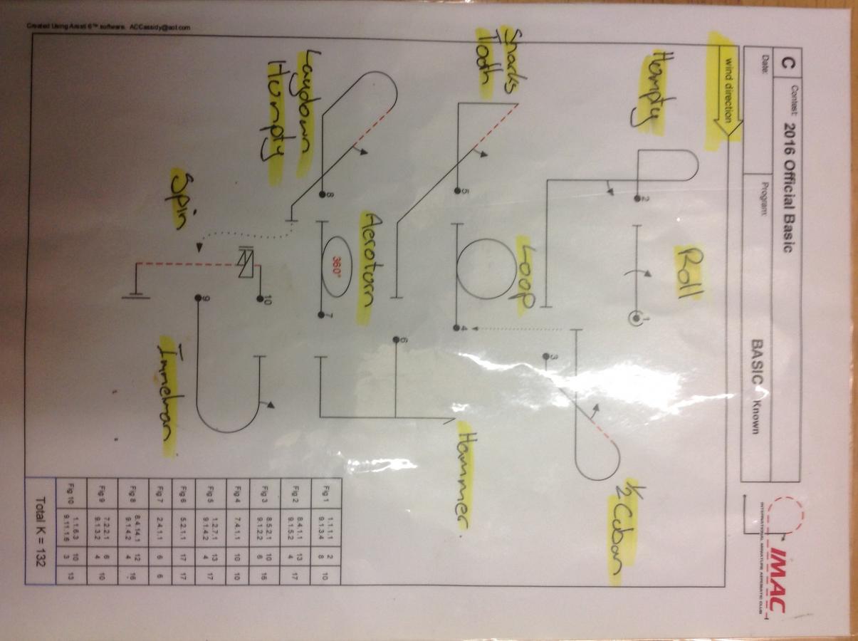

                basic aerobatics: perhaps explain how to do a roll, loop, figure 8, inverted flight, Cuban etc. just the basics. If you download the basic iMac routine and post, it might help to explain the aerobatics with little pics. You're a computer whiz so I'm sure you'll figure it out. Pic attached of the basic entry iMac routine I use when training students for gold wings tests. An Aussie thing, maaa (your AMA), require you to pass a "bronze wings" test, before you can fly solo at a club. It's mainly safety, ie you are not a danger to yourselves or others. There's a small multiple choice written test, and then you do a basic flight test with a maaa instructor like myself. It's very simple. You can take off, land, do a procedure turn at each end of the runway, a outward and inward figure 8 and a deadstick. (Deadstick is done up high, you don't need to actually land, just so we see you have control with no power). That's it. Do those and get your little bronze wings badge (you get a little maaa badge which is sort of cool, students really feel a sense of accomplishment - pic attached), and can fly solo. Then later as your skills progress, you can do silver wings, and then gold wings. (Gold is the minimum standard for flying in public displays etc). Then you can go on an train to be a instructor etc. Anyway, point being, basic aerobatics teach good control of the aircraft, so maybe a few of these. Later on if you're stuck for new subjects you could go on to explain some more advanced aerobatic manouvers.

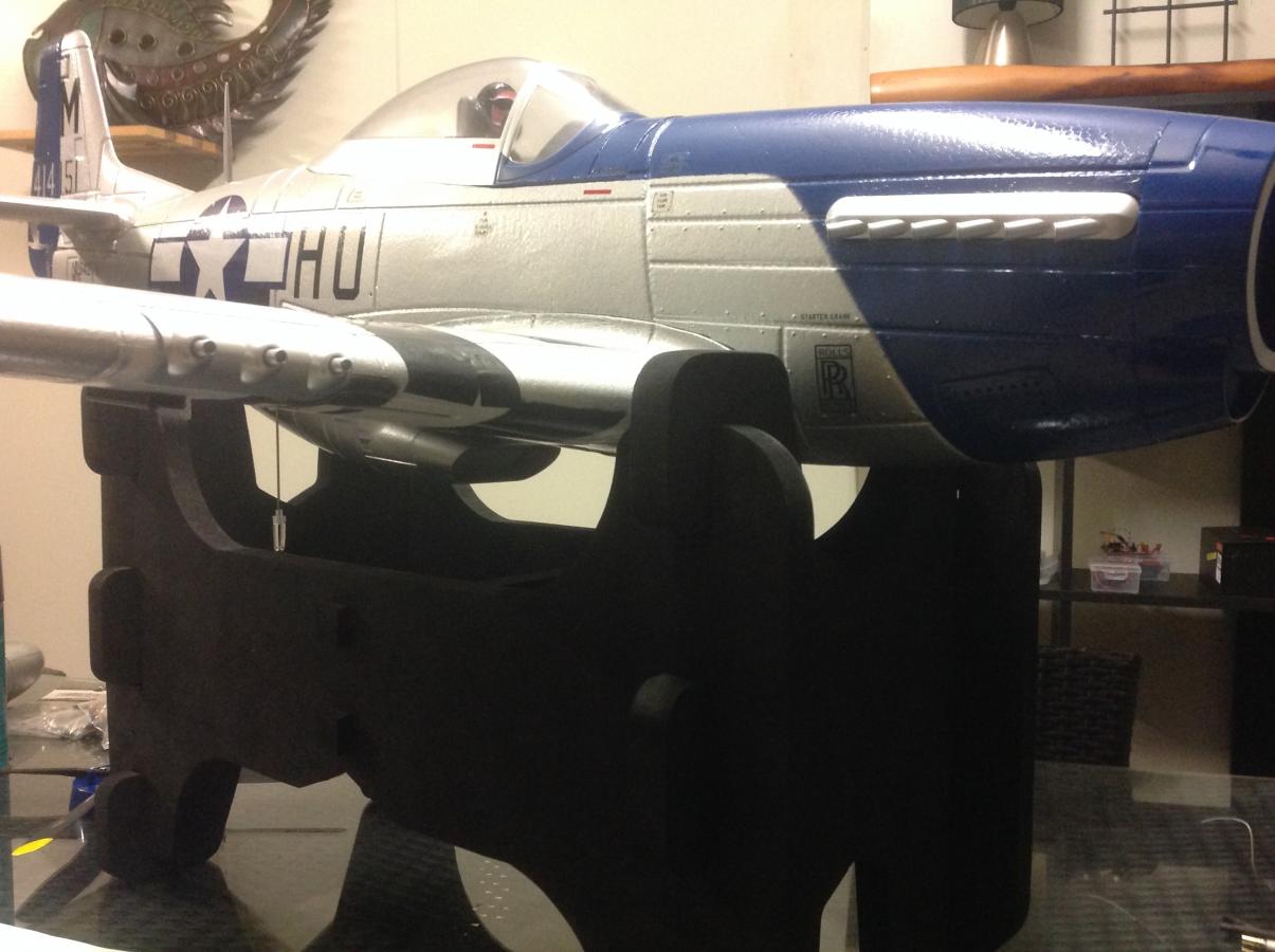

                Maybe a bit on good tools or bits of kit like described above (ir checker, plane holders etc), especially good if you stock those items. ;) Now you guys are selling the bigger stuff, wing bags etc since a lot seem to be looking at them for the first time and a lot of interest in the a10 thread.

                  Forgot the pics... duh. Ps: I'm sure you know this, but pics and diagrams hold people's attention from a training perspective, same concept you guys use in your sales and marketing. So pics of your subjects like battery checkers and so on. (Sorry, don't mean to come across as telling you how to do your job, just trying to help. Apart from running my own companies, I also teach business owners how to run a business and sales marketing stuff.. sorry if I come across a little bossy lol ). :-S
