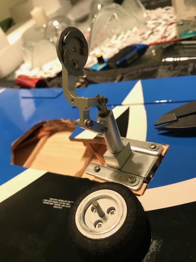

    Good evening friends,
    I want know please if someone already saw this type of landing gears and how can i change the tires (or al the wheel) on it.
    The rubber (or EVA) is already very used as you guys can see on the images...honestly i do not have any idea how to change the wheels (45mm)...i can't see any visibale screw, just some pin as the axle.
    Below is the link wich seems the same model.
    Thank you all! Safe flights!
    Hello Raphael,
    Your picture #1 shows the bottom of the strut with a hole that looks to be threaded and most likely has a set screw up in there locking the axle pin into the strut.
    Those set screws usually are turned with a 2.5mm allen(hexagonal) wrench.
      OV10,
      Yes, it makes sence...seems to have something inside...you´re right.

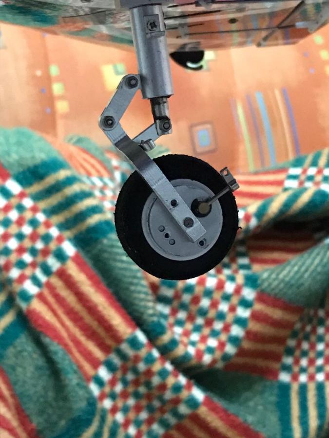

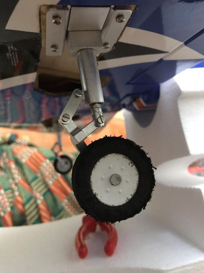

      For the nose wheel is a little bit different, i didn´t saw this hole in the strut..i´ll try to take a picture and post.

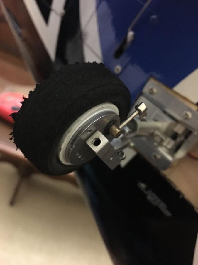

          I think your C47 don´t use the same landing gear than my jet..in my case (as per above images) the axle is aluminum (seems) so i´ll need to figure out how to do it.
          The wing LG´s seems to have a screw as OV10 mentioned but for the nose wheel is a different history....."Chinese design as usual":Angry:LOL

            Thank you all that helped me on the landing gears change!
            As per our buddy OV10 said, the screws was there !
