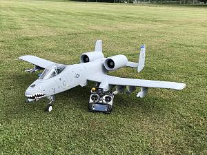

    What's best to use to keep my A10 not looking like a foam model after sitting in the sun? I already noticed it getting that alligator skin type of look?

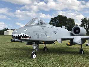

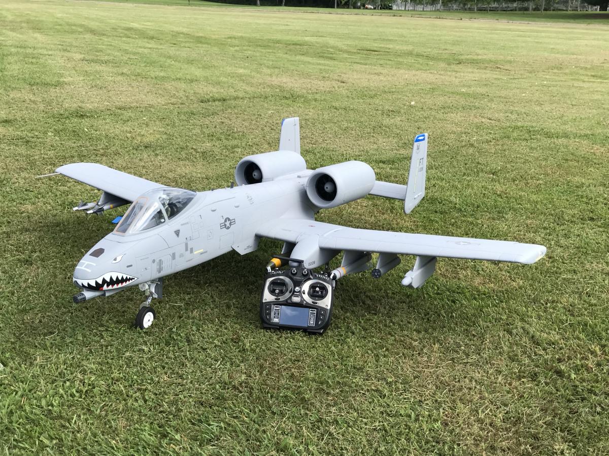

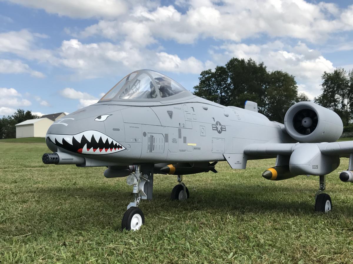

      Just love the realism of this A-10! Great job Motion RC!
