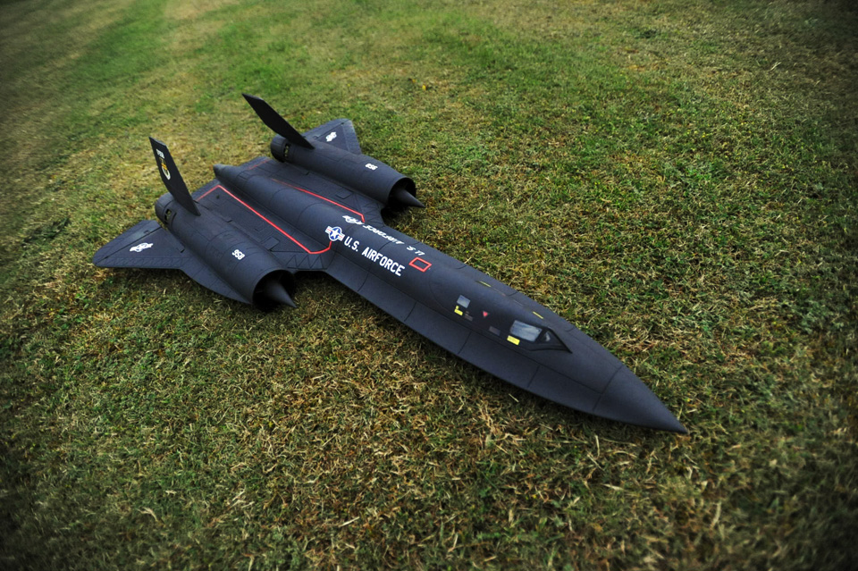

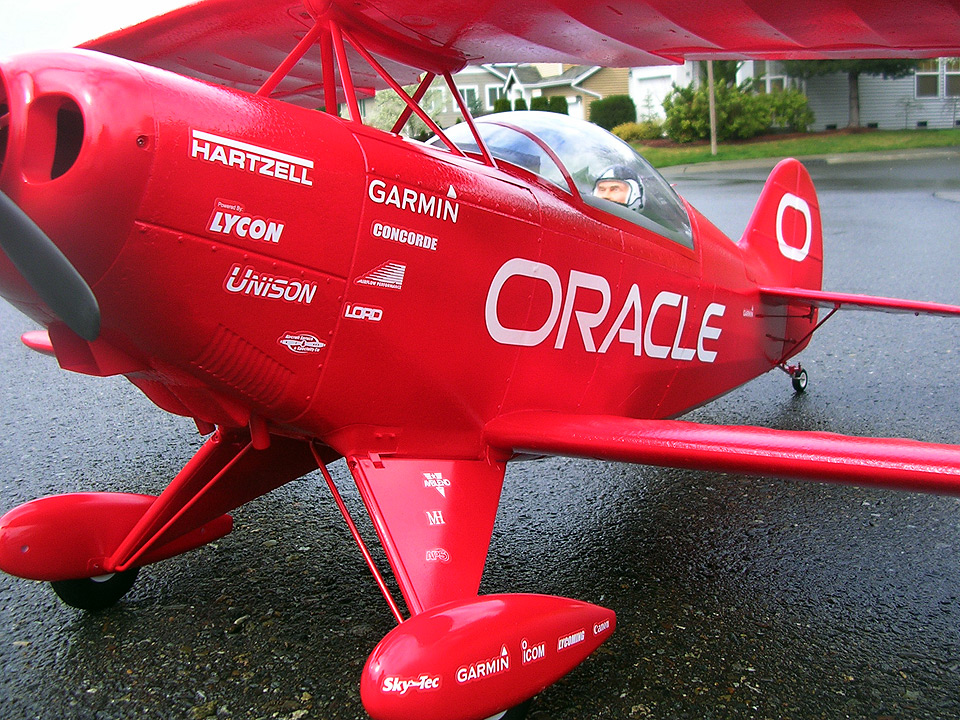

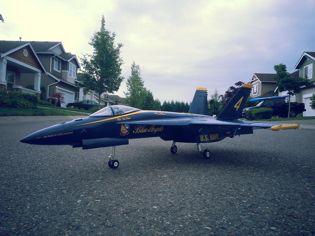

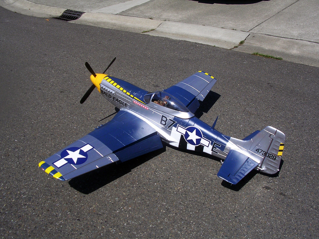

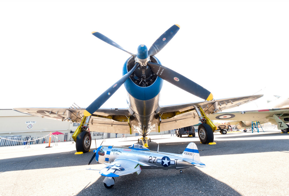

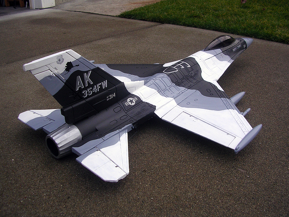

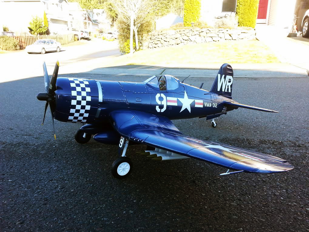

          I second Callie Graphics.  Been using her for all of my custom livery projects for many years.  Vinyl decals, good quality, fair price and decent turnaround time.
          http://www.callie-graphics.com/
          Here's just a few samples of planes I have custom painted over the years and had Callie send me decals for...

              Splendid collection "Aros". Amazing color combinations. keep it up.

                  WOW ,great collection.

                    Love this thread! Thanks for all the great info! And Aros, great stuff! Love your fleet!

                              Hi, can you tell me what type of paint you used to paint your jets.
                              I own the Freewing F-22 Raptor " http://www.motionrc.com/freewing-f-2...m-edf-jet-pnp/
                              " and the Freewing F-18 " http://www.motionrc.com/freewing-f-a...yal-maces-pnp/ "
                              Both are made of EPO Foam.
                              Thanks L.E

                                  Thanks for the info. Want to get that Blue Angle look on my 18.
                                    #18
                                    For most of my warbirds I used to use enamel like Testor's or Model Makers rattle cans...But they are so expensive for the amount you get so I started going to the hardware store and buying my enamels in the spray cans almost three times the size, at a fraction of the price of Testor's/MM small cans.
                                    I can't recall the exact brand that I used for the Blue Angel and Corsair but it was the darkest navy blue gloss I could find.
                                    Important Note: While you can use enamel on EPP/EPO foam, it's absolutely vital that you spray several LIGHT coats to build up the base before spraying more liberally. If you start out heavy, it could eat some of the foam (especially the Freewing F-18 which is EPP and more sensitive to enamel), but this has only been an issue if I sprayed too thick of coats initially. All-in-all I've never had an issue using enamel on my airplanes for the most part. The end result can be absolutely transformative.
